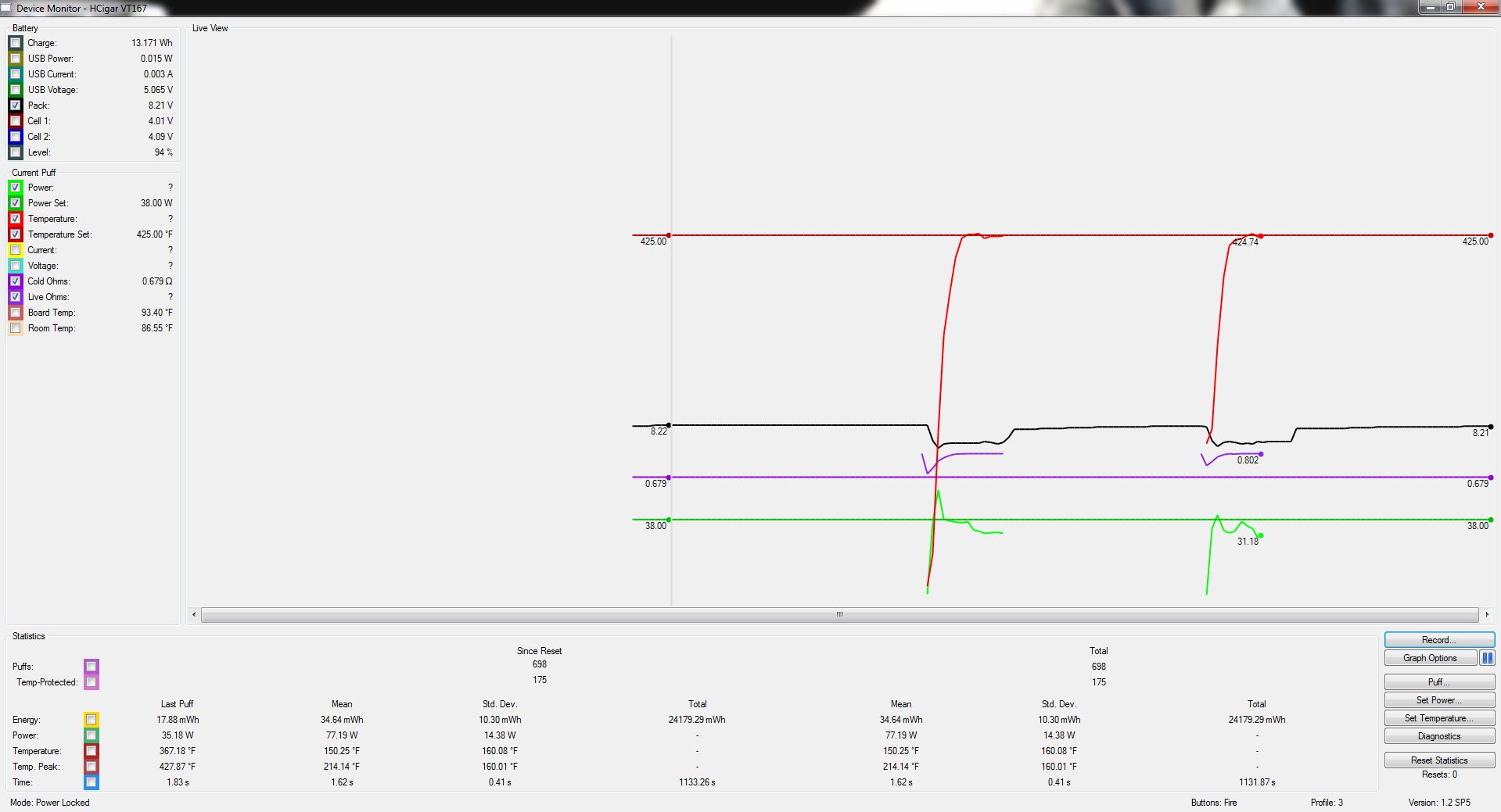

  3. I'm sorry Sir about not telling you about the change in power, I assumed that I had to change the wattage from using a round wire to a fused clapton. I didn't make the wire, I bought it from here. I thank you for your patience. I'm a beginner vaper of roughly 2 months and I just want to get the best experience from vaping. I tried another wire with 2 cores, at first the vape was hot yet the temperature doesn't reach the set temperature. I removed the wick and I pulsed it red to check. Then rewicked it. I've been doing round wires without pulsing them without problems. I should maybe dry fire the fused claptons? But they said not to dry fire SS316L. I have this screenshot after I had rested the coil for a few minutes and locked the resistance, I also changed the Temperature and the wattage.
