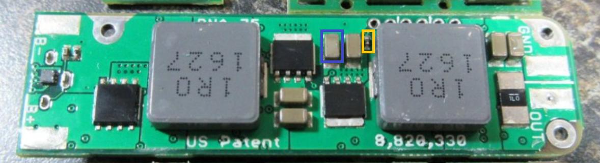

Everything posted by tianz
  1. it look like the shorted capacitor, try to change the capacitor first. your resistor look fine
  2. Already fix the problem. I put 10K resistor on yellow marked and work just fine. Thank you
