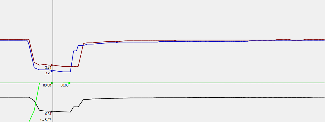

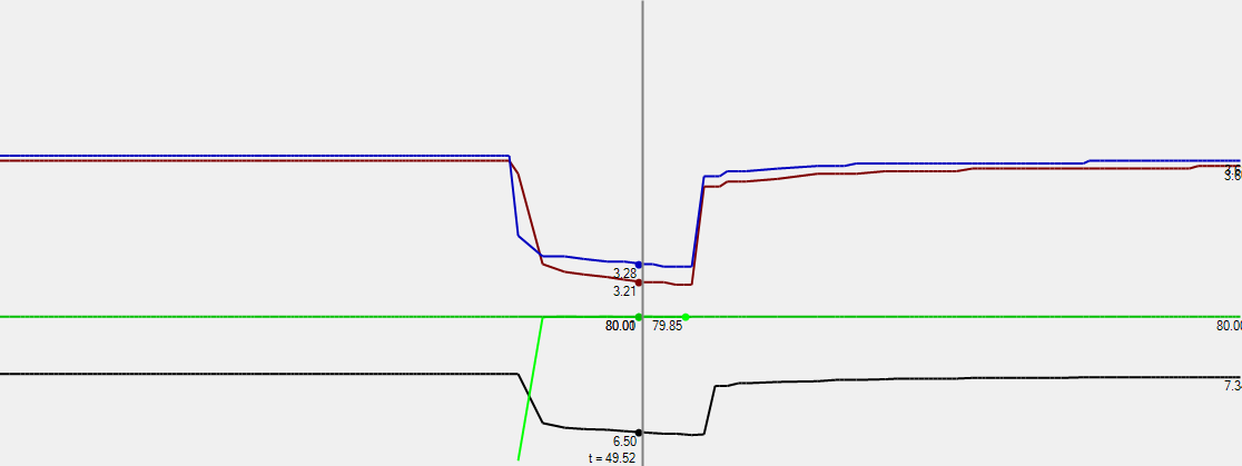

    again so I saved the graph but it wouldn't show the side bar if this is needed let me know please pic 1 batteries set pic 2 batteries reversed

    So pic 1 is at idle pic 2 is after hit which shows battery sagging, but this is at battery life at 59% the flashing bar happenes at 50% and under then when I take the batteries out and reinstall they read 20% or less after just reading 45-50%
