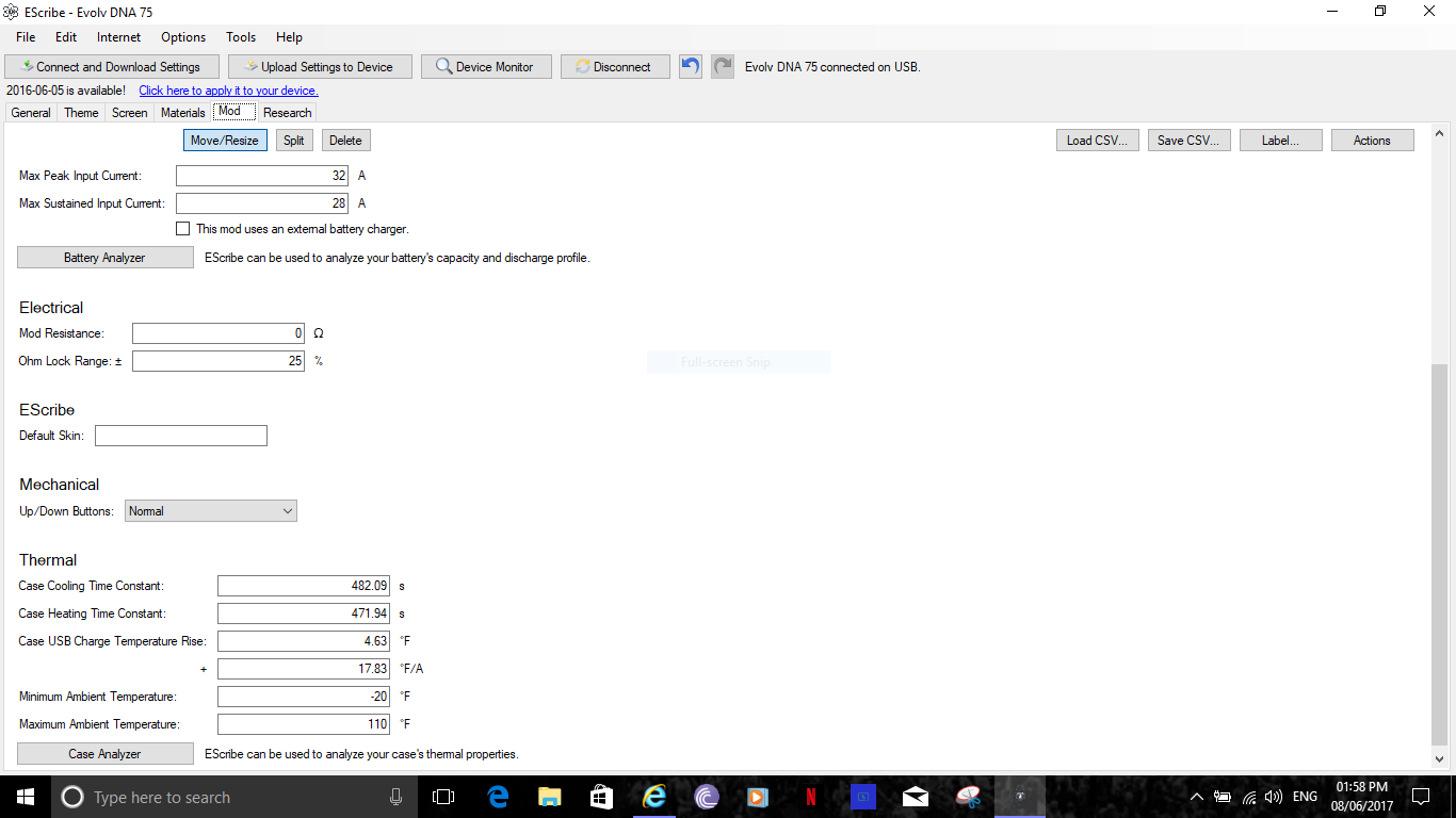

  2. yeah ive just double checked, so basically my settings are fine?? a flat battery is flat so learly a connection problem as u say. obviously I'm gonna have to send it back to the vendor which is what I wanted to avoid

  6. first photo was taken immediately, the 2nd less than a minute later

  9. ok I can do that but I'm new to this so I wouldn't know if it reads it correct or not.....I did notice last night it said o.23v
