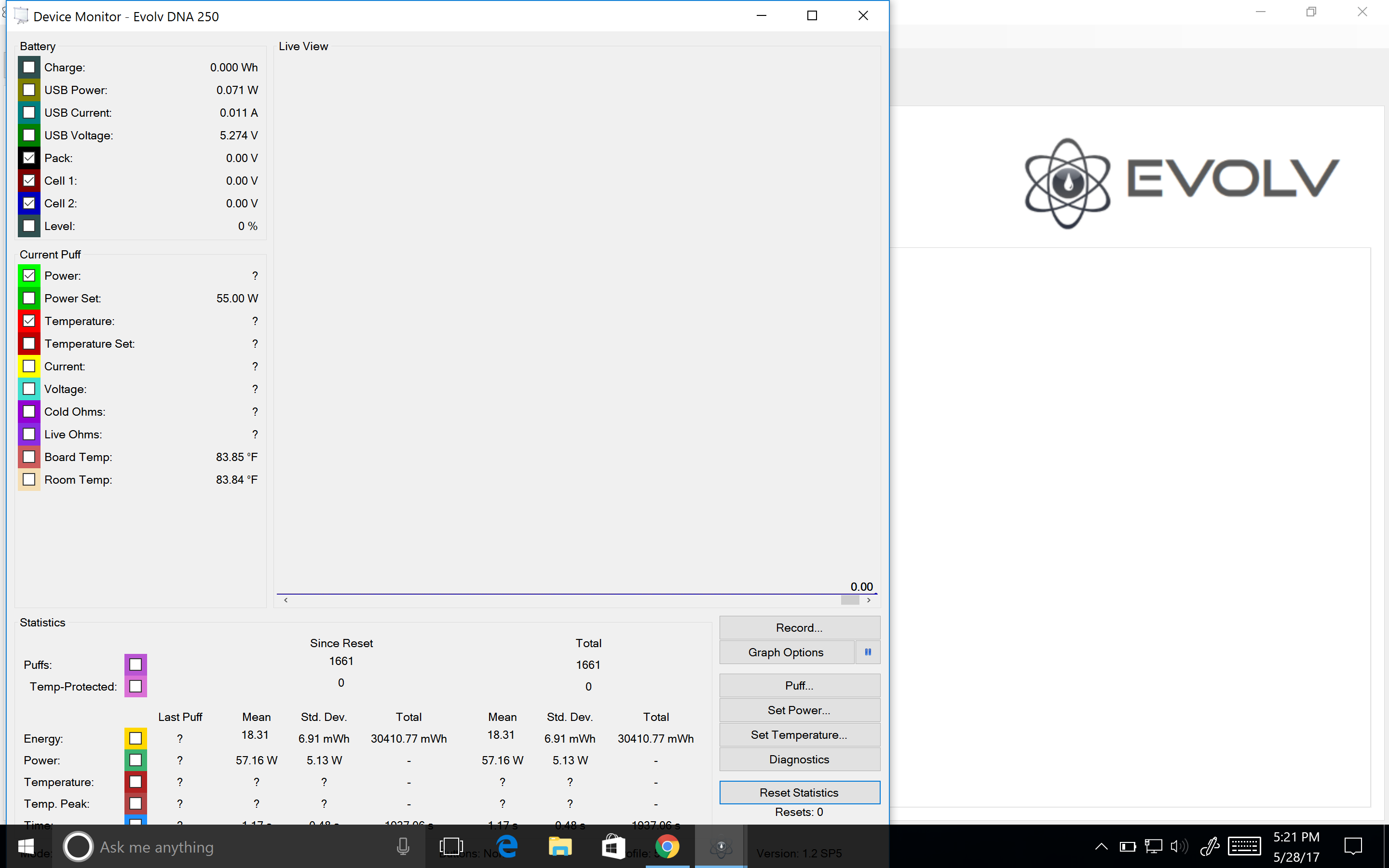

  1. Only problem is that I don't have an ohm meter and don't easily have access to one
  2. is there any way to check that without taking it apart?
  3. I have tried both pairs of batteries, and both pairs have worked in the past
  4. Now that I come to think of it, yeah it hasn't worked since I swapped batteries
  5. They all say 0.00 V
