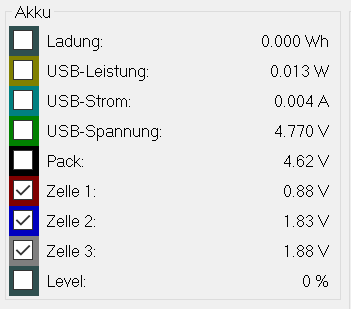

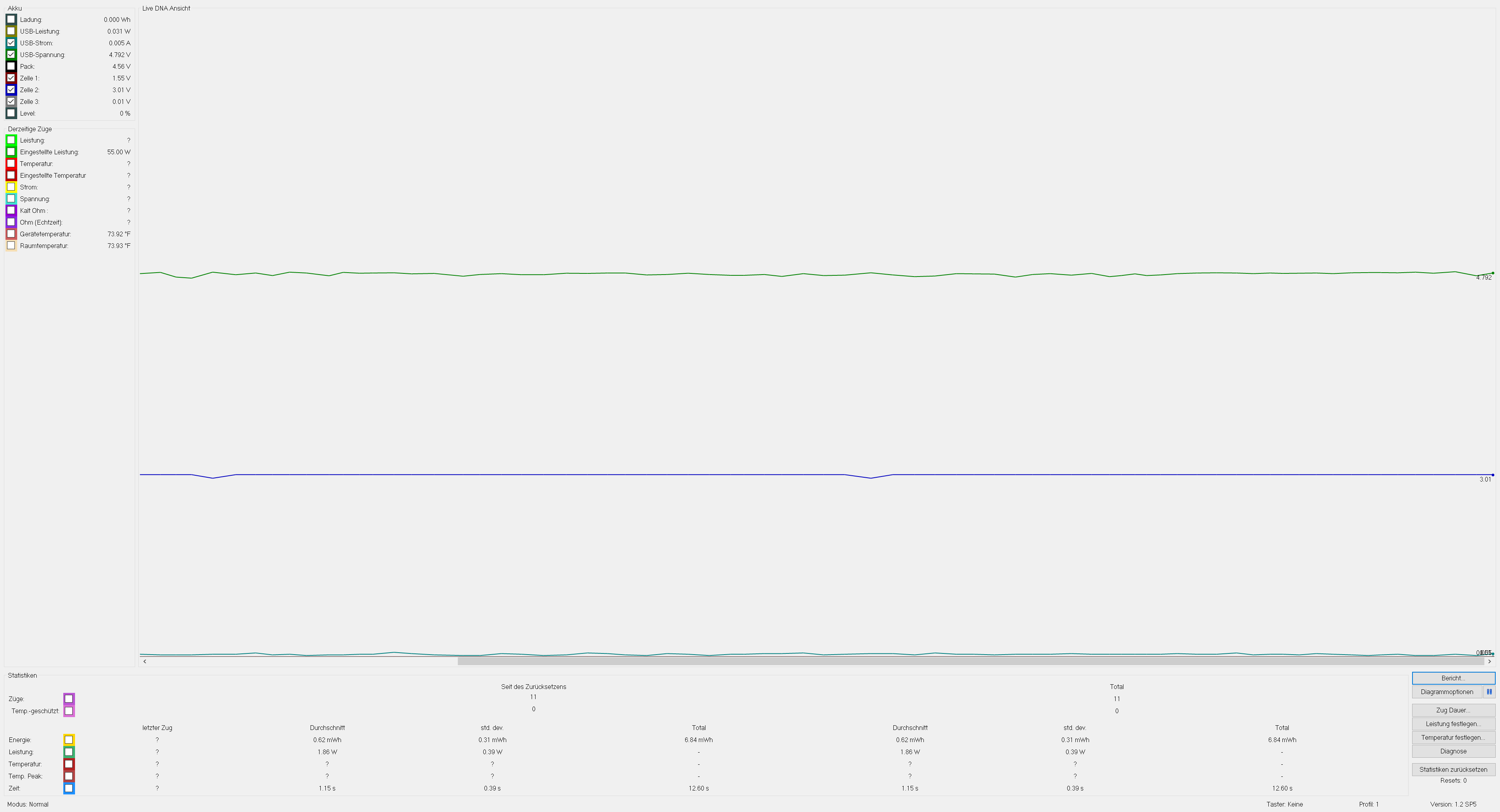

  4. One picture shows the monitoring while doing the recovery charging. The other one shows the "Mod" tab.
  5. Have been trying this until now. The stats have not changed yet. Is returning it to the vendor or replacing the pack the only opportunity or is there any other option or setting? Btw its working in Power supply Mode but still cant be Charged and its giving only a few Watts.
  6. Thank you for your fast answer. How can I notice if the USB Recovery Charging is working or still going on?
  7. Hello guys, I just got my Hotcig DX200 (V1) yesterday and it won't charge via USB. Btw should I setup this Mod for 2 of 3 cells? The USB current is also extremely low (~0.005A) and yesterday the cell voltages were like in the picture below. Today the cell 1 is reading at 1.4V and the cell 2 at 3.0V. The cell 3 is reading at 0.01V. I've installed the newest Service pack and tried the USB Revolver Charge option and several Hard and soft resets but nothing helped. Hope someone of you can help me.
