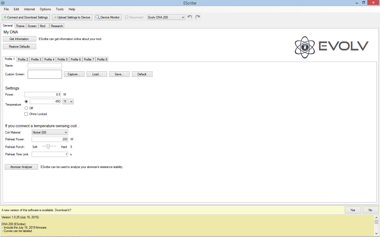

  8. I downloaded what was linked on this thread: /topic/65933-topic/ Unfortunately it does the same thing. The screen pops up and then the little windows cirlcle sits and spins. I am hoping that this is the same version and does not have the time out. Keep in mind -- I do have connection. The proxies are just not allowing the two way. I am not sure if that matters with how you have it coded. But still no worky at this time.

  11. No -- No scrolls from left to right. I have attached a snipping of the screen for your review. Looks normal except unable to use anything. I hope the above helps.

  14. If it is server dependent, that could be the issue. I have proxies up. On launch it pulls the notice of a new version available. But the little circle just sits and spins. <-- Lack of a better word.
  15. Hello everyone. I was trying to download and install the eScribe software and it keeps locking up on my Win8.1 machine. So -- Sadly I have not been able to even attempt any tweaks. Is their any known software that conflicts with Escribe?
