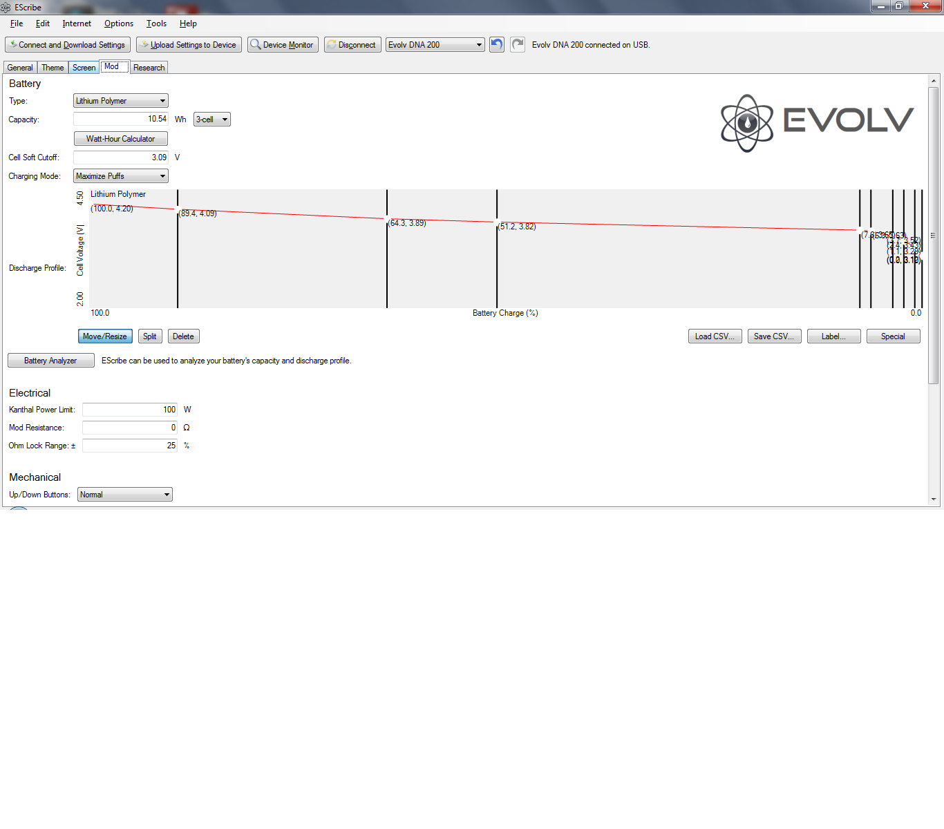

  9. attached are settings dna200.zip
  10. it also gave me a weak battery message at 10.9 volts.
  11. ok so i just let it charge overnight and the battery indicator and volts seemed to match up. But I noticed that the battery didn't last as long compared to previous session. Anybody know what I can do to fix this? Thanks
  12. When I checked the battery on escribe all 3 cells were balanced and fully charged.
