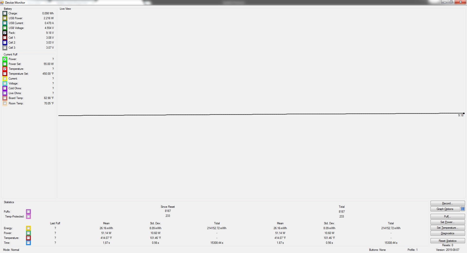

  5. Here we go! Seems the USB problem has fixed itself, but still got box issues.
  6. UPDATE: Box does not charge any more...well...it does, but at .09Amps as opposed to the .97A that it used to charge at.
