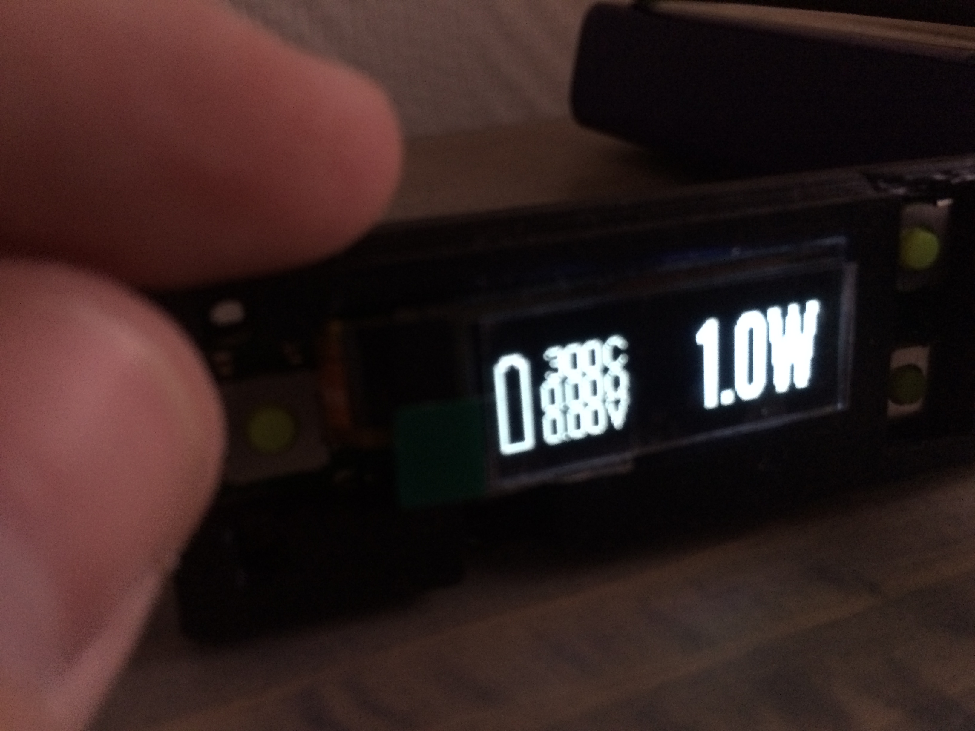

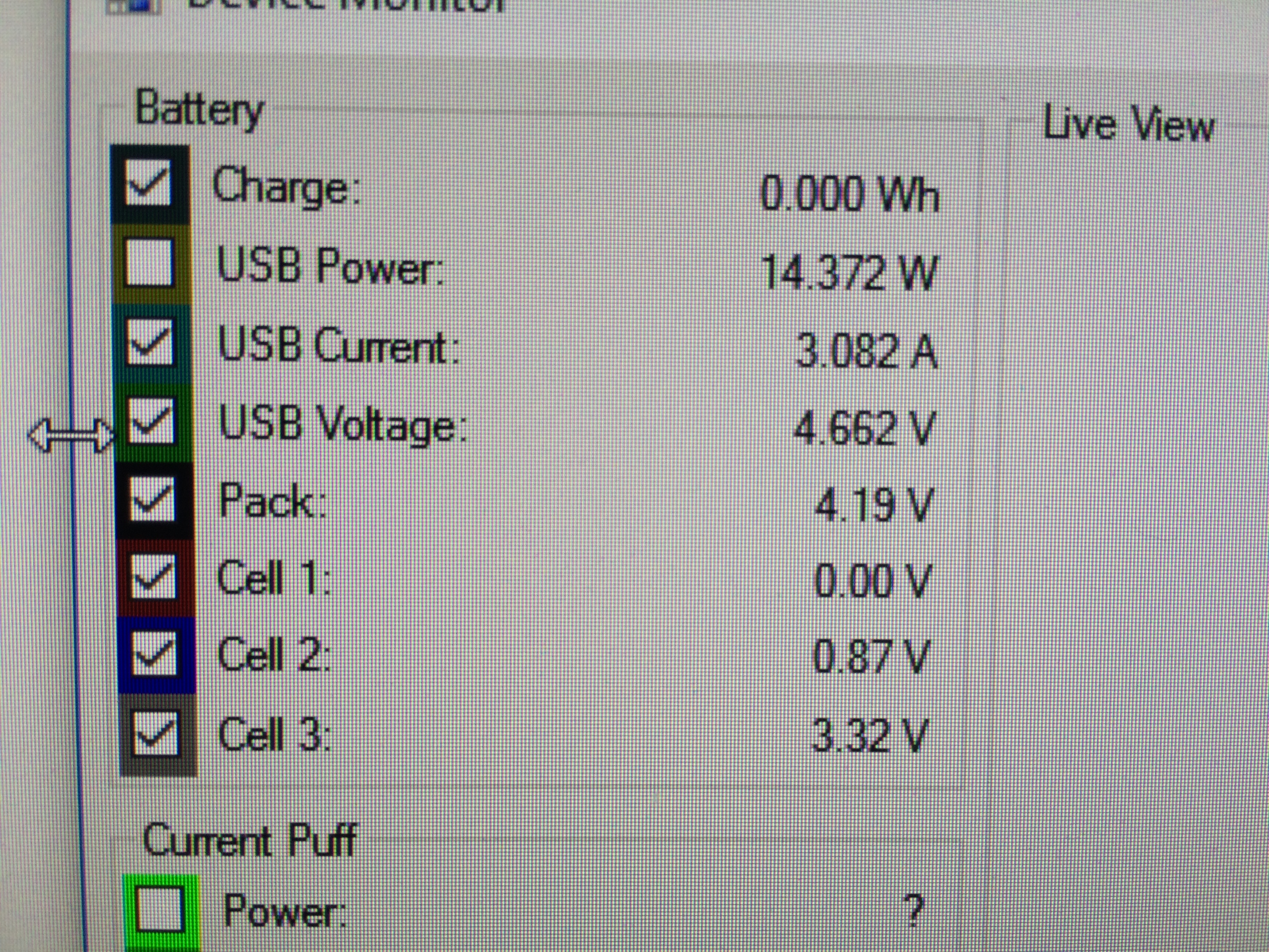

Finally got my dna200 board in yesterday. Soldered a brand new lipo pack (turnigy 3S 1500mah) on it. Loaded up escribe and connected... everything was ok! cell voltages all the same 3.84v  today i grabbed my little project. my screen wouldn't light up any more (just for a few tenths of a second. Loaded up escribe again. The voltages are either zero or are dancing around. The screen doens't sy imbalanced battery or whatsoever.  Since standard practice is to send some data here it is (including video)...  [video]https://youtu.be/wU1Qgf_-WWA[/video]
