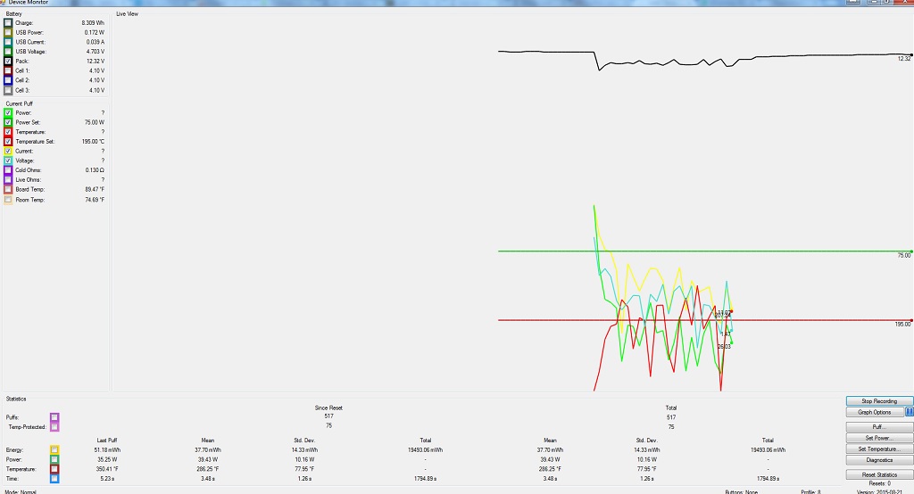

Everything posted by firemanjim
  1. Sorry for double post but after posting this went back and had a puff - back to erratic behaviour - nothing has changed other than a minute or so of time and here is what I now get - virtually no vape...

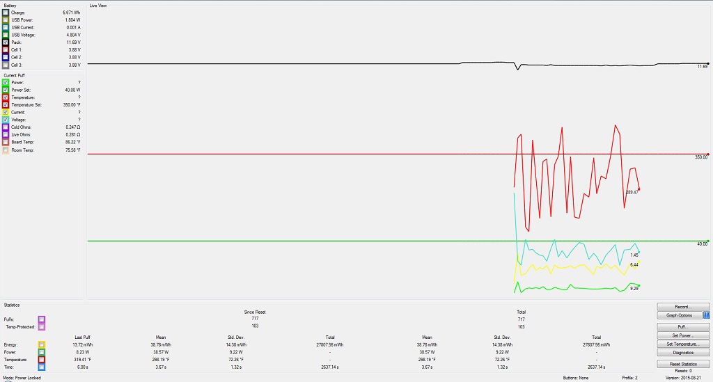

  2. Thanks for the replies and the assistance! I changed to F, used the settings as mentioned by seankwong and then tweaked them a little and it does seem less erratic - maybe there is an issue with Celsius? Does this graph seem more normal?
