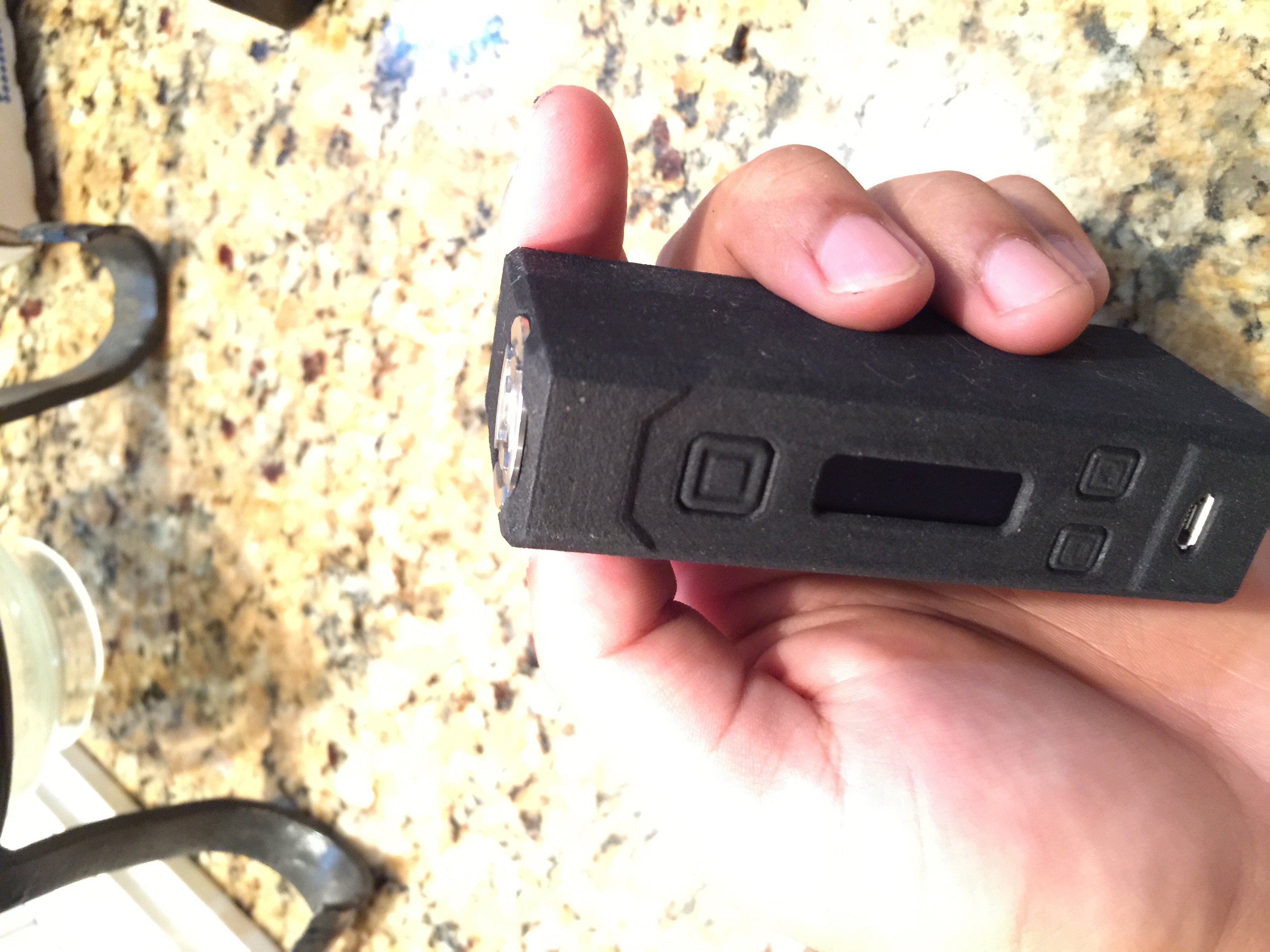

  3. What battery should I use in the solid works "shapeways" DNA200 case? Is it the same one on the evolve website?
  4. Yes correct. It even walks your through it. Just put in the Milliamps and 11.1 for a 3S lipo. Can you change the charge rate?
  5. So I've had my Hana v200 for about 3 days. Everything seems to be working good. The only thing I changed was under battery type in escribe I put in the correct type of WH for battery capacity. Let's hope they've fixed everything.

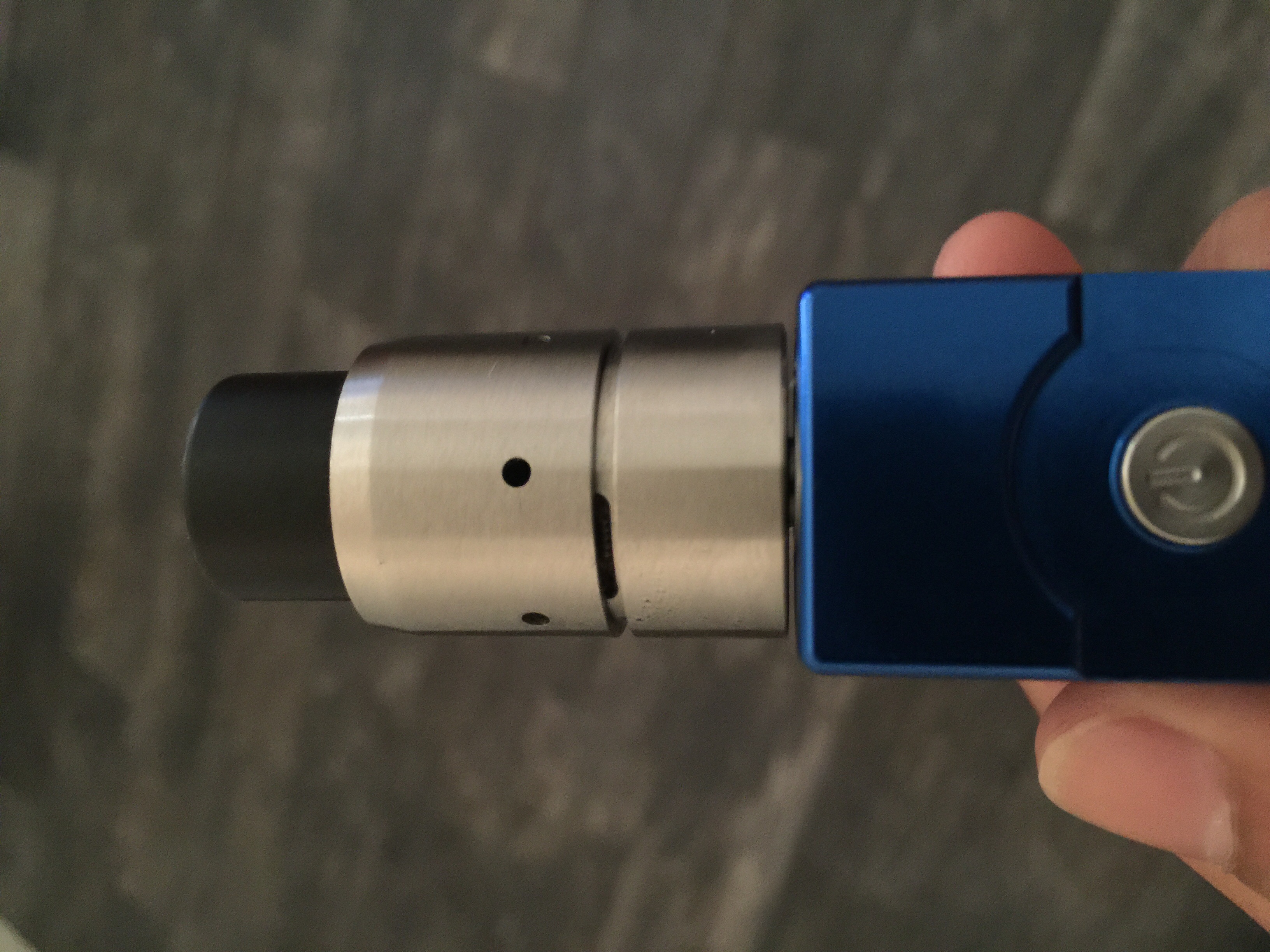

  12. John was right! Like always(; lol. Went into Escribe and turned temperature protected to "do not show" in the themes tab. Thank you John!
