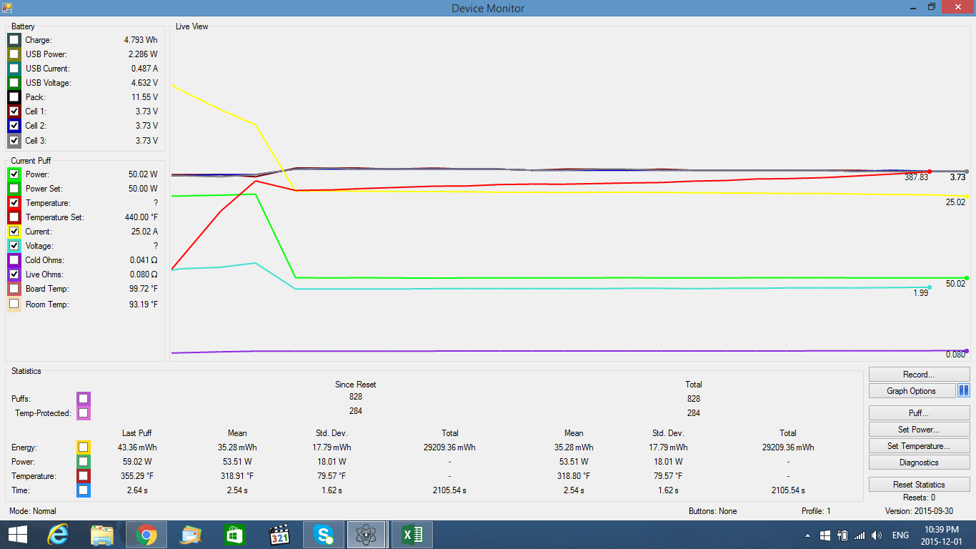

you used 30g instead of 32 by accident. i recreated the "correct" coil and the resistance in the calc was off by 0.04ish which is a lot i feel. i loaded the tfr curve and my temp is getting closer to desired temp (about 20 degrees higher or so) on graph but still feels hot which is confusing. live ohms still look stable.. i really appreciate all the help too by the way, thanks a lot. -

i know about uploading csv files for other alloys. i triple checked the factory curve for ni200 with the wire wizard file and its perfect. My Coil is 26g fused clapton (para 26 claptoned with 32 all ni200) 7 wrap no spacing on 2.5mm stud. My coils are going to stay ni200 for a while, i havnet read many good things about other alloys but again i havent done much reading lol. plus ni200 is readily available to me Im not being stupid by just waiting for replys to this thread, i am constantly looking around for answers and different solutions, everything is this thread ive already tried excluding asking if its my coils which is a possibility but ive built 3 different coils all to no avail with the same outcomes on readings and graph output. with this much nickle sitting in a coil is that what is affecting it? doesnt really make sense since ive had a regular spaced coil clapton and fused clapton all read the same (wrong) -

You mean checking the tcr curve of the nickle200 profile in the tab for type of wire? Ive set my mod resistance and now the temp portion is working and settling out within 5 degrees of what is set. Live ohms are barely more than a flat line still and the first hit is always weak like it forgets the settings while it's coming out of sleep. Also now having z problem with extended idle times and COMPLETLY ignore the fact there is a Tc coil on. Doesn't even ask if new coil just gives in Watt mode. Fix one thing create another. -

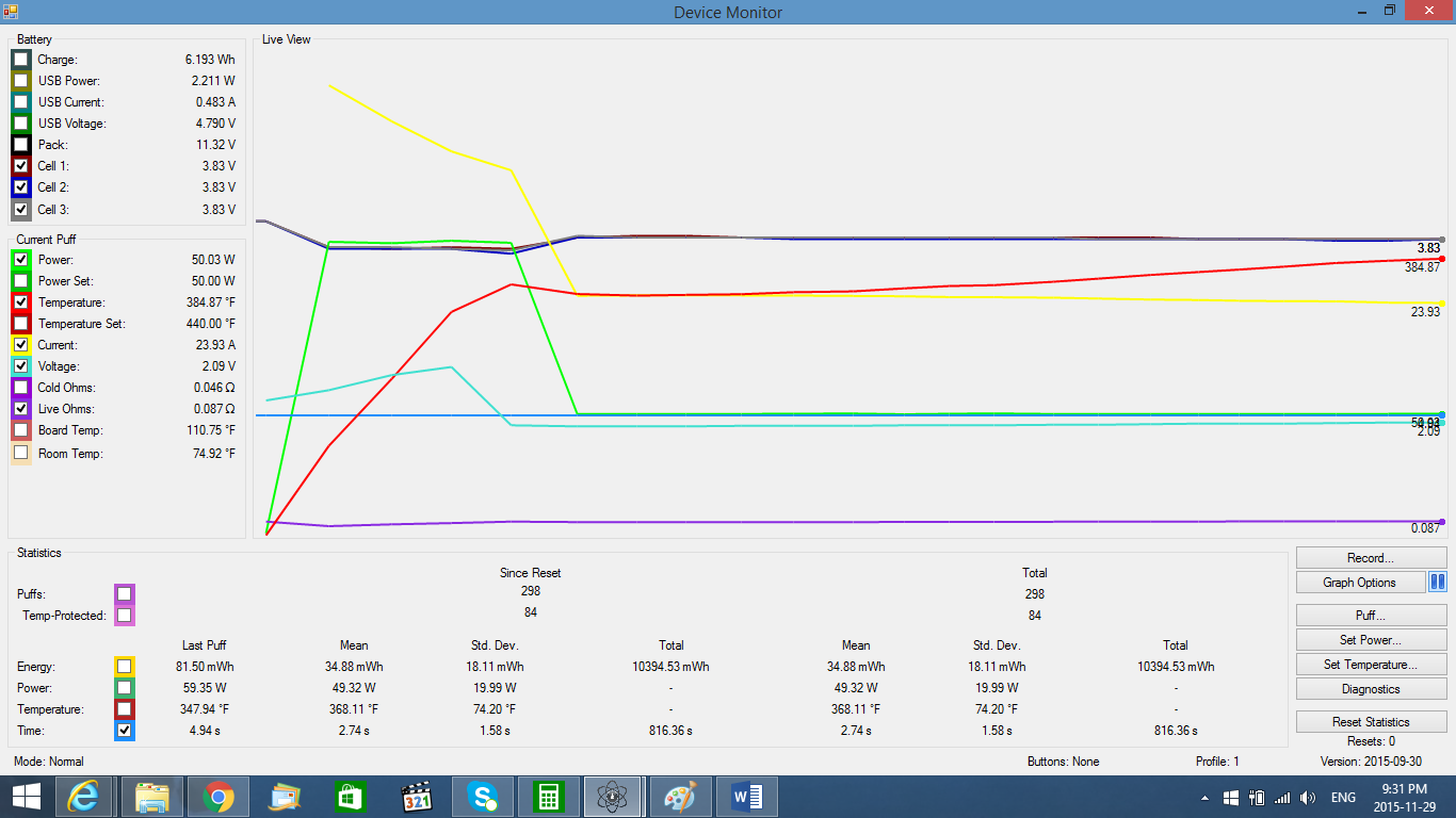

Hi, i just got a lava box on friday (black friday) and no, no correlation between sales and the box, just coincidence. I am having troubles with a bug that i have not been able to find through the search function which isnt actually why im writing this post. Which has to do with the chip not sensing tc coils and having to go through a series of steps to get it reading and working right. The problem I am posting about now is when i get past that bug which im hoping is fixed in an update sometime soon. When i get past the bug and i am connected to escribe i have my temp set to 440 with a preheat of 100w 1s 9punch, i then open the device monitor. when i take a pull the temp jumps to ~330 and creeps up slowly from there, and the temperature set is still 440. the weird part though is that it feels too hot for 440. If i reset temp to 400 it does the same thing on the graph and settles at ~330 but the temp feels different from when it was set to 440, but depending on if i set and reset the temp it hits hotter or warmer, never constant yet its always settling at 330. so tl;dr no matter the temp im setting, the live temp on escribe settles at ~330 and graph still acts as if its reading and performing right if temp was set to 330. Yet temp does not feel correct to what is actually set and isnt constant (hotter/colder if i switch between temps)
