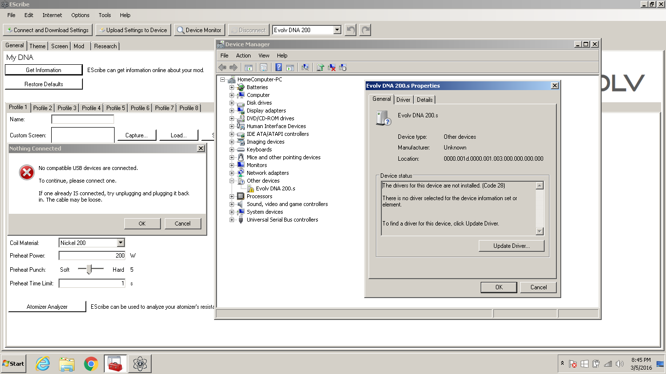

Believe me I did, I went as far as clicking on Have Disk and manually pointing to the .inf located in AppData\Roaming\Evolv\EScribe\Drivers It will not accept the driver installed with eScribe software. Ive tried this on multiple computers, fresh installed Windows 7 Professional at work. Its same exact issue across all computers.
Well I had two other micro usb cables, I have tried them and they dont even recognize the device at all, just charging, so I do see where you are coming from, the original cable in the box is a usb data cable and charge.
Thats indeed strange, I have not, the Device Manager does see my DNA200 but its not installed properly, yellow icon meaning issue with driver, I suppose I will try another cable @.@
There is a post of a VaporShark DNA 200 not properly installing on a Windows 8 OS aswell. I just want to be sure that we are aware some more devices may not be installing on other various Operating Systems. So far I have tried installing my device on the following: Windows 7 Windows 8 Windows 10 Every computer I have tried is up to date. What a bummer, I felt it in my guts that I would be arriving home to Problems lol ouch...
Got my VaporShark DNA 200 today, 4 different computers and I am getting the same exact errors. The driver will not install properly, I have even gone to work on a fresh reinstalled Windows 7 Professional with all updates installed, still same exact issue. Windows 7 Machines Windows 10 Machines Windows 8 Machines Driver issue across all What a bummer, I felt it in my guts that I will be arriving home to Problems lol ouch...
