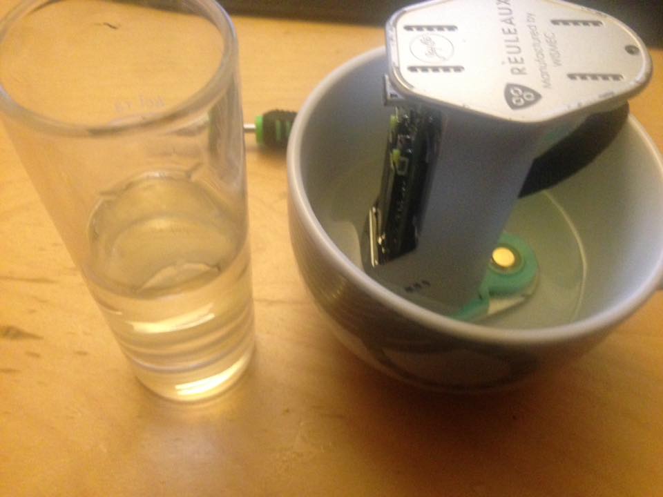

  2. Well, i went the vodka way. One shot for DNA and one Shot for me The vodka came out pretty dirty and oily. the button works fine so far hopefully, this will be final Photo for fun

  5. I could give it a shot. i did not dare to fill a glass up to the point where the button is immersed. but that should be rather safe. Nobody has objection on this idea?
