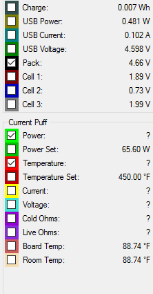

i got it out and cleaned it after air drying i got it all put together and the mid cell is finally going up (pretty quick too) fingers crossed but I'm thinking the problem is solved as i haven't seen the warranty screen nor the check battery as has been the norm for me heres a screenshot Not quite out of the woods yet but this the best its been so far
Sadly no i don't have a multimeter I'm thinking these readings are all wrong though i cant for the life of me find instructions on getting that board out though so many people say they've done it i see no screws or mounts at all ... its crazy i mean this is the nicest box ive laid my hands on but damn XD
Yeah that is way off its 70 in my house and the box is cool to the touch ive seen people with the same problem just clean the board with iso but i have no idea how to get the board out OR IF I SHOULD i take electronics apart and fix them all the time but my mod is my baby Lol also I'm with the mod as we speak. there was a gu on this forum somewhere that had this issue and fixed it by cleaning a bit of juice off the board but like i said idk how it comes out and don't want do damage anything.
