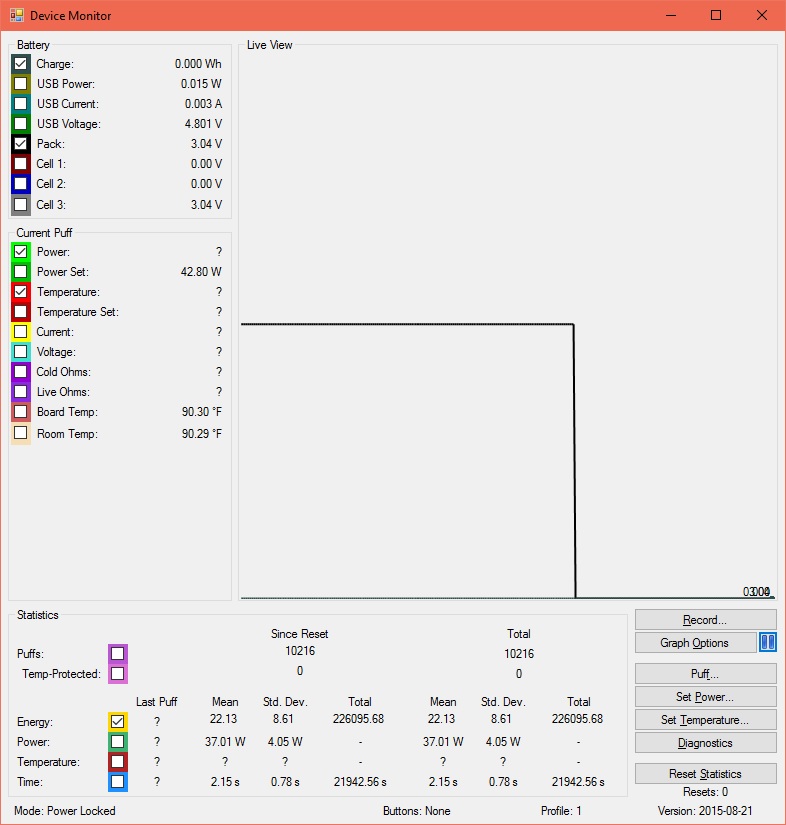

I now tried something new with my reuleaux. I did a hard reset with batteries in, same result, then I unplug USB, fire once, then remove battery, then plug in USB, same I get cell 1 and cell 2 0.00V, cell 3 4.14v. Then after I hard reboot it, I get this new reading, with no batteries in it. This means anything?
I am having the same problem. This started yesterday after I try to plug in the USB to charge and realized I can't charge it or even vape on it! So I externally charged all 3 batteries to full and this is what I got from escribe. BTW I use 3 Samsung HE4. This is the reading I get when I removed all batteries. Cell 3 still reads 3.04V even without any batteries inserted. I tried rotating the batteries, I even bought 3 LG HG2 (Brown) batteries and still the same result! I tried tightening the ground screw (gold plated), made sure all batteries are fully making contact, hard reboot, soft reboot... all to no avail. Anyone have any idea how to fix this?
