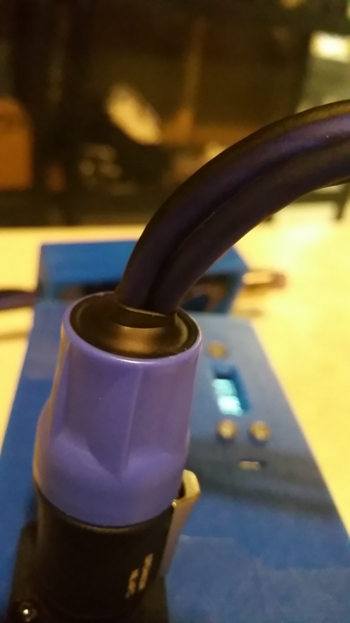

  1. Hey thanks for the kind words everyone! The hose actually is quite flexible and hangs nice without taking either of the boxes off the table. - I am thinking about sheathing the cables to keep em together and give it a more natural flexibility. For the Ammo box idea: could happen... i have a yellow lighted ps3 that im taking apart to make something special so we will see how that goes...

  3. working out some kinks still, but everything is functional! Temp control works, but isn't really what the device is meant for. Entire wire and connector resistance = 0.05 ohms. - changed the settings accordingly. ----------------------------------------- This is simply a beta unit to see what kind of hose length I could achieve before stressing the battery, chip or connector too hard. Plans are to add the following: - 4 Port USB hub (will require wall input) (can be used to charge internal lipo) - 2 - 4 hose setups (multiple chips) - Higher MAH LiPos (5000mah+) - Better Handheld Box design (smaller and give it some curvature) - Potential for interchangable lids to the box (build deck lid/onthego lid) anyone else have some good ideas to put into it???

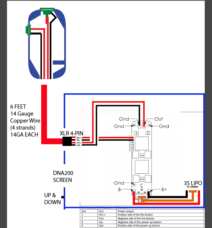

  4. UPDATE : Finished the first one ... Works flawlessly on power mode... used 14g OFC wire for primarily the entire build

  7. hey everyone, in the works of a dna lunch box with a hose to the 510... lots of grueling research has already been done... My question is: Ill have 6ft power + and power - going from the chip to the 510... using 14 gauge copper wire. wire resistance is about .02 ohms. Will this work? or will it cause problems??
