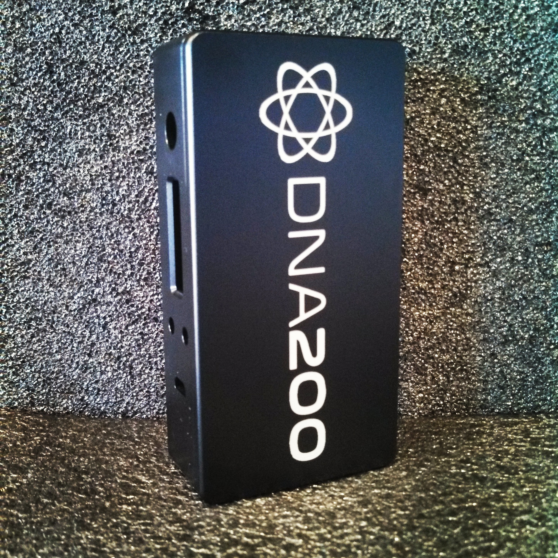

Yes i build box mods and vape stations lol. I move fast. Only been vaping 2-1/2 months. I also build my own coils - i learn very fast. The guy that custom laser engraves my boxes just got the Alpintech pre-cut dna 200 boxes, so ill be making a dna 200 as well. The power supplies are for OKR t10 passthroughs for vape stations/ tester stations. I only used 9 watts last time and turned the lights off and they glowed very faint, but they wasnt blue anymore.

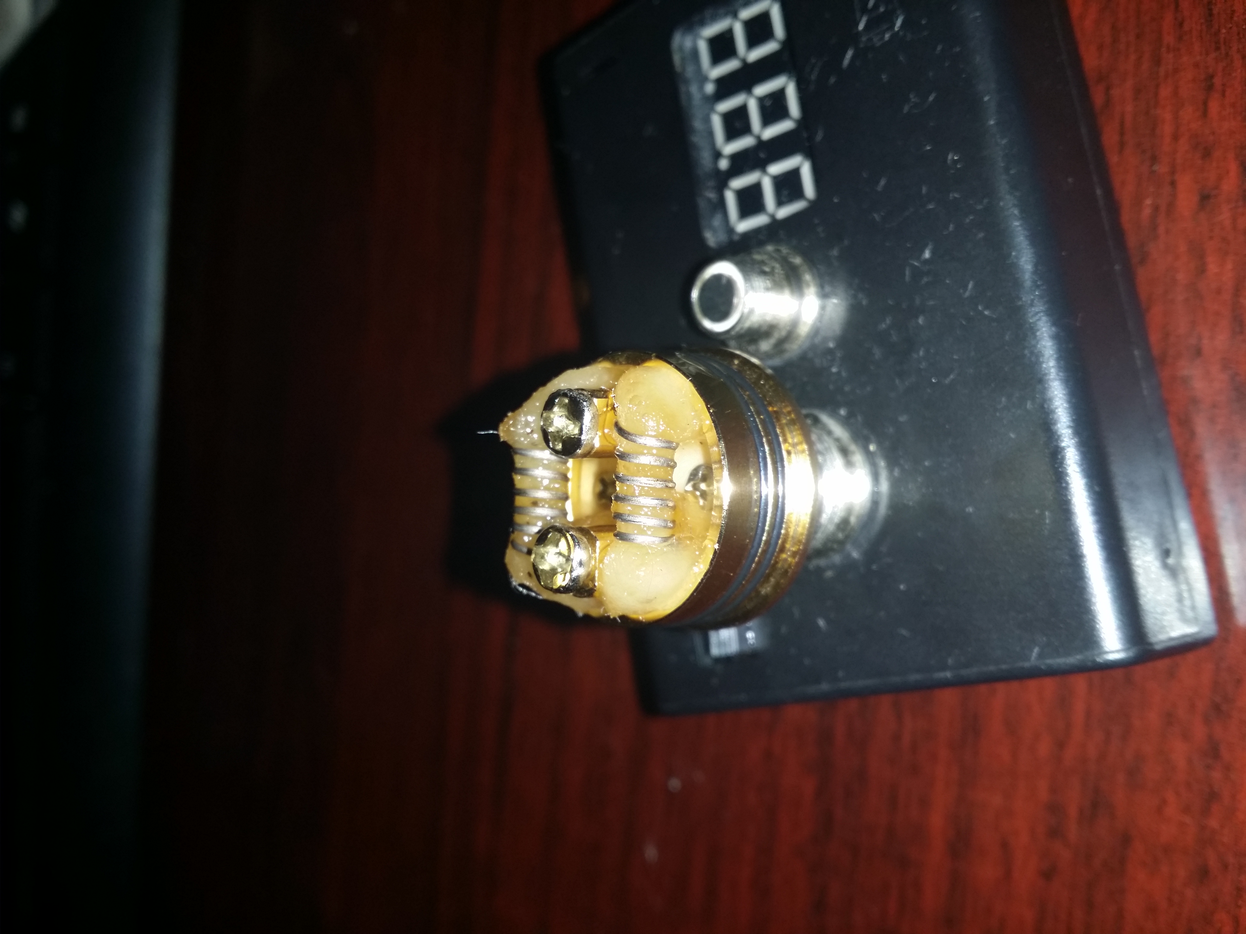

Ok. This is my first try at temp control. Guess I'm so used to kanthal and n80. I'll try and turn the temp up more - for a warmer vape. Here is what my ni200 builds look like
sorry i meant temp protected.
My nickel builds are spaced with 12 wraps. The cotton has burned some with the nickel, but not enough to taste. The cotton burns with contact Ti (works good for a couple hours then it will just hit really harsh and its done), just singes. The problem with nickel it almost always says dry coil.

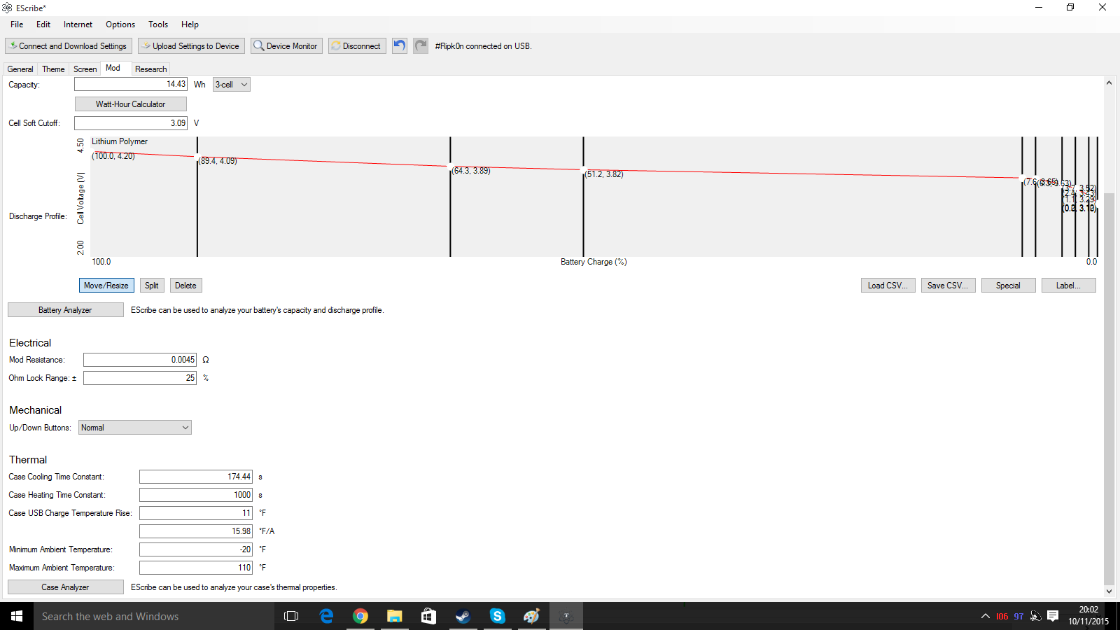

i know its fooling it once i fire and put back on. 12 wrap 28g ni200 @.08. Tried on velocity clone and petri clone. Tried the ni200 setting on the escribe and. Temp 450 @ 70w - Preheat/punch 125w punch at 5. mod resistance .0045. Was using ti with the same setting but ti grade 1 csv. "Temperature (degF)","Electrical Resistivity" -58,0.58 68,1 212,1.48 302,1.78 392,2.08 482,2.38 572,2.68 800,3.44

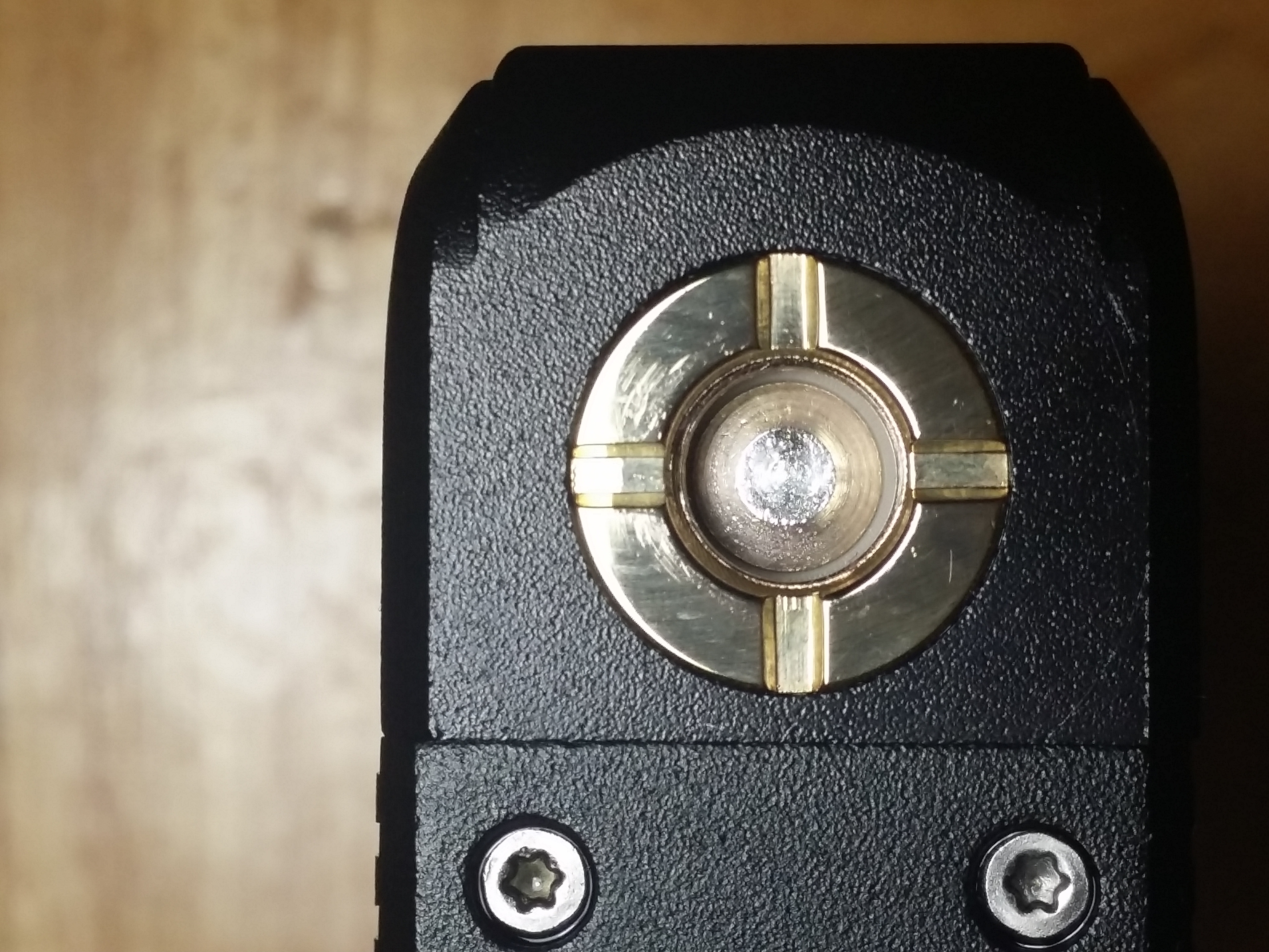

I mentioned my serial is 87xx and i purchased at a local vape shop, so i dont know if its v2. Here are a couple pics

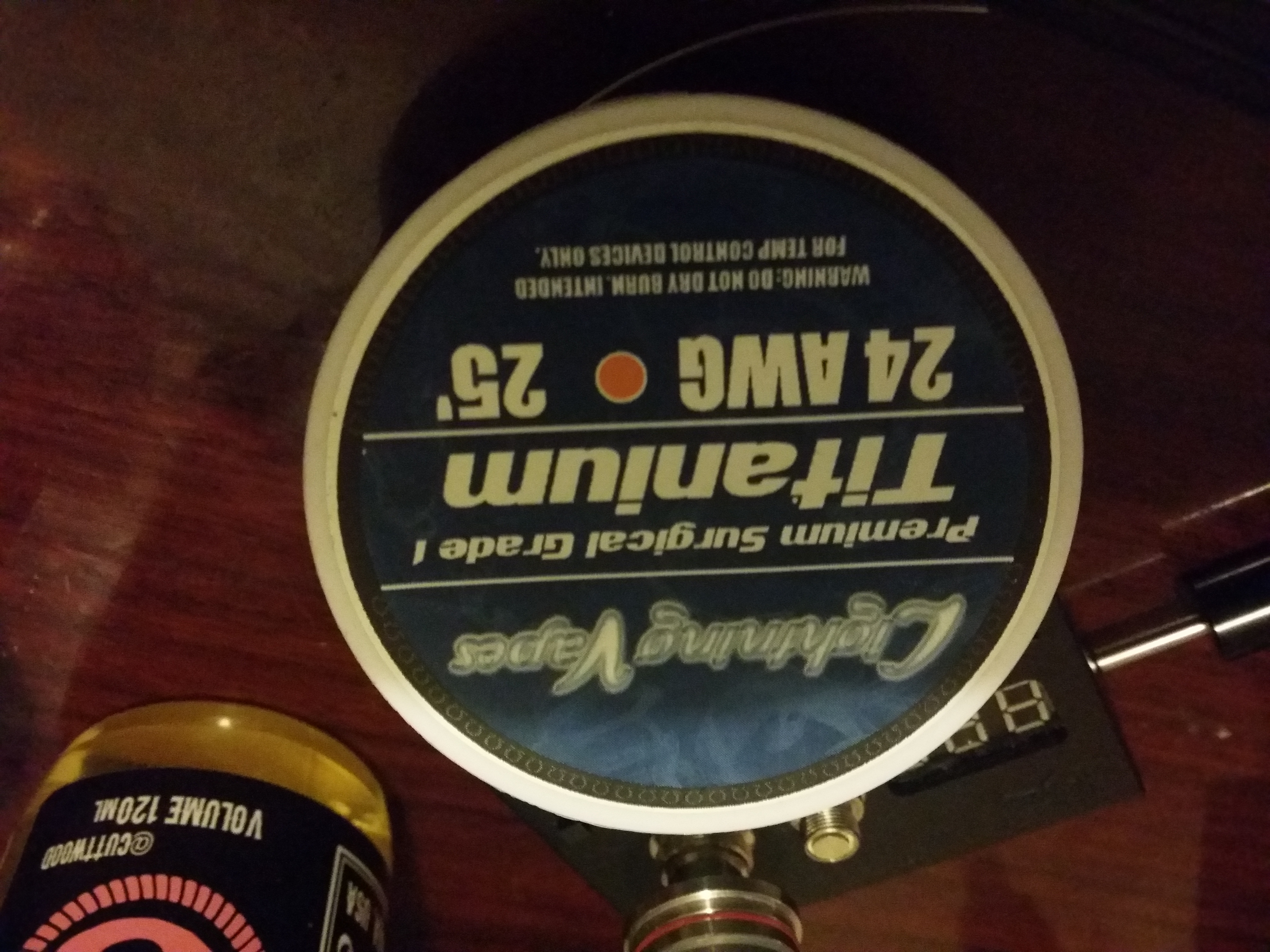

I had order some 24g from lightning vapes - Premium Surgical Grade 1 Titanium 24g. I downloaded the Ti 1 crv, but no matter how much liquid is on the cotton/coil it says dry coil. I have never messed with Temp control builds. Built a Ni200 tonight and it works good until i let it set for awhile and it does the samething - until i take the atty off and hit new coil . Any ideas why im getting dry coil every hit? Thanks
I have a VT200 i bought from a local vape shop, so im not sure if its version 2. My serial is 87XX and it looks like gold plating not brass.
