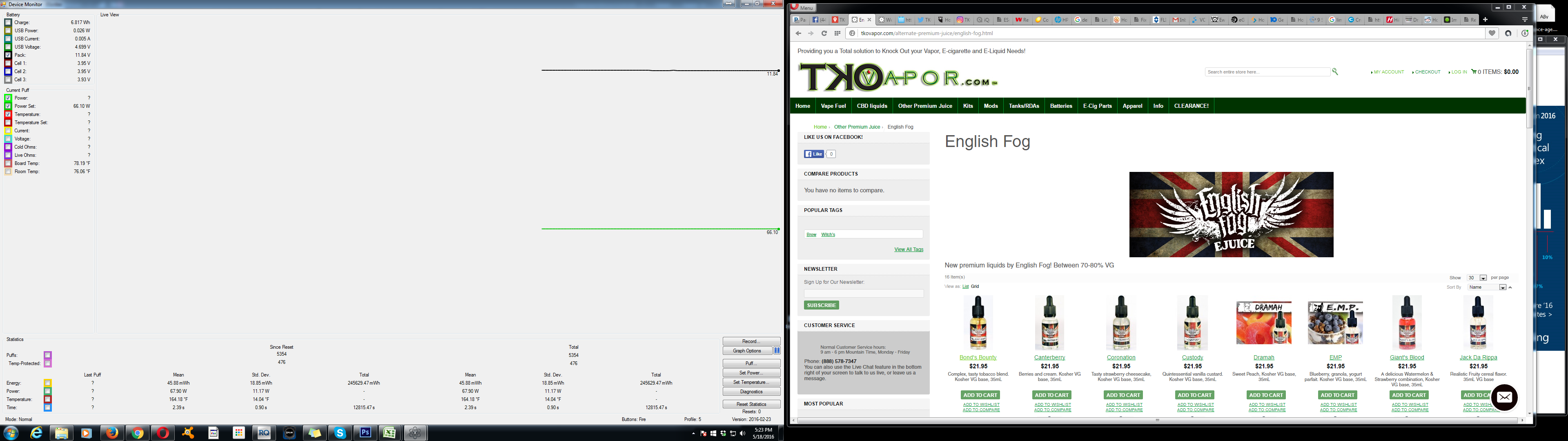

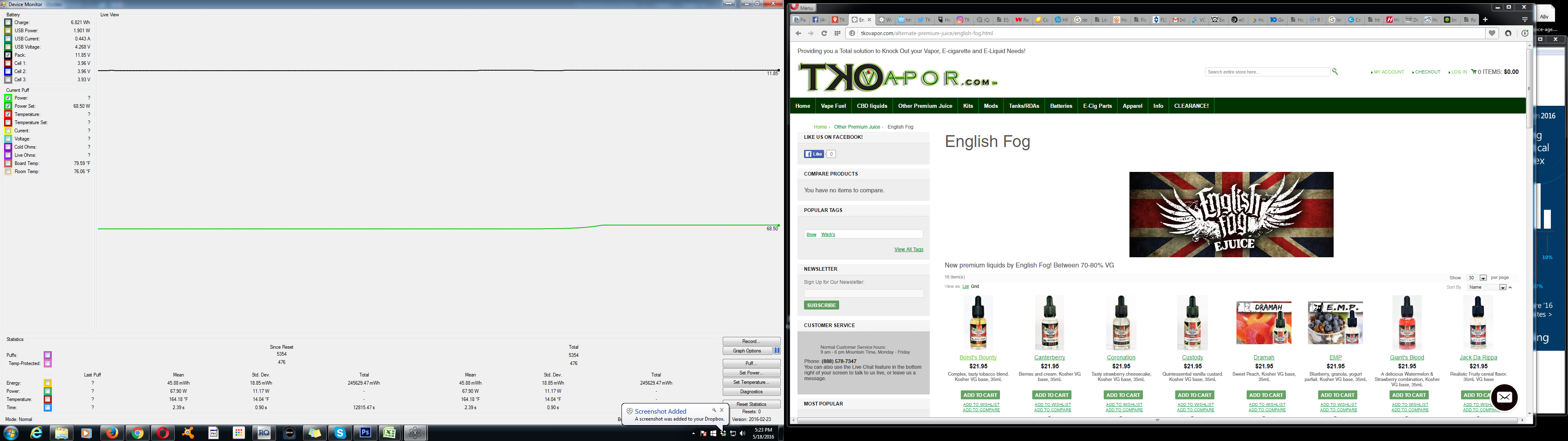

New to the forum, new to DNA200 chips. I'll try to be as detailed as possible. Problem: When I attach a tank to the VT200, the power automatically ramps up to 200W. Won't fire after that. Doesn't read oHms on the coil, either (although that could be because it won't fire/read the "new" coil"). IF I attach a tank and try to fire before it reached 200, it'll stop ramping up to 200, but doesn't actually fire. Doesn't read the oHms either. And once I take finger off fire button, the power ramp up continues. Tanks used while trying to figure this out: 2 different TFV4 tanks (1 full, one mini) with triple coils at 0.2 oHm 1 Vapmod XTank with 0.3 oHm coil 1 Matrix tank with 0.6 oHm coil (All coils Kanthal) Uwell Crown with .15 oHm Ni200 coil Troubleshooting already tried: Installed Evolv DNA 200 Escribe software - device connects just fine. All controls within seem to control/affect the device as supposed to. Performed firmware update - Nothing Reset to factory defaults - Nothing Reset all profiles to Temperature: Off - Nothing Tried a few different combinations of the above - Nothing Atomizer Analyzer DOES read correct oHms off coils when connected. CAN reset power output in the Device Monitor, as well as perform simulated fire (which SOUNDS like it actually fires the atomizer when connected). Essentially, no matter what setting we change, revert, update, firmware upgrade, etc, when you attach an atomizer to it, it automatically sends the power up to 200W. Thoughts?
