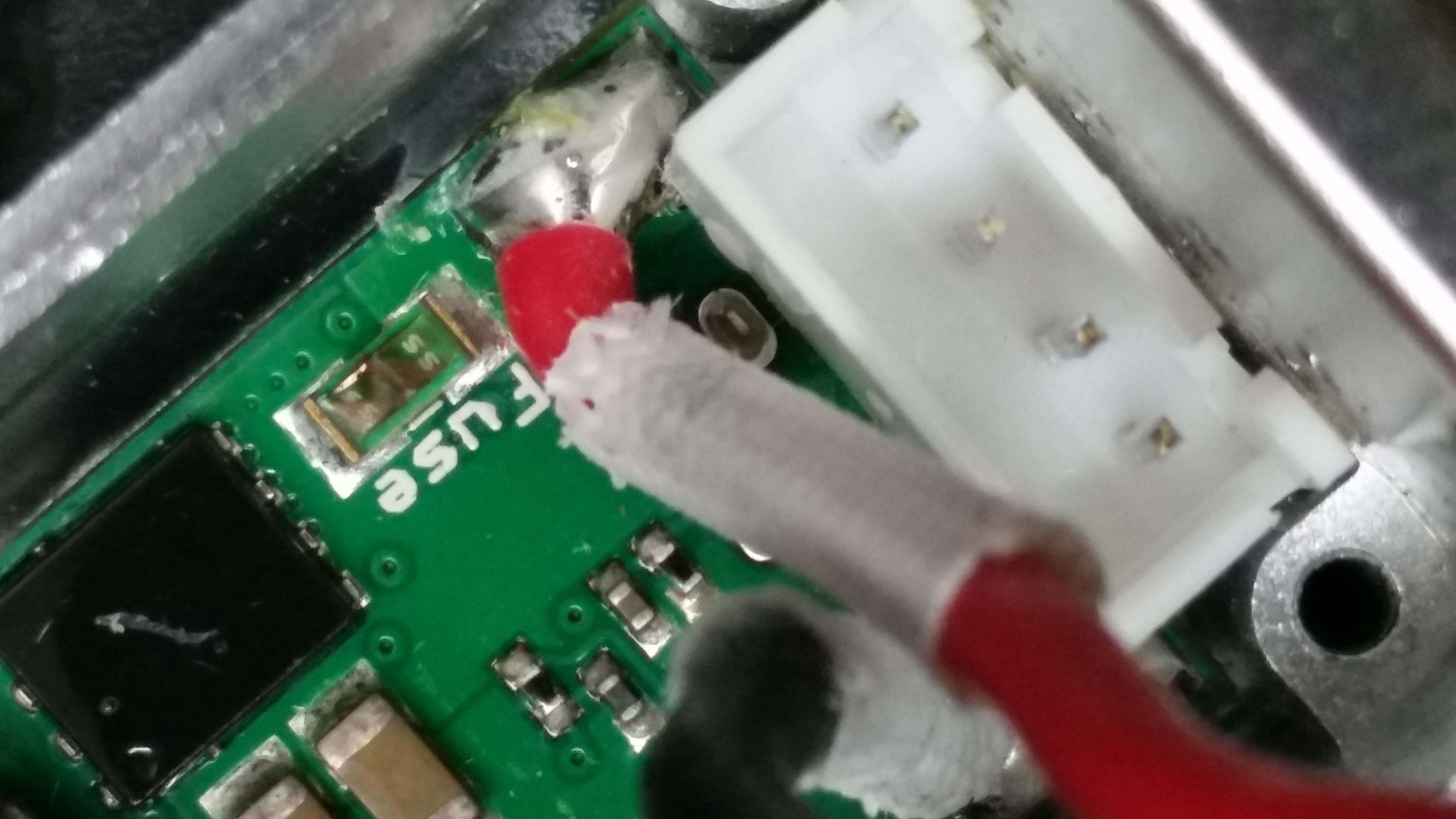

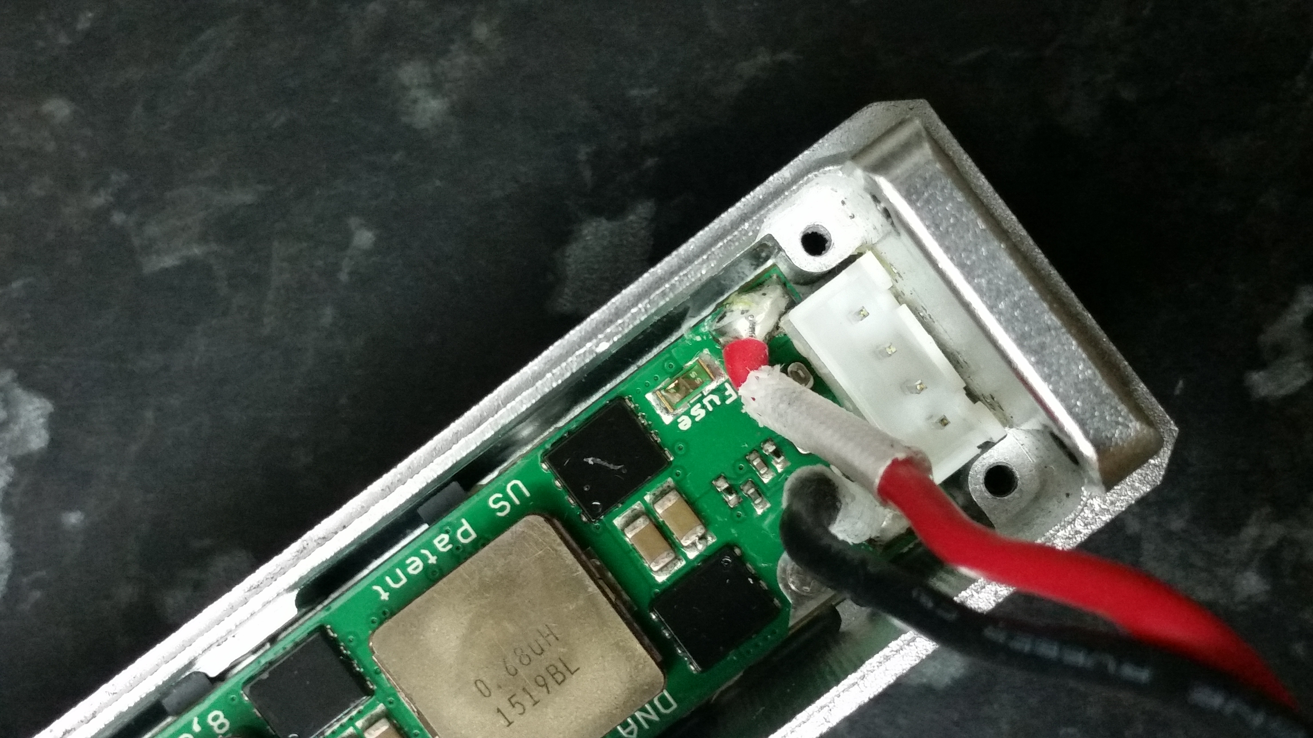

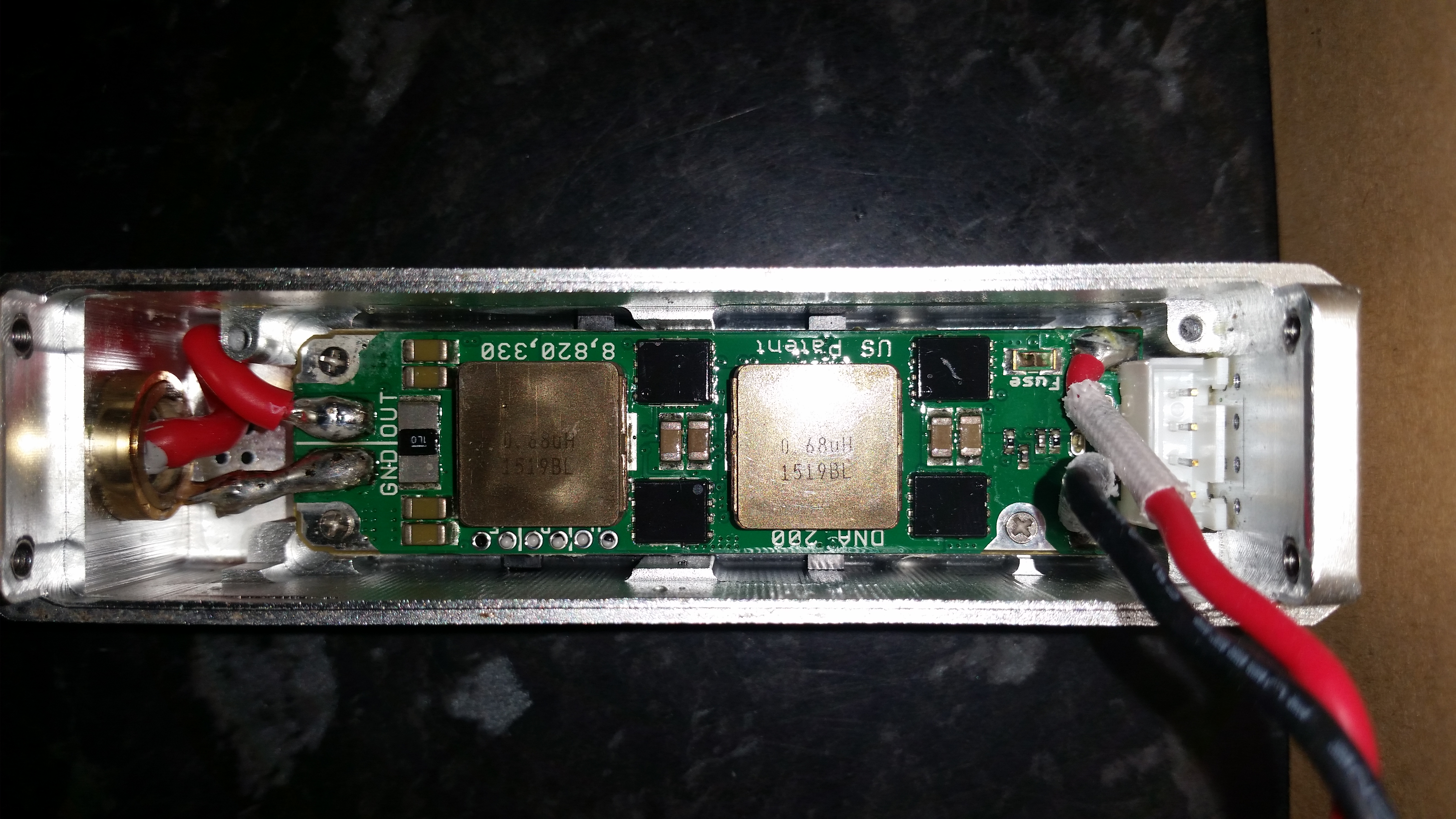

  4. Yes that's what I was thinking, if it had connected ok I would have bought a replacement fuse and soldered it in to try it but because it wouldn't connect to escribe I thought it best to ask first.

  6. The vendor is not interested as it's past there 60 day warranty period and told me to contact hcigar direct but they don't seem to be replying to enquiries according to quite a few posts on the internet. I will open a ticket with evolv and see how that goes, I have no problem removing the board from the mod if that's what is required.
  7. I decided to open it up and take a look inside, the board looks fine with no signs of damage but I think the fuse has definitely gone. Hcigar still haven't gotten back to me regarding this and from what I have read on the internet they seem very difficult to actually get a response from them so it looks like I am screwed, shame as I really liked this mod but looks like I'm back to using my old ipv4.
