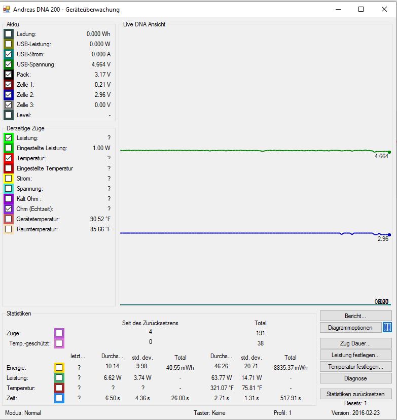

  1. Is that normal when no batteries in the Box ? i will make pictures tomorrow ty

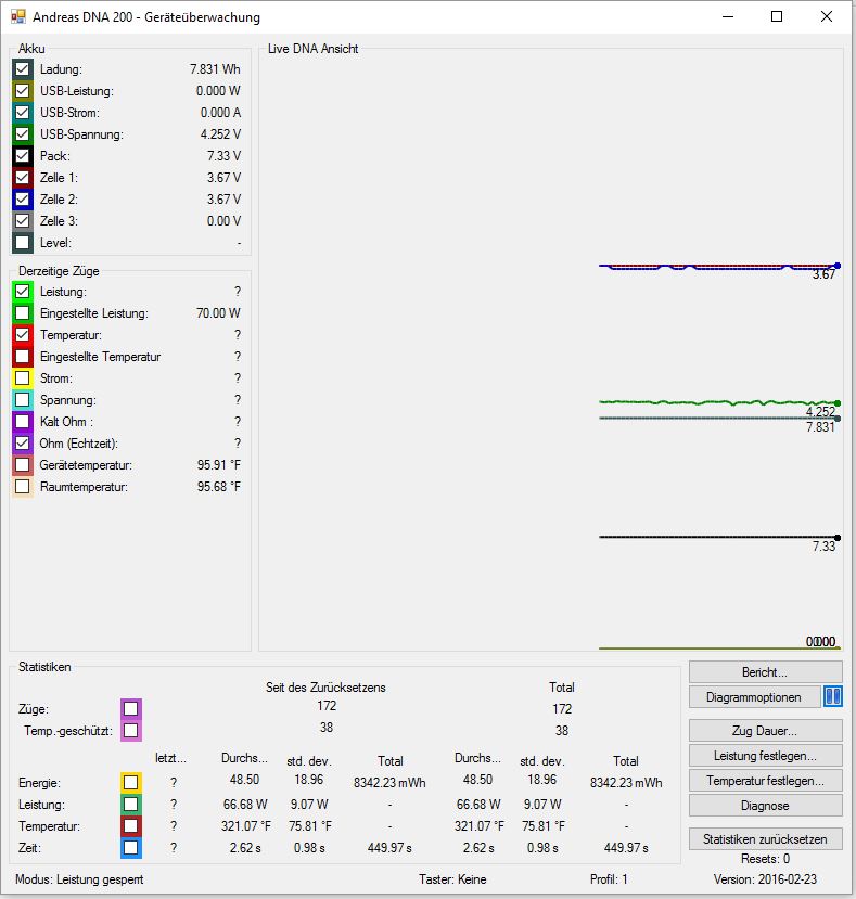

  2. yes wiring ist the same. tryed hard reset and soft reset nothing changes. no its the first time i try to charge i build it today. thx for your help
  3. i did the amp limit to 1A but nothing happend. my batteries are 2x 18650 Sony Vtc5 2600mah each Set to 17,77 Wh my wiring is like that https://s3-us-west-2.amazonaws.com/cdn-nonameboxmods-com/dna-200-dual-18650-wiring.pdf

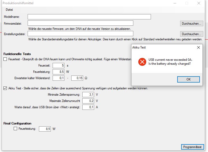

  4. this page is under tools -> production utility
  5. yes 2 cells and when i make the batterie test it failes. I Set the A to 1 and nothing happens
