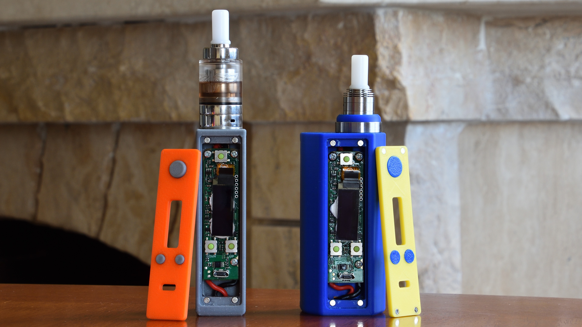

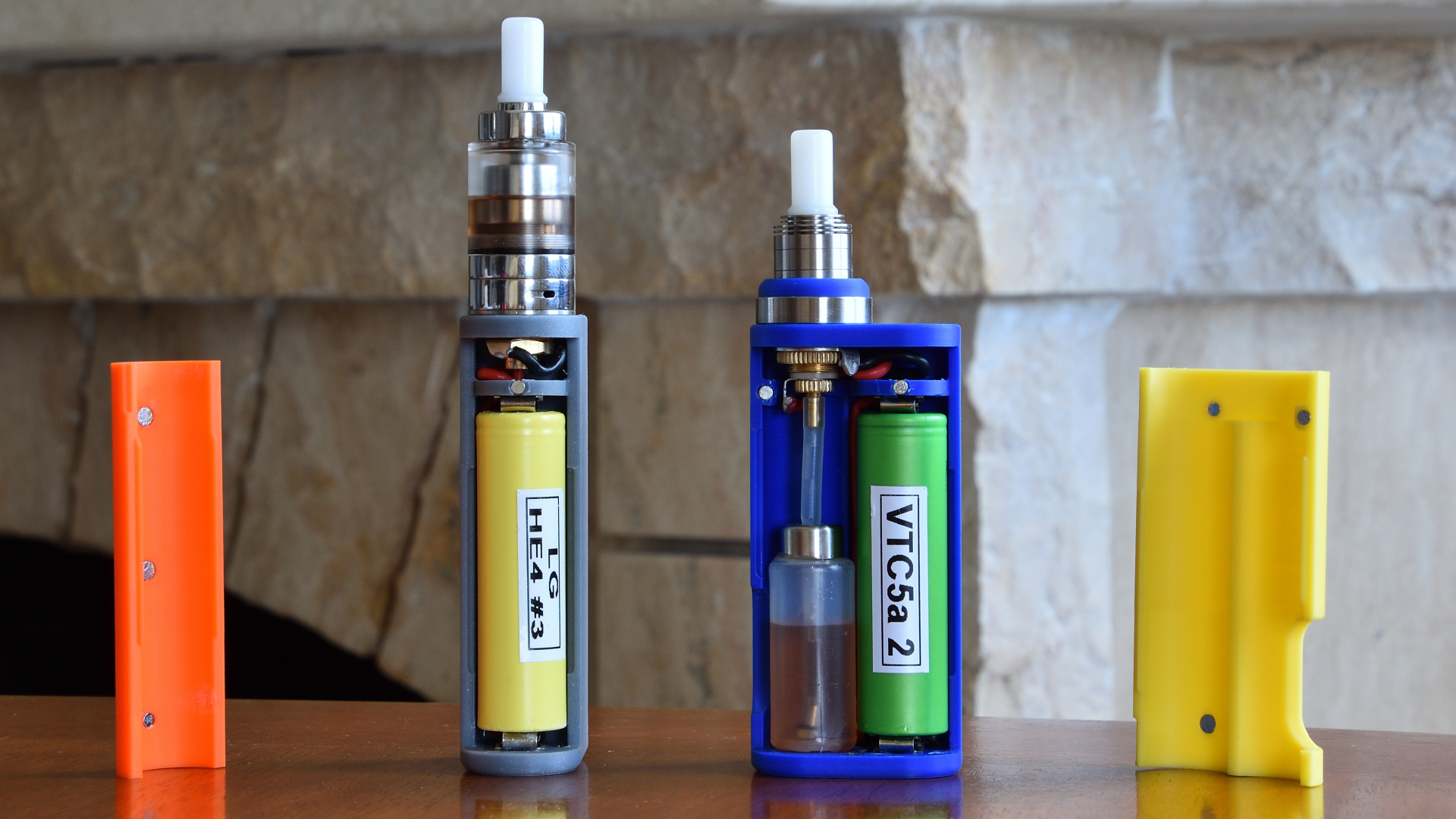

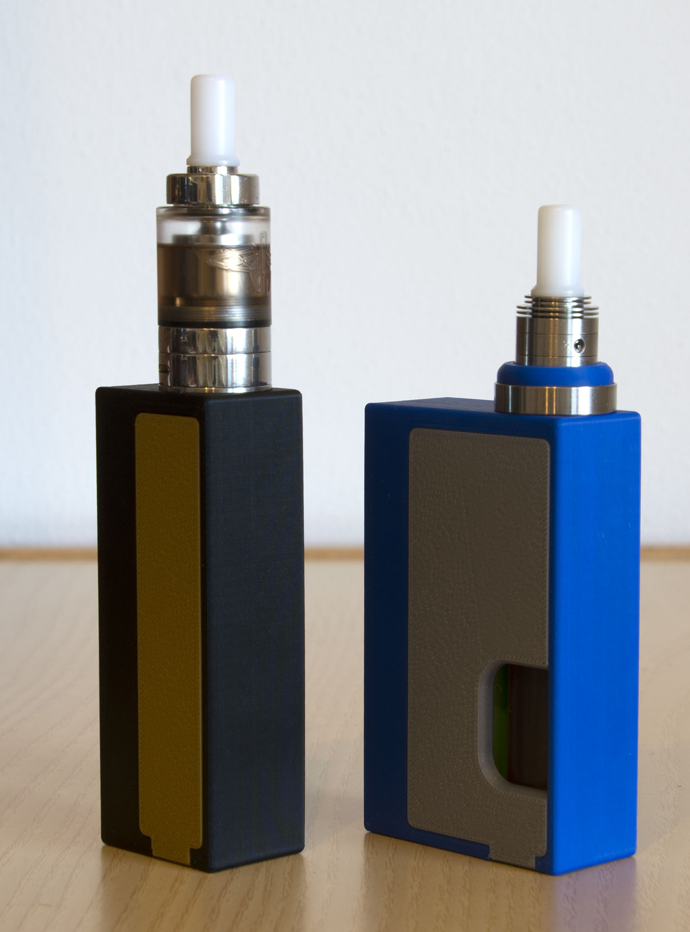

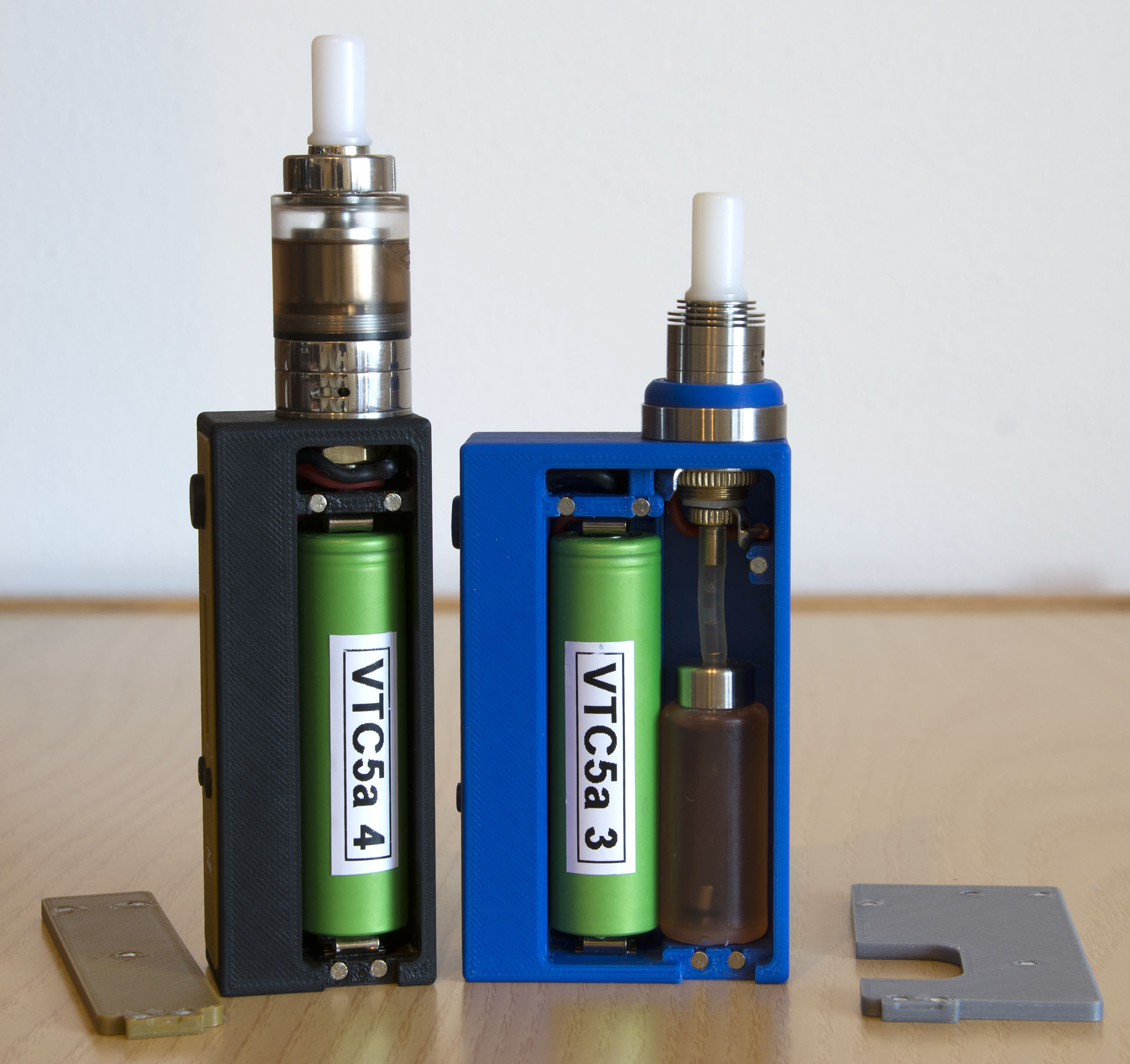

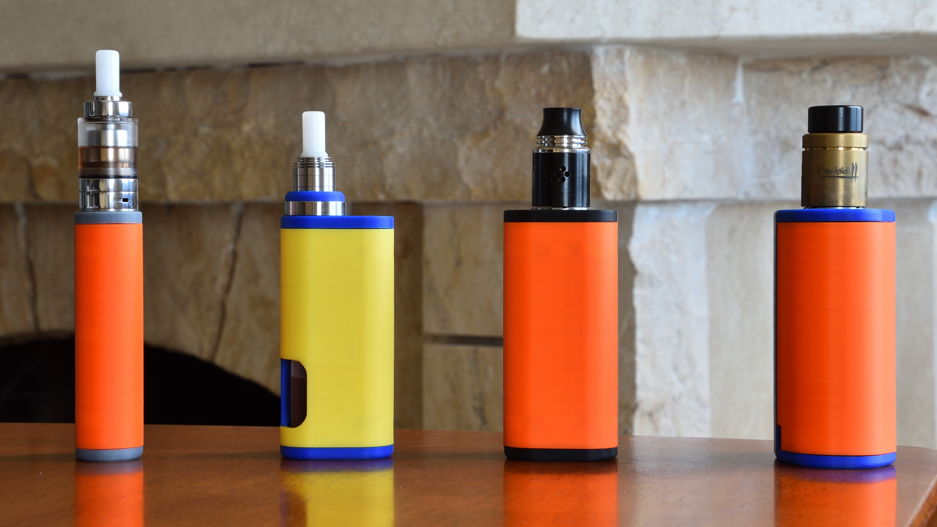

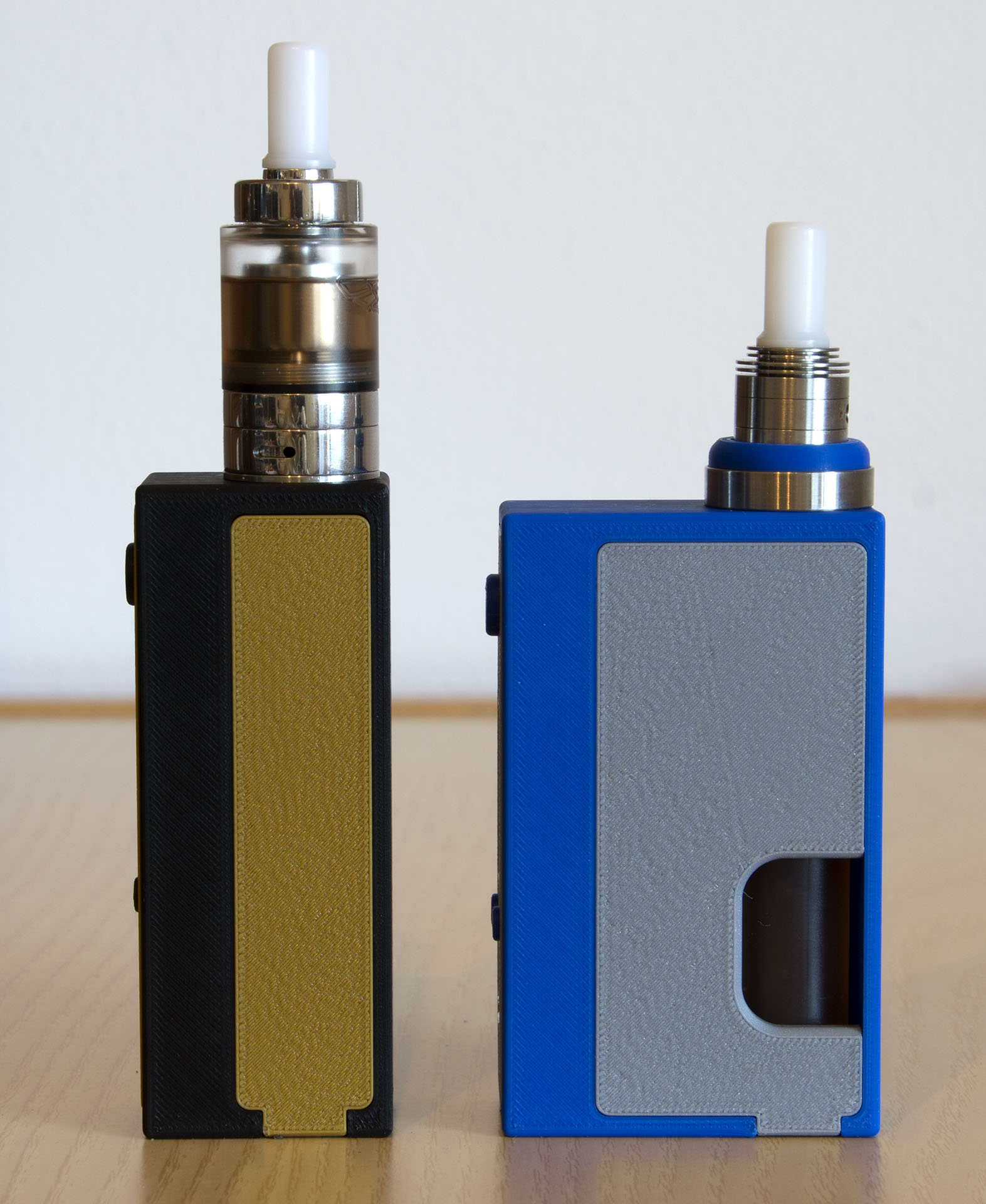

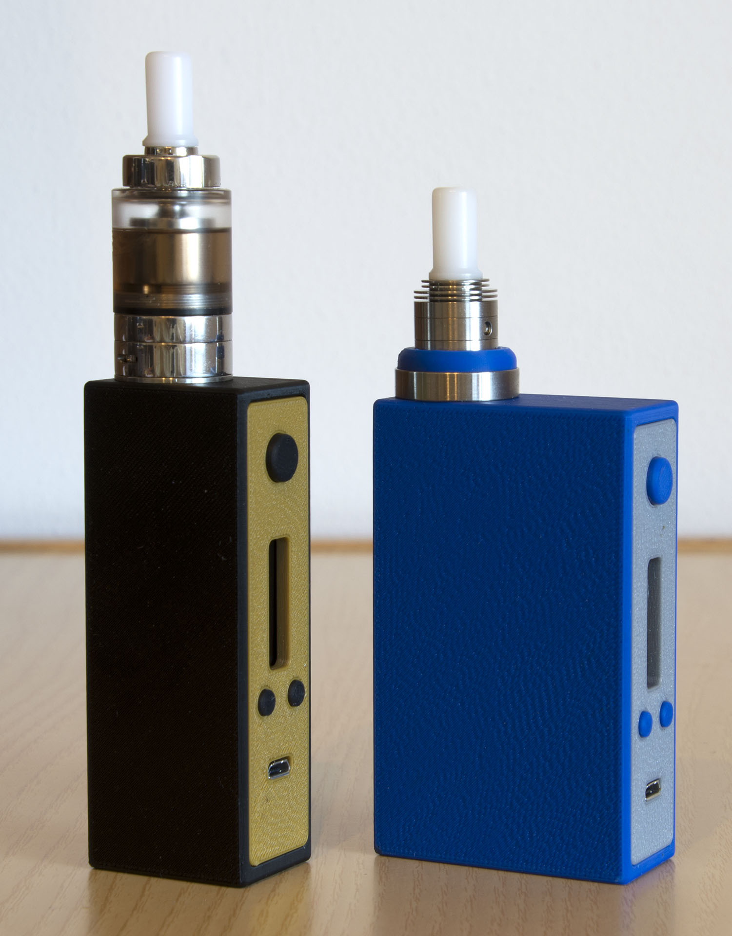

  1. Thank u. Here the other two in "classic" version. Bottom feeder: http://www.thingiverse.com/thing:1536390 (52x88x25 mm) Box Battery: http://www.thingiverse.com/thing:1535840 (35x92x25 mm)

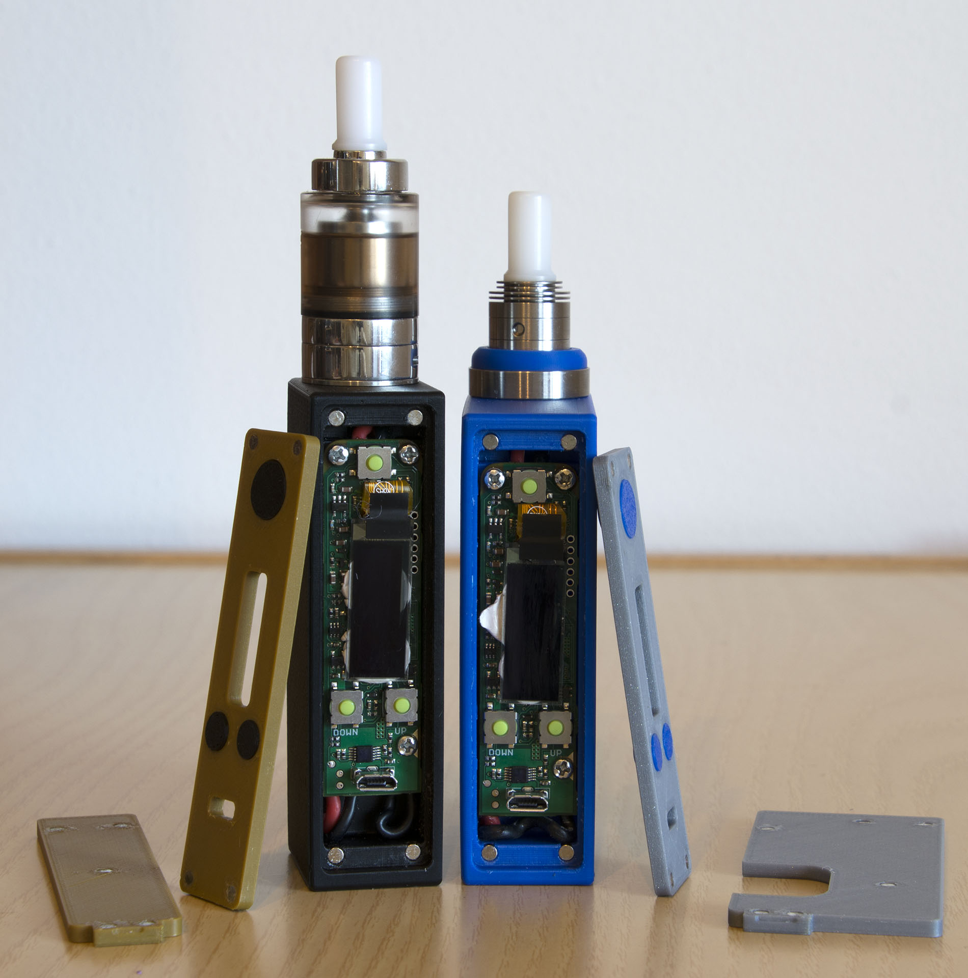

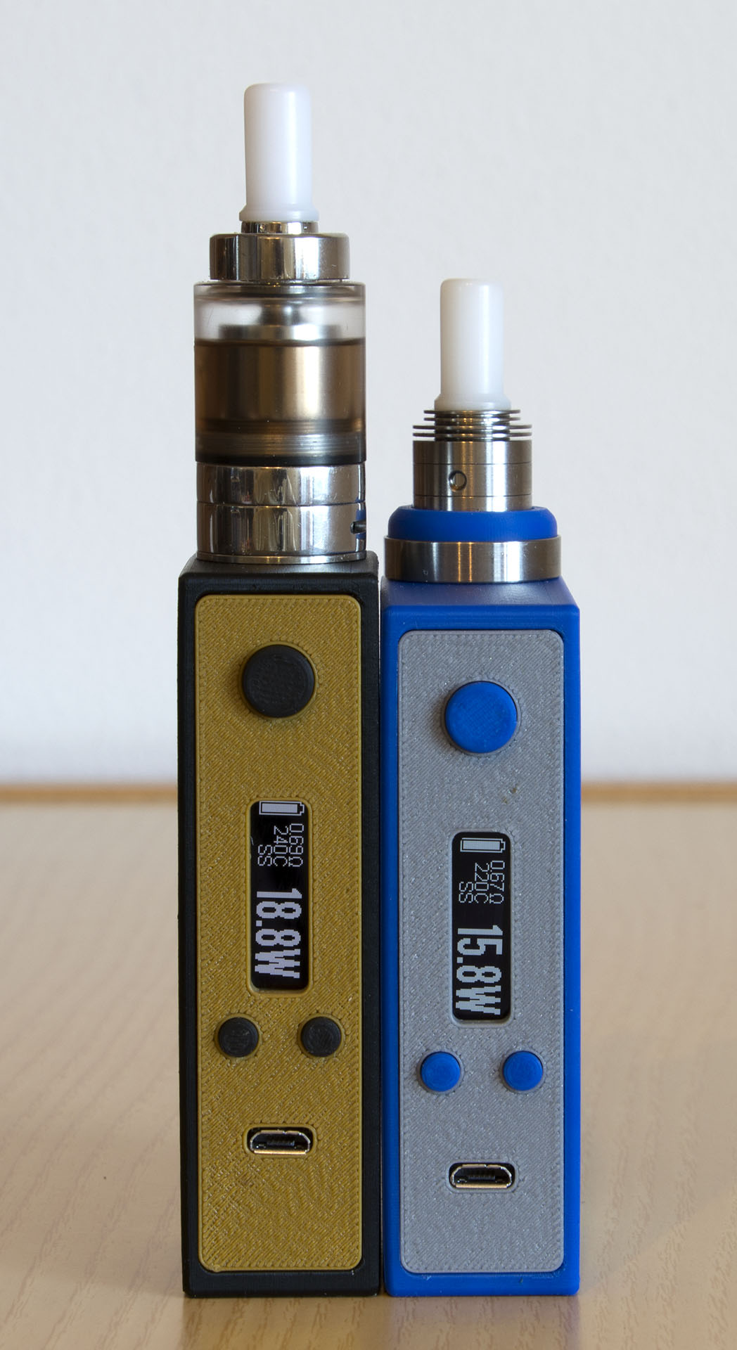

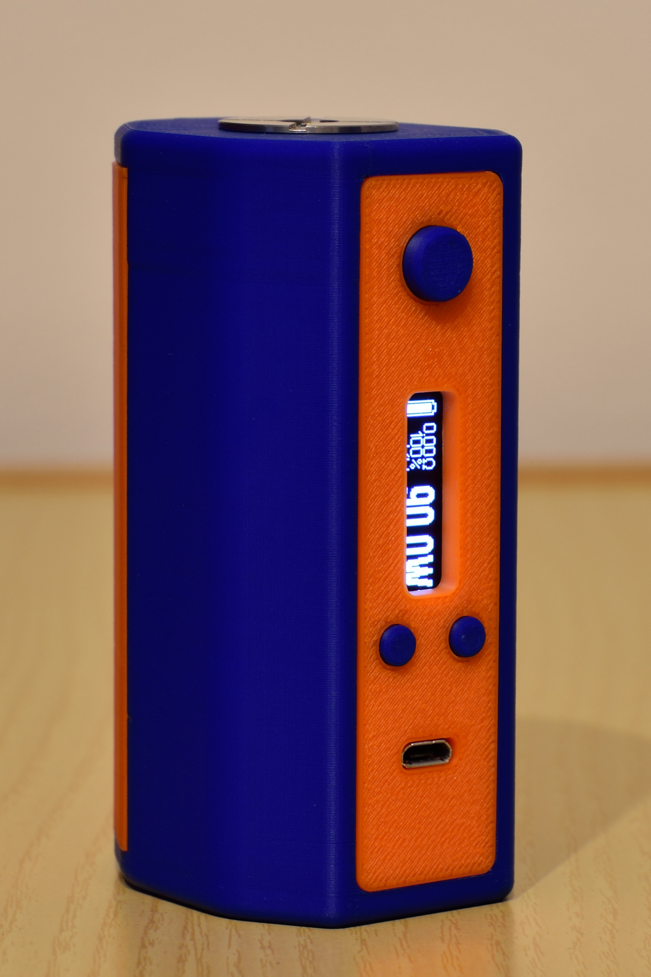

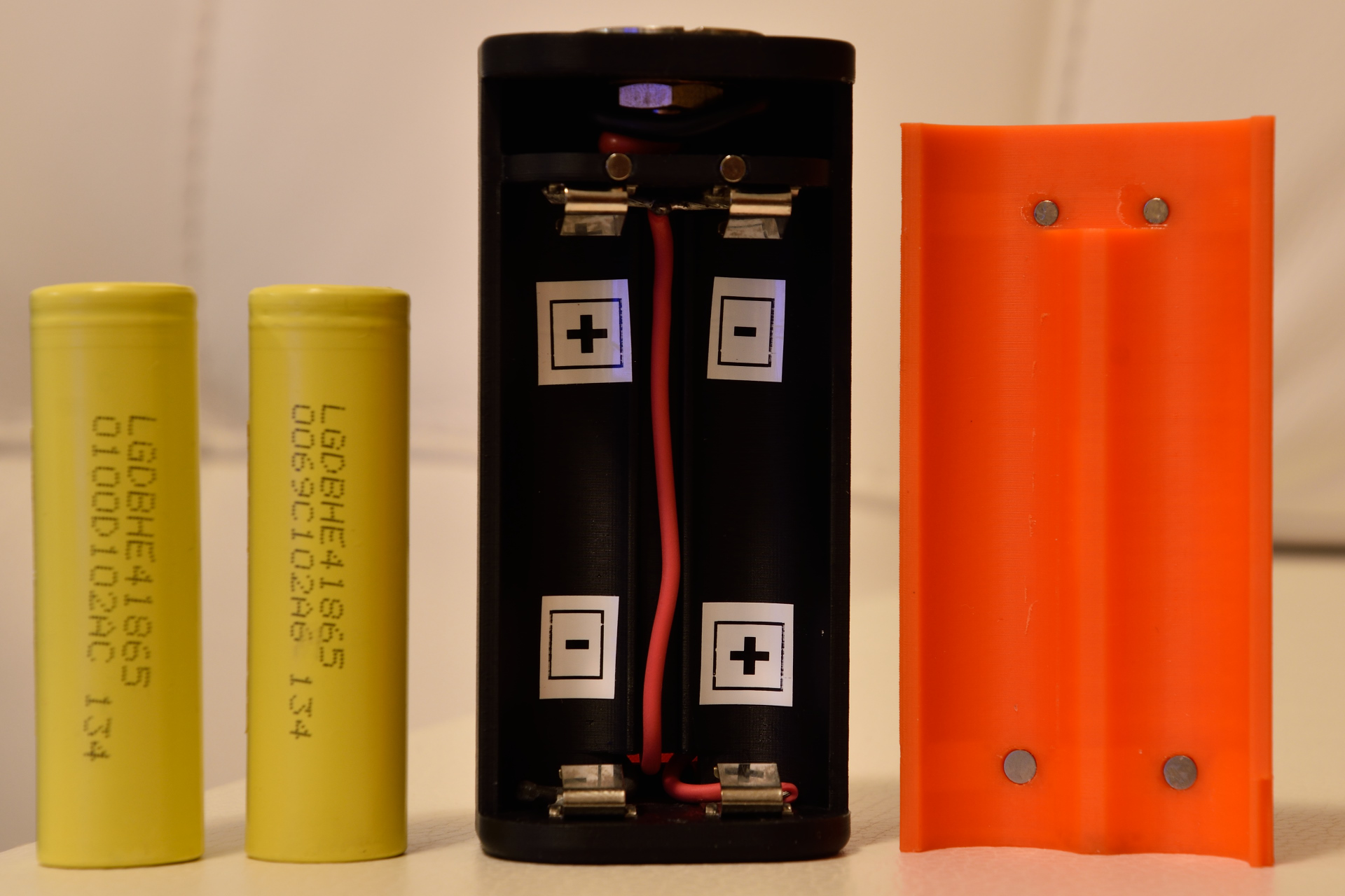

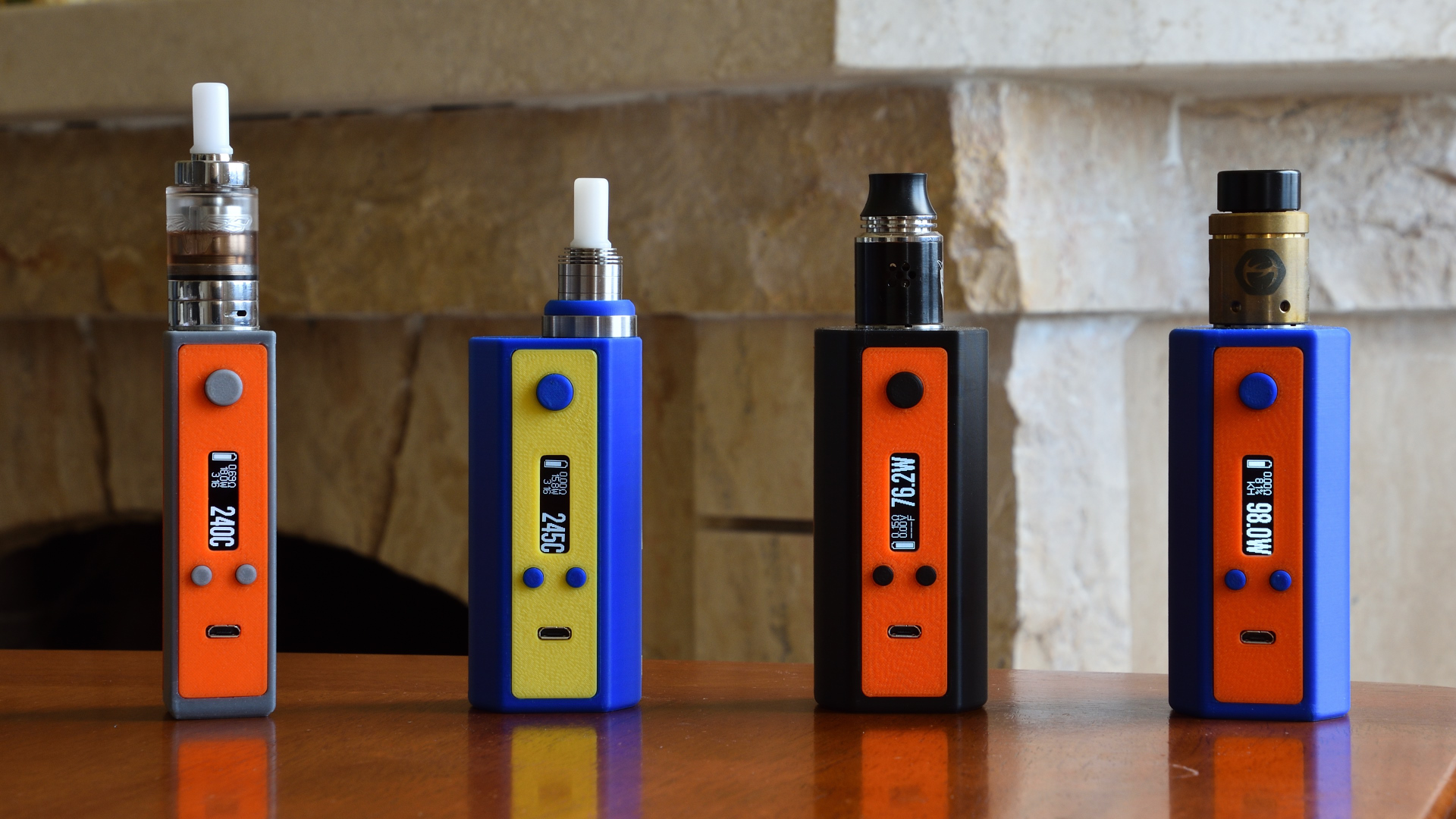

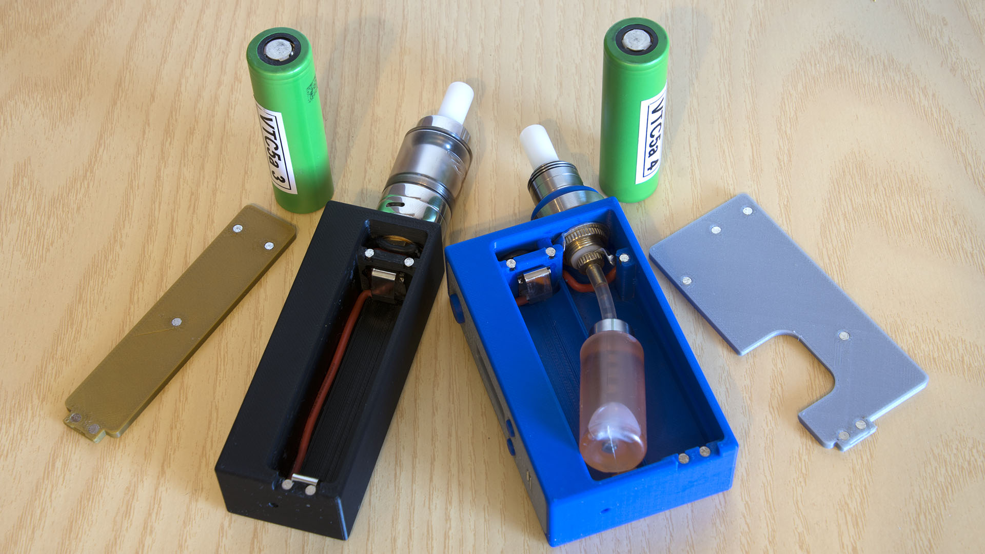

  2. These are the first two box mod i did with the new DNA75. Box battery: http://www.thingiverse.com/thing:1572914 Bottom Feeder: http://www.thingiverse.com/thing:1561386 On thingiverse, in each project, u can read some information about size and what u need to mount. I think that are easy to print (in vertical, at 150 micron of resolution) and to mount. I printed all in ABS, 150 micron of resolution. Here all the DNA "full family" (on the right DNA200 2x18650 and DNA200 3x18650).

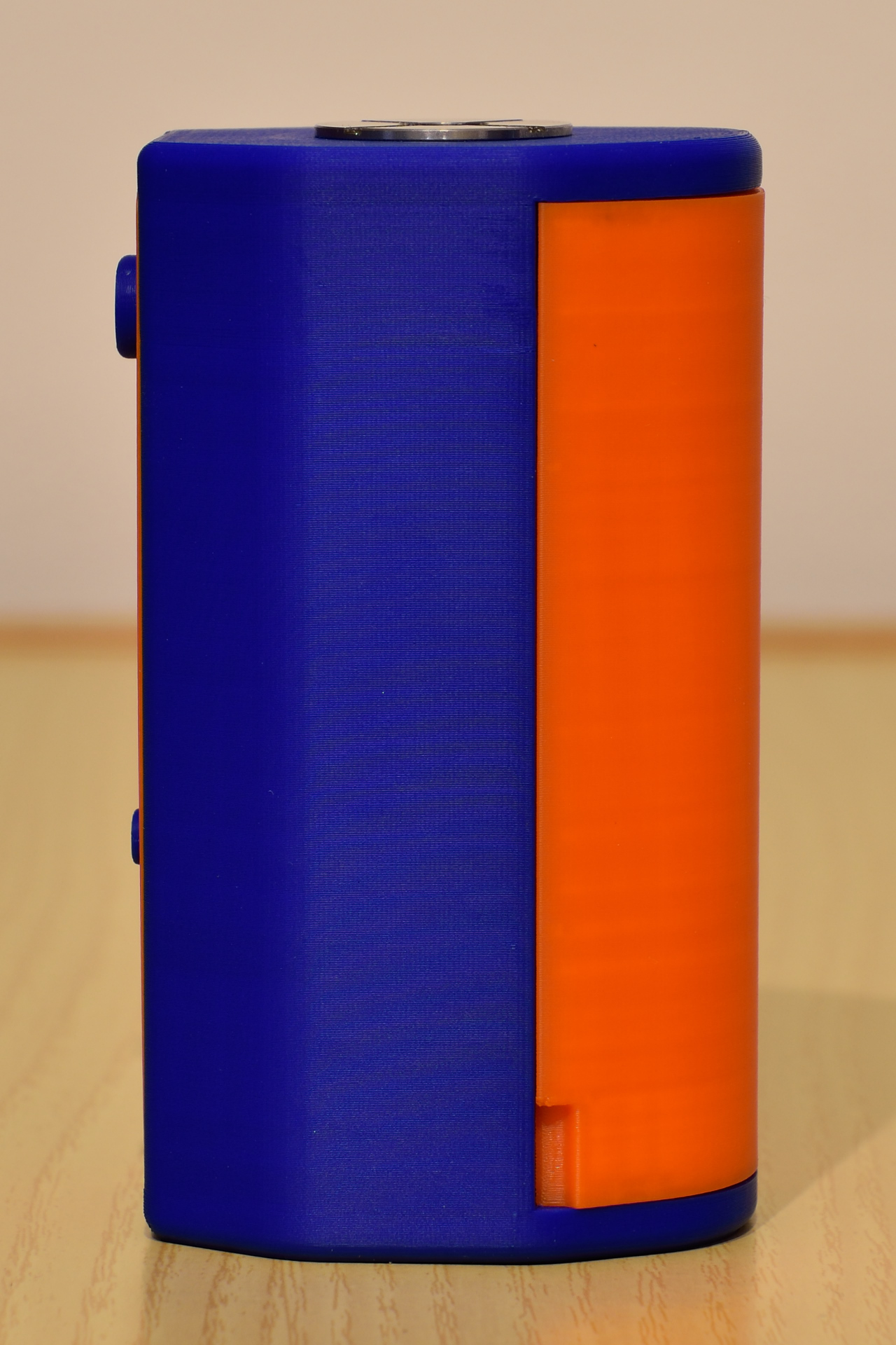

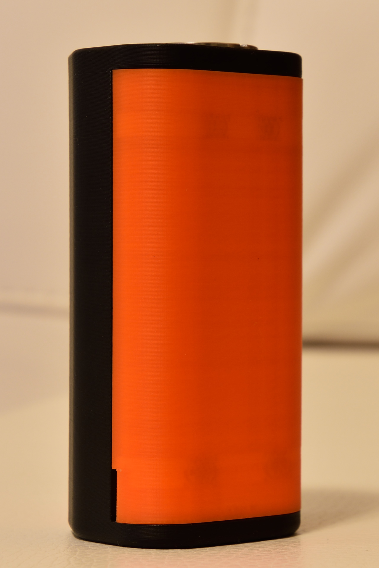

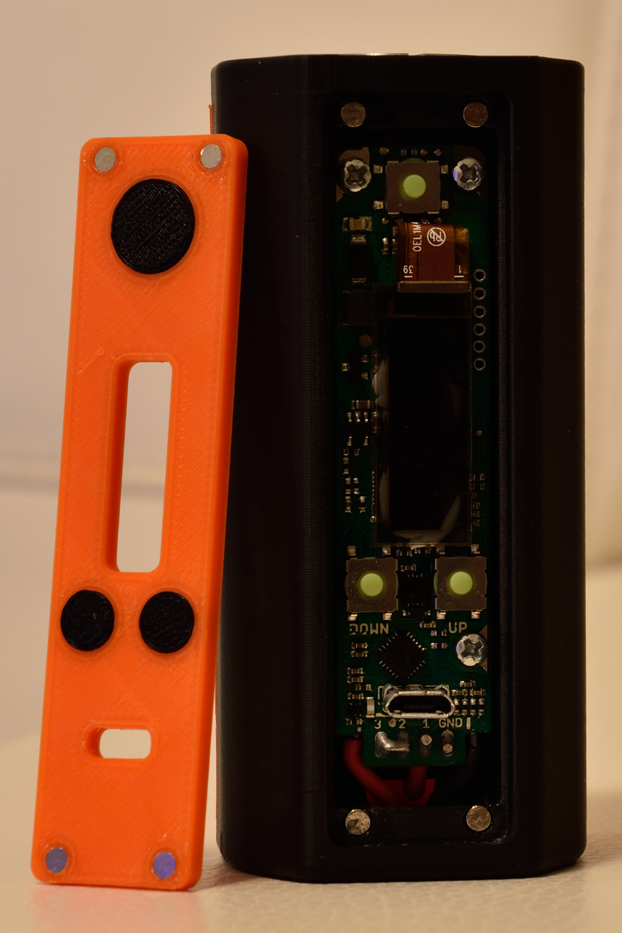

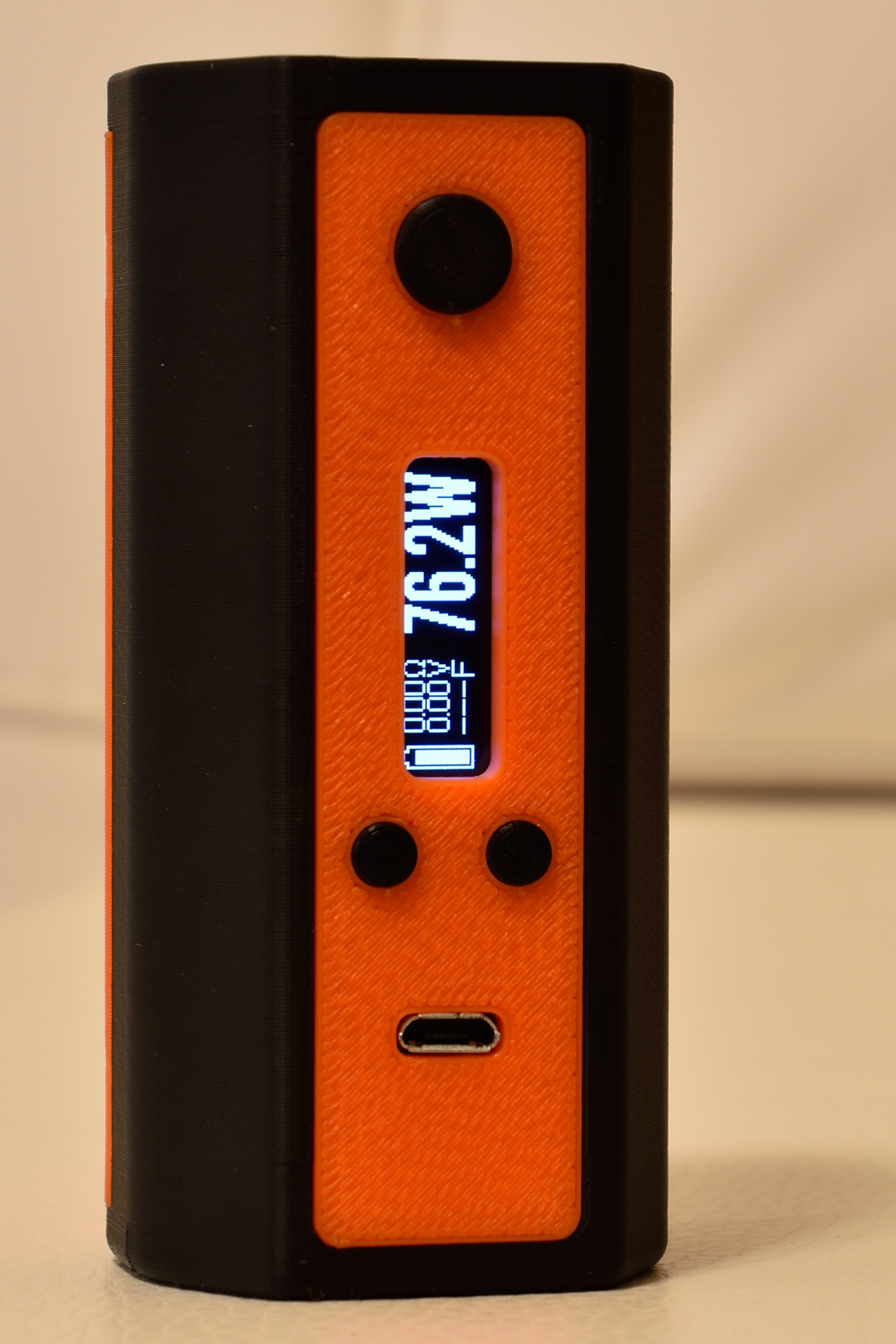

  3. Another one, limited to 133w (dual 18650). Here mine project: http://www.thingiverse.com/thing:1560323 Some shots:

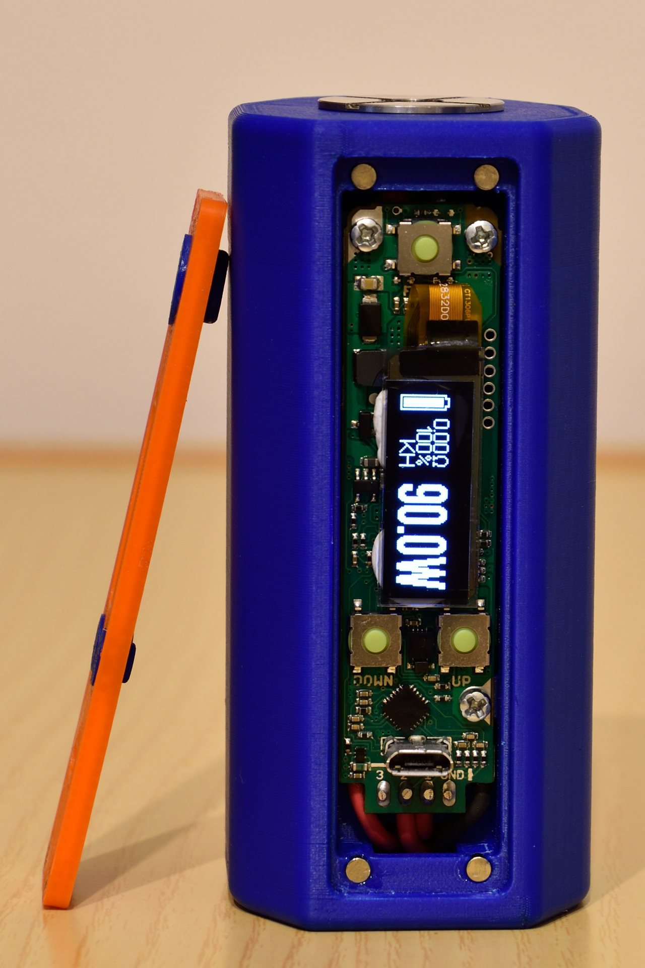

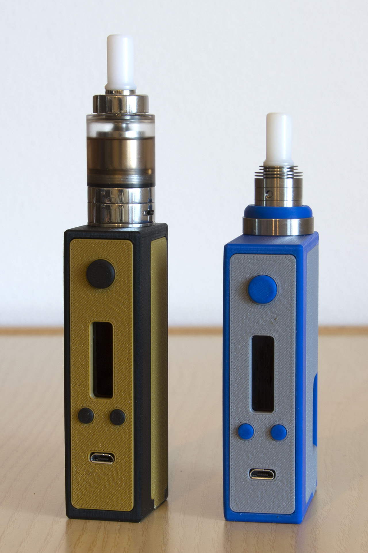

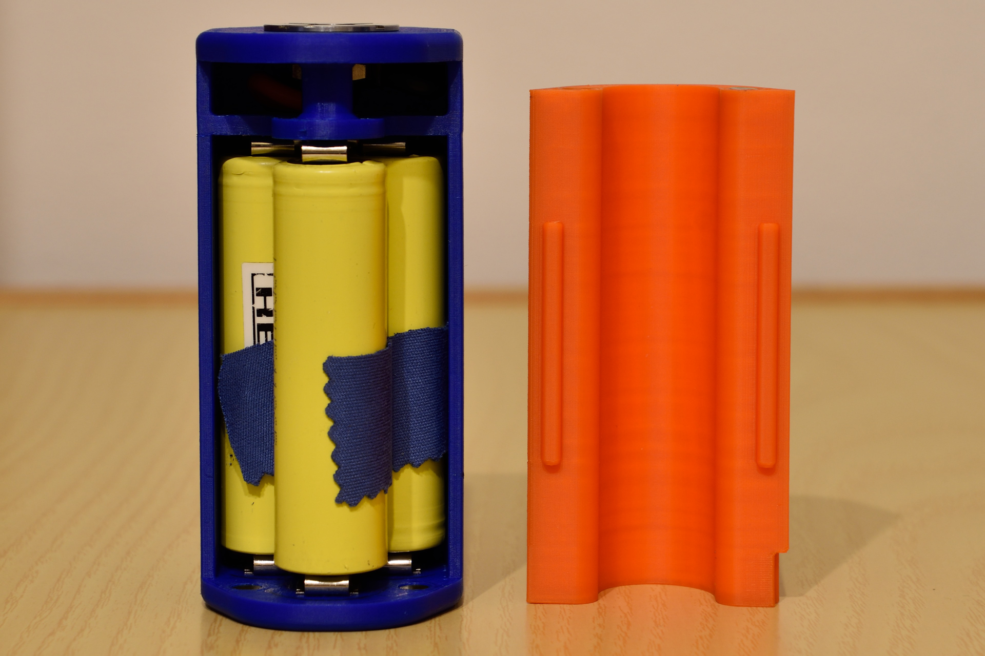

  4. The last one (3x 18650), here mine project: http://www.thingiverse.com/thing:1556748 I used this wiring scheme: /topic/67414-topic/?do=findComment&comment=906611 It's a like a wismec clone (LOL).

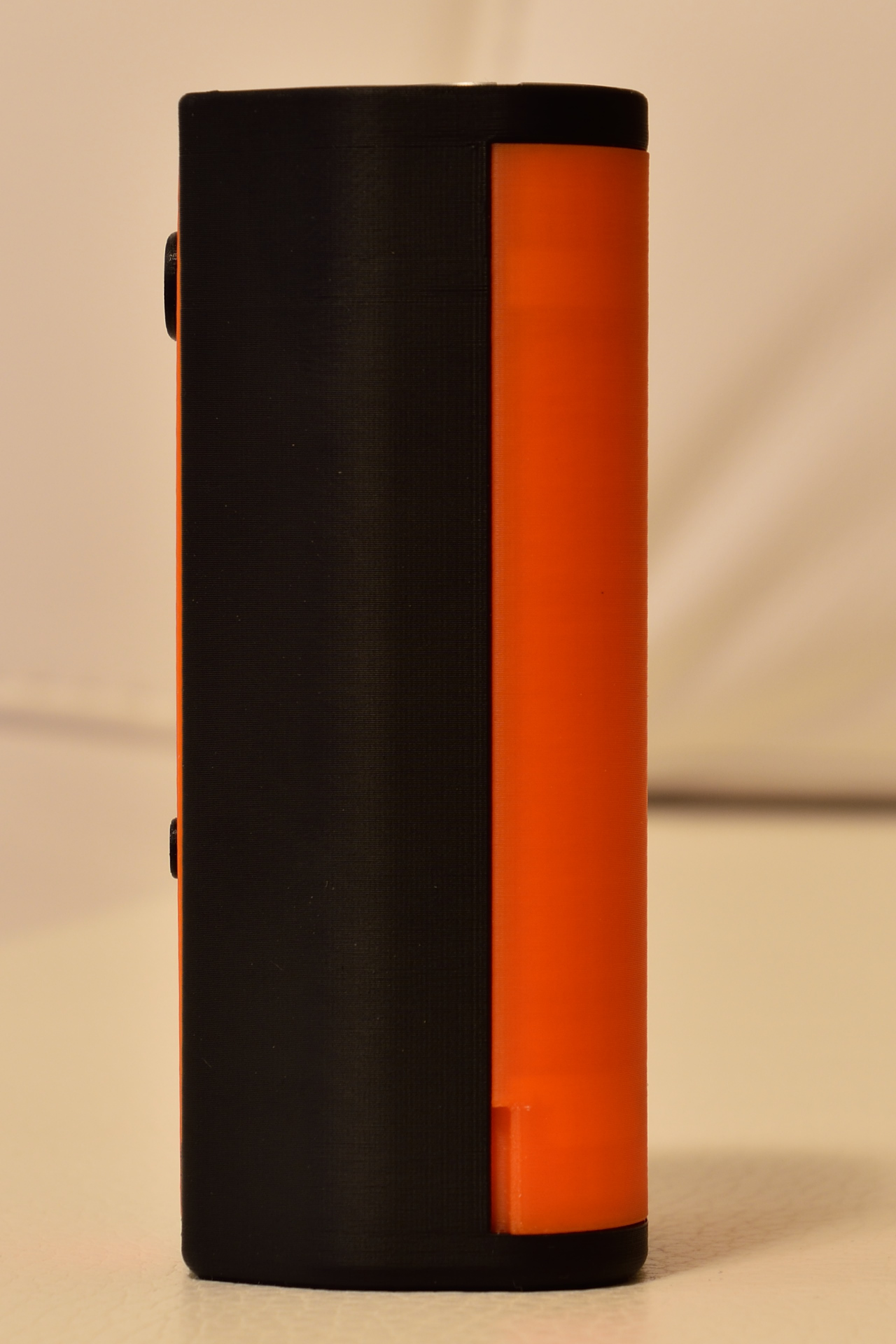

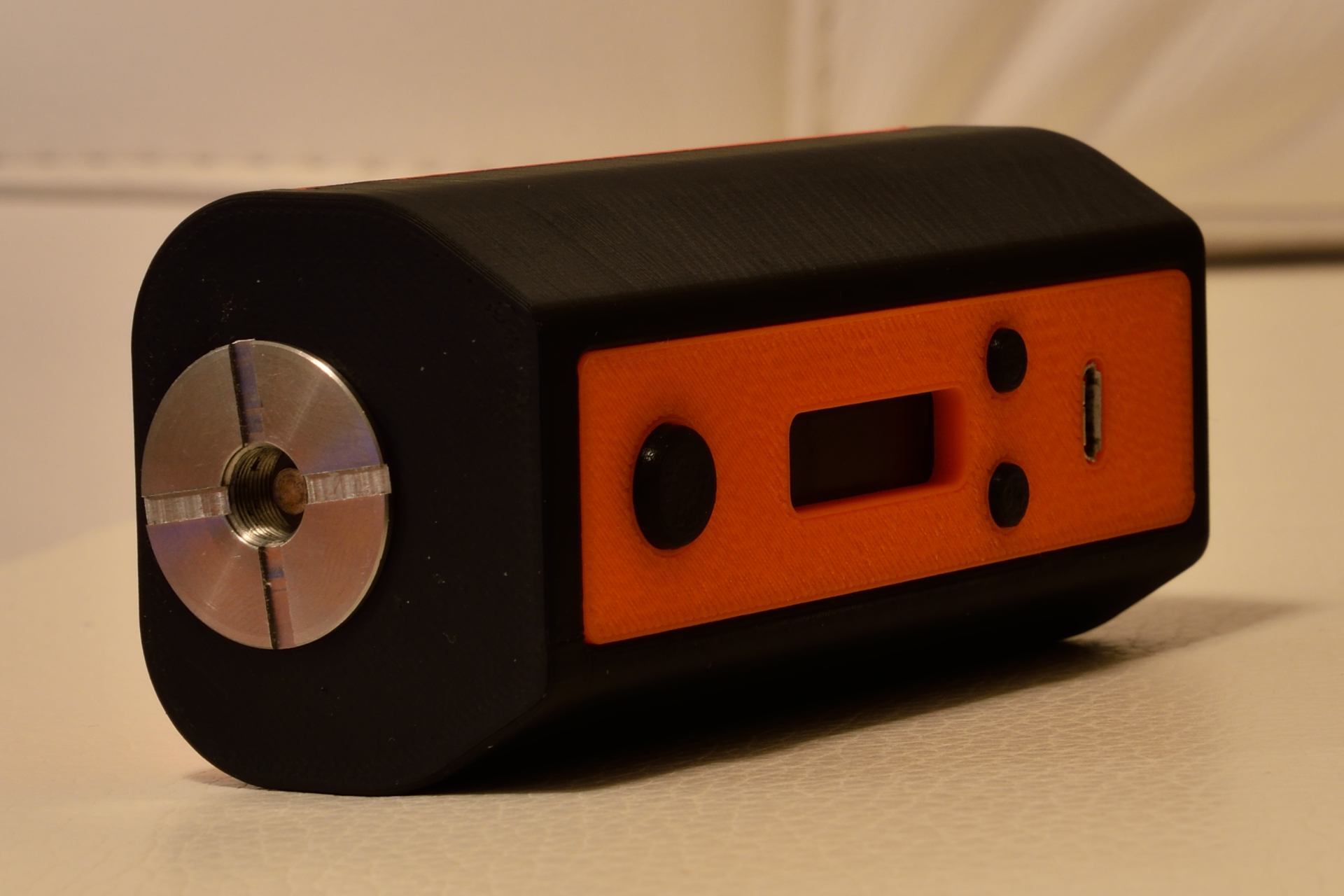

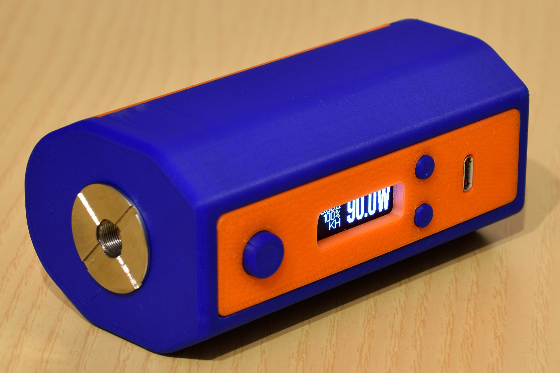

  5. My last one. It mount a Nanotech 0.95 mah 3s 25-50C. It's printed in ABS with a Z-M200. Size are: 48x94x25. Totale space for lipo is: 32x76x21. Here mine project: http://www.thingiverse.com/thing:1530128 Here some shots:

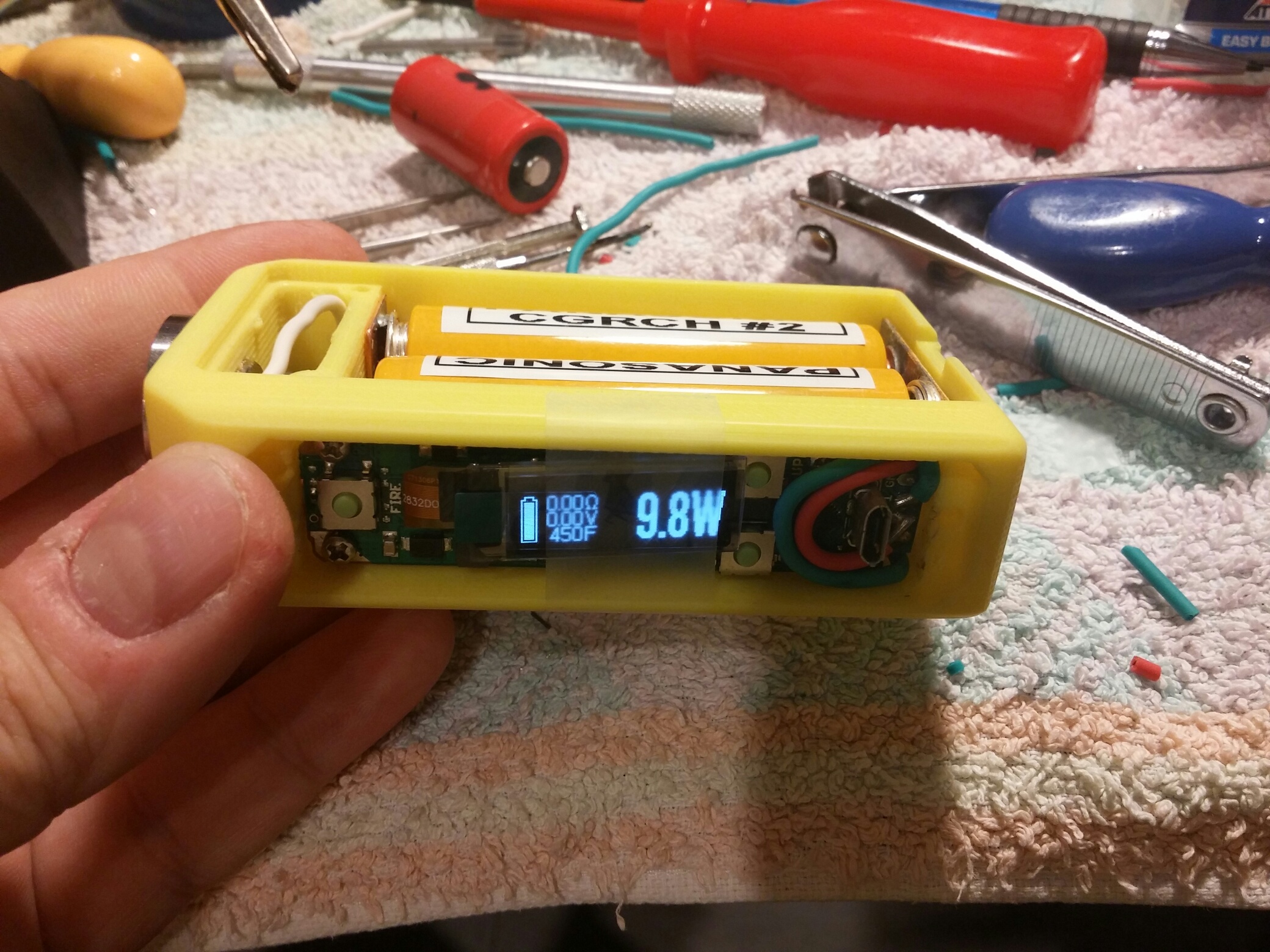

  9. Mine U can download here: http://www.thingiverse.com/thing:976359 It's 94x52x25 and with 2x18650 weight is 180 gr. It's in PLA.
  10. Thank to the guy of post #66 ! If someone has a 3d printer here the project, i think to release it in a few day: http://www.thingiverse.com/thing:976359
