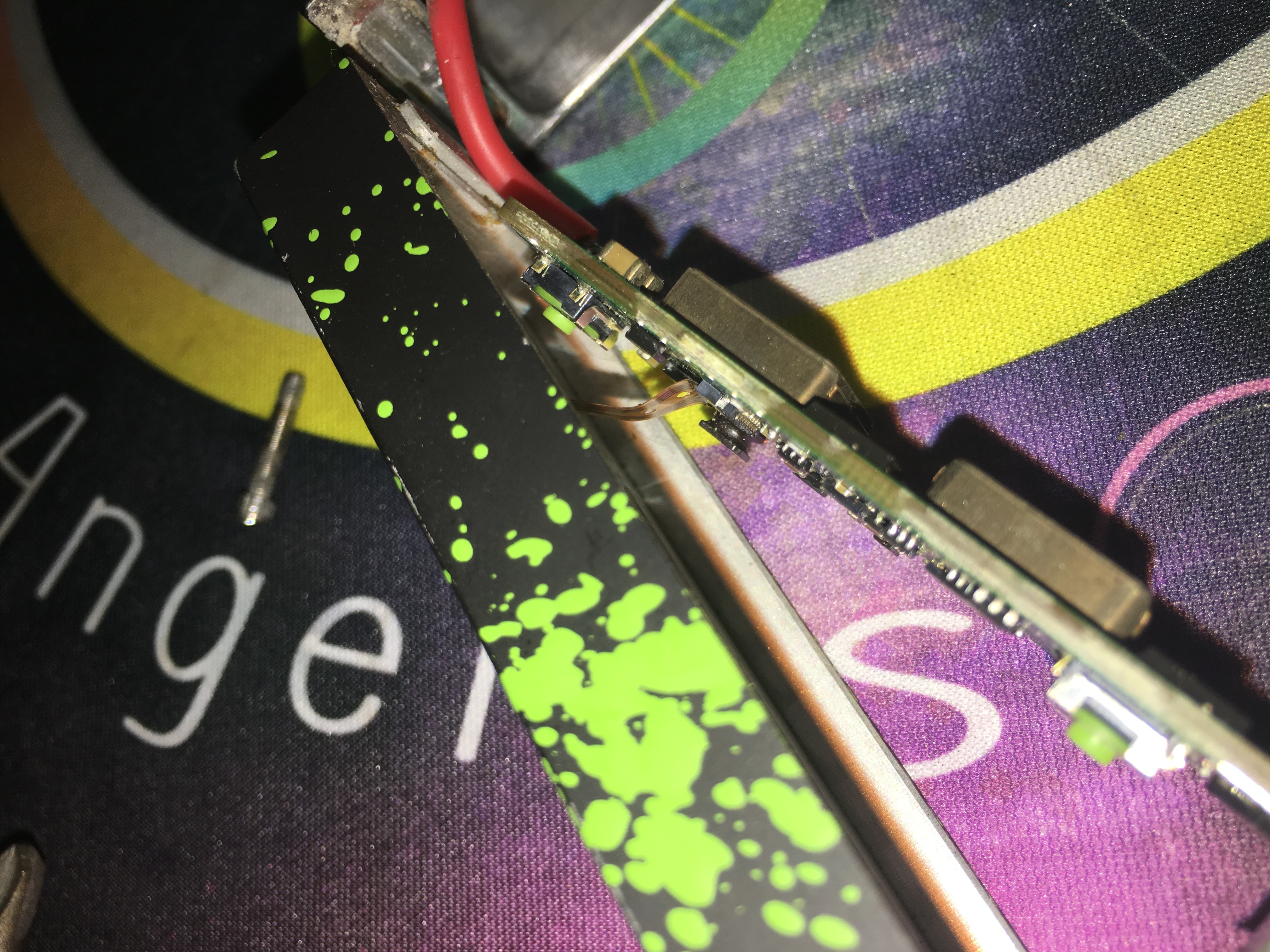

  6. One of my screws is a little Stripped! And one more question. It looks as if my ribbon to the screen may have been laying right on the fire button I've heard before that's a no no

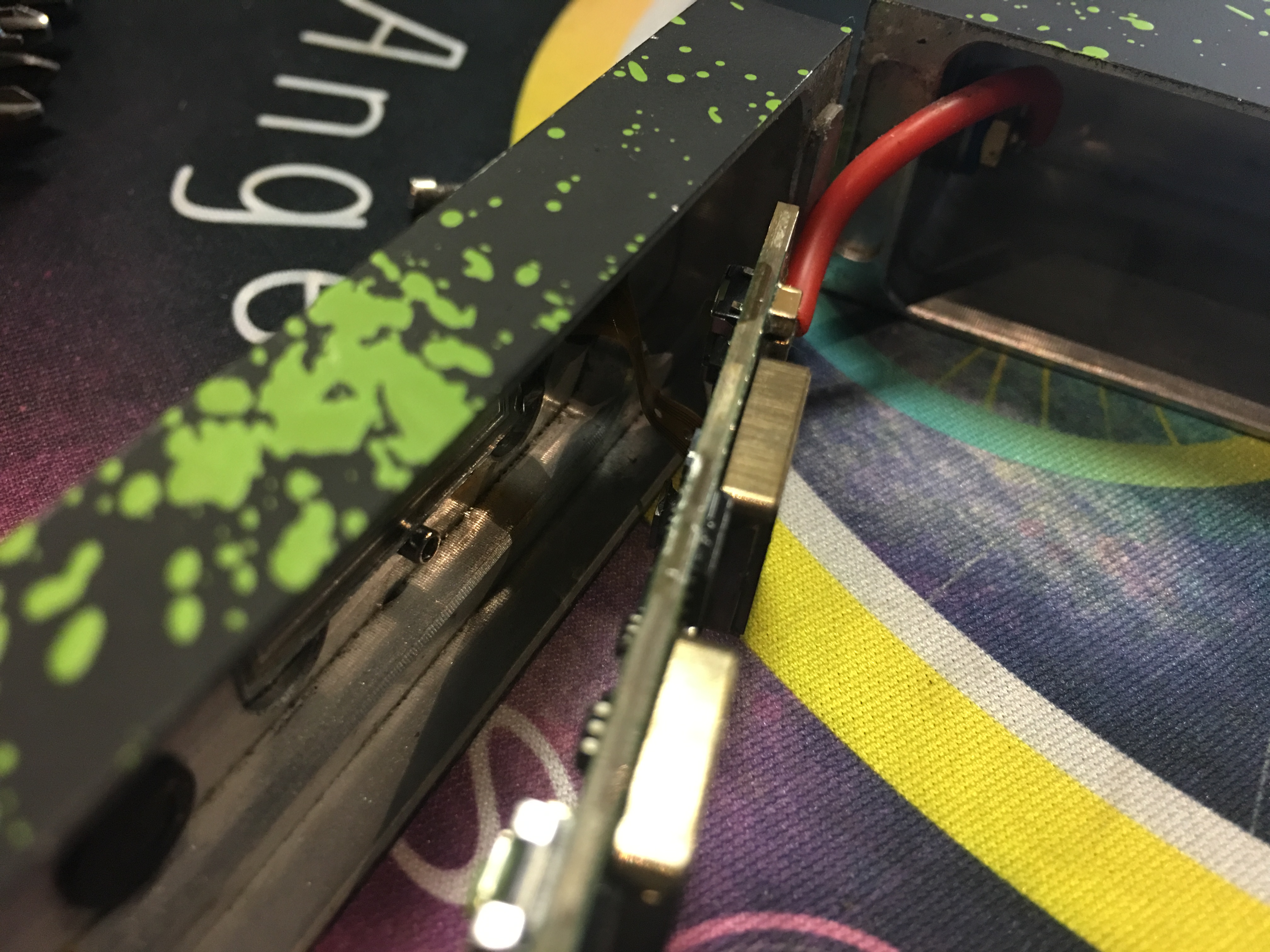

  7. My bottom screw near the up and down buttons heats up as I press the fire button. The mod works great in just a little worried as to why a screw is heating up lol. That must be the ground. Love the box and hate to trash it but the thing is a nightmare.
  8. Well upon opening up this morning I realized there isn't even a ground wire connected to the board just a positive wire going to the 510 no ground at all
  9. The center pin on the 510 seems good, nice and springy but not overly soft. This mods been a nightmare honestly... I even popped it open and looked at the 510 on my initial problem and it looked fine to me. Note: idk if that is the actual resistance, I tried the normal .007 and it still didn't read or perform correctly, I read on another forum that a guy with the same problem had an IR of .12 and it fixed his problem. I just don't have a calibration tool atm
