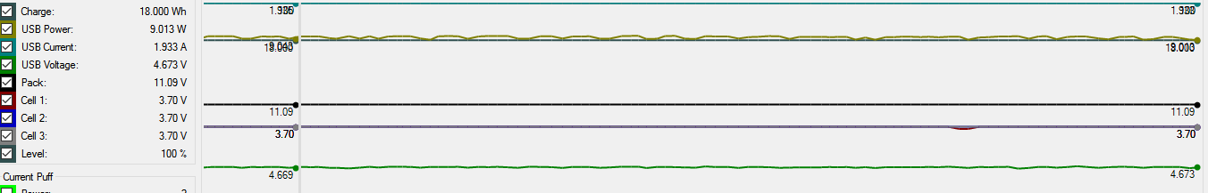

  1. I did order Fullymax with 900 mAh.
  2. I don't know what i'm gonna do now till new battery arrive and test it again.
  3. my laptop has both USB 3.0 and USB 2.0 and i connect on USB 2.0. i'm also tried connect with lavabox DNA200 on same USB port and and it doesn't read over 1 A. and No,there is no juice around the USB.
  4. Thanks for reply im using vtbox200 V3 i don't know it would be find or not. I tried using an iPhone wall charger which is 5V 1A the device still shows over 1A like 1.7-1.8A its impossible that iPhone wall charger can charge over maximum.
  5. i connect the box on my laptop and it shows USB current about 1.9 A then i tried using 5 V,1 A wall charger and again the device still shows over 1 A i don't know this is a bug or not and i hope it was just a bug on 1.2 SP3 now i ordered a new battery to try again soon i tried downgrade to recommend version of EScribe and still same what should i do ?
