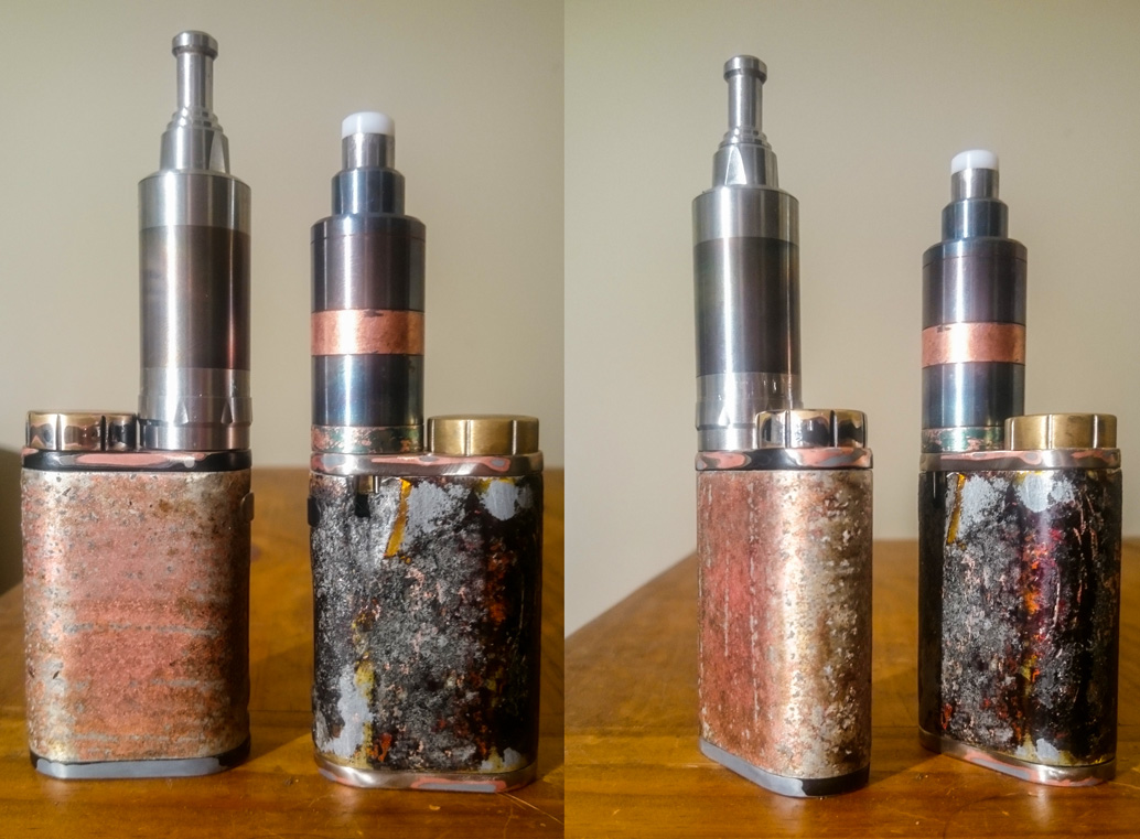

  2. Thanks Awsum. So something like this? http://www.digikey.com/product-detail/en/c-k-components/7211MD9ABE/CKN1491-ND/483870 As for current, I have a Melo 3 mini, and vape it at 50.6W/3.7V and have never gone over 13.x amps. Everything else I vape is between 15 and 25W at 3.7 to 4.2 volts (I never go over 4.2 or under 3.7), i.e. not 'hot'. I don't really want to throw a rotary on for "atty toggling" because it loses a bit of the cool factor to me lol. I've also come to the realization that I want to build two triple-attys, one mechanical with voltage control, and one using just the DNA75. Ultimately, I'd like to build these for fun (normal, 1 atty mods), so right now I'm trying to build the crazy one in my head as a way into learning and having fun. As an artist, I've always wanted to build something beautiful AND utilitarian...just so I can patina the hell out of it lol. For instance, my Picos (yeah I know, kinda silly, but...)...

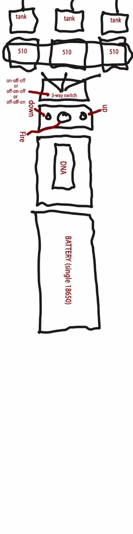

  12. Does this help...? I am not an electrician lol. Shawn
  13. Thank you, Chunky. Give me a moment or 12 to try and draw what I *really* want in Photoshop. Hopefully I can upload a pic here...BRB...must draw, then upload. Shawn
  14. Hi everyone, first post. Also my first electrical, and first mod, DIY. I suppose, to cut to the point immediately: I'd like to be able to trigger one of three atomizers, individually, using a toggle switch and a single battery (and hopefully a single DNA board). Simplified to the best of my abilities, I mean: Battery (fire button) - switch <- (510 | 510 | 510) ...where <- means left, middle, or right 510 connector is on, while the other two are off. In other words: purely mechanical (no DNA), I suppose that would mean: (tank) (tank) (tank) \ | / \ | / (switch) <[on-off-off] or [off-on-off] or [off-off-on] ^ (fire button) ^ (battery) Before I get into trying to do this with a DNA75 or DNA200, I guess I need to know if the basic setup (a battery with a switch that fires 1 of 3 atomizers, based on what position the toggle is in, is possible? I realize I have a lot to learn, and I'm willing to put the hours in. But as a creative person who no longer smokes or drinks (I quit both at the same time last month) I really need to focus my energies, and I have a mod in my head that I would love to see built in reality. Thanks for any help, Shawn
