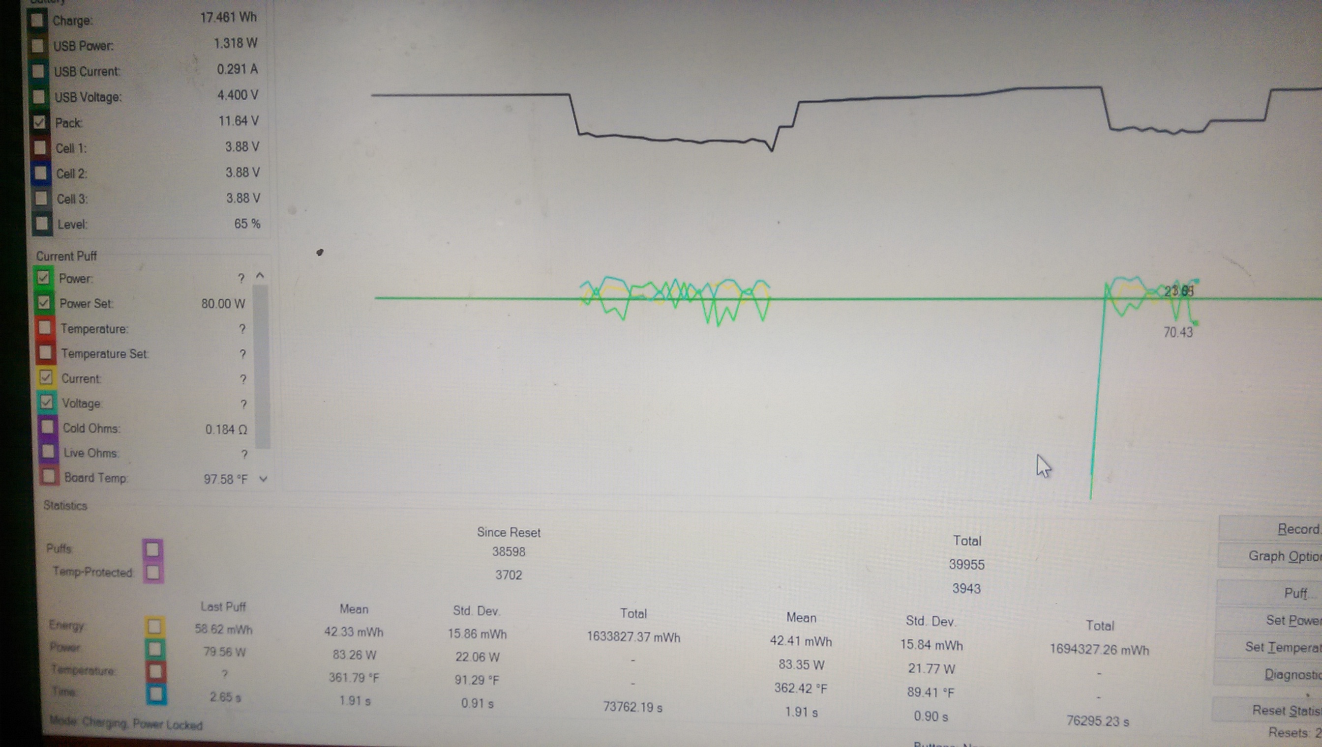

  11. i have the wismec dna200 using a griffin with dual fused claptons 0.18 ohm i have it set at 80 watts but when i fire it reads 79.1 watts i set to 85 watts and fire at 84.1 it is always 0.9 watts lower then what i have it set at also useing samsung 25r batteries i have three sets and this happens with all

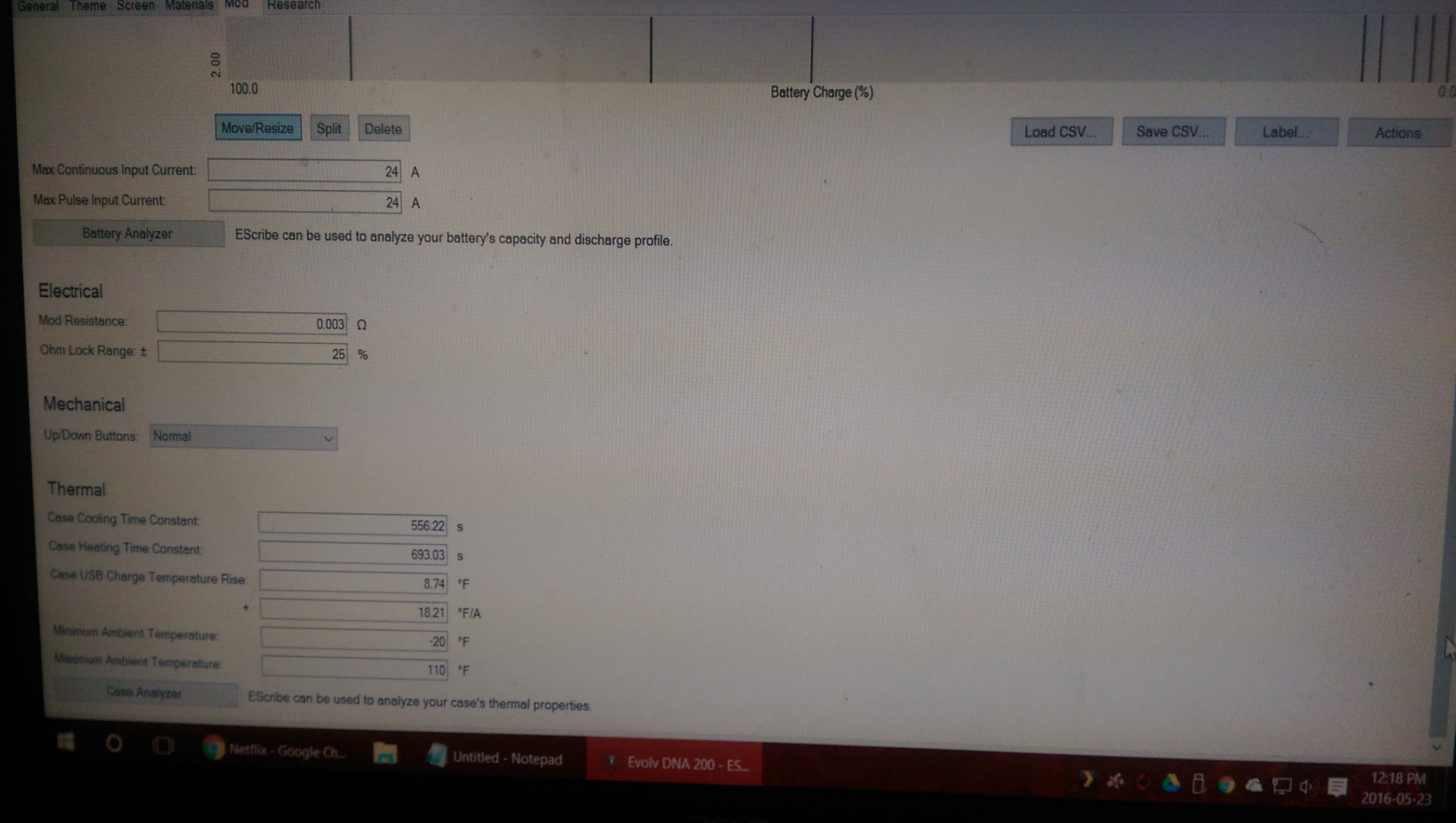

  12. i had similar issue with my wismec did case analysis and also did atomizer analysis for each profile setup and has since been no problem as to under power anymore hope this helps
  13. could not do screen capture so used phone to take pictures hope this helps

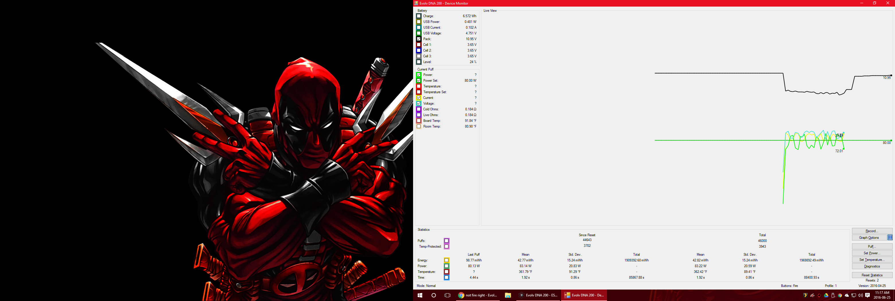

  14. it is the wismec rolo i will try and get a screen shot for you and i have had this mod for six months and last updated it a month and everything was fine untill yesterday when this started out of t he blue

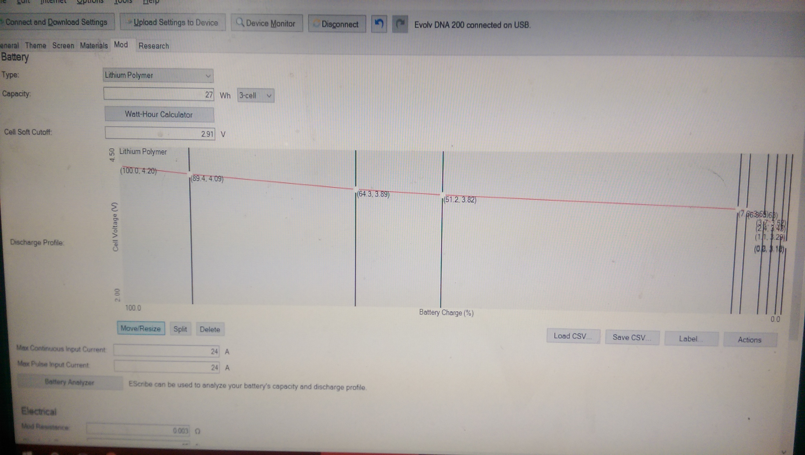

  15. today for some reason my dna is acting weird i have it set to 80 watts but when firing i will only go 78.2 watts on the screen and in escribe tried different attys and builds and different set watts no matter what it always under fires at average of 1.5 watts then what i have it set at i am using the wismec dna200 with samsung 25r batteries and it happens with all three sets i have
  16. it does this with freshly charged batteries (sam 25r green )i have read thru what i have been able to find on here as for voltage i am firing at 5.43 volts at 100 watts i have also did a case analyst as well as atty to correct for resistance i have just become lost as what else i could do
