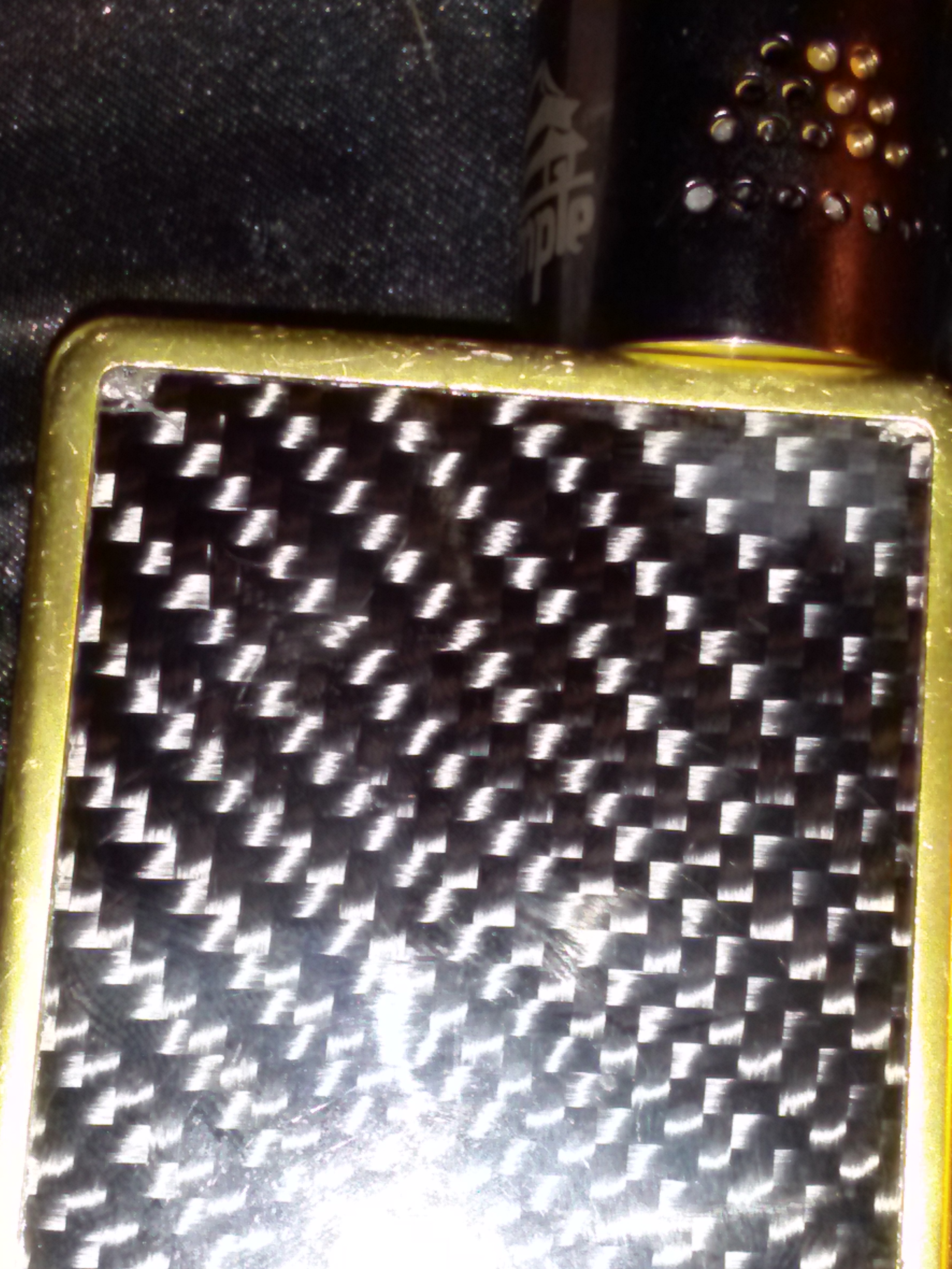

  4. Thought my problem was solved appears it isn't I opened up the side panels to find a cold solder joint on my 510 ground ground just let go guess I'll try to fix myself unless evolve will fix

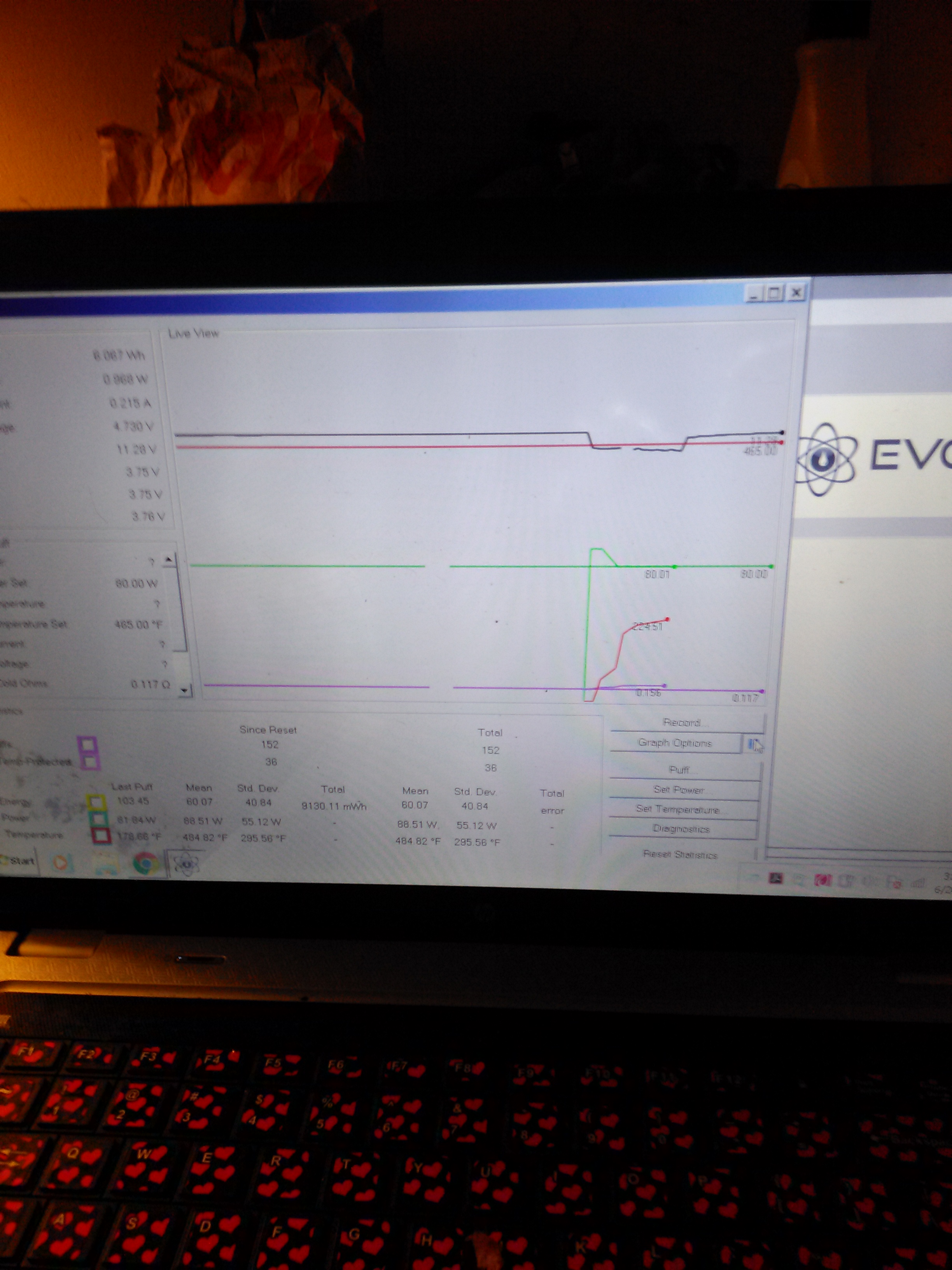

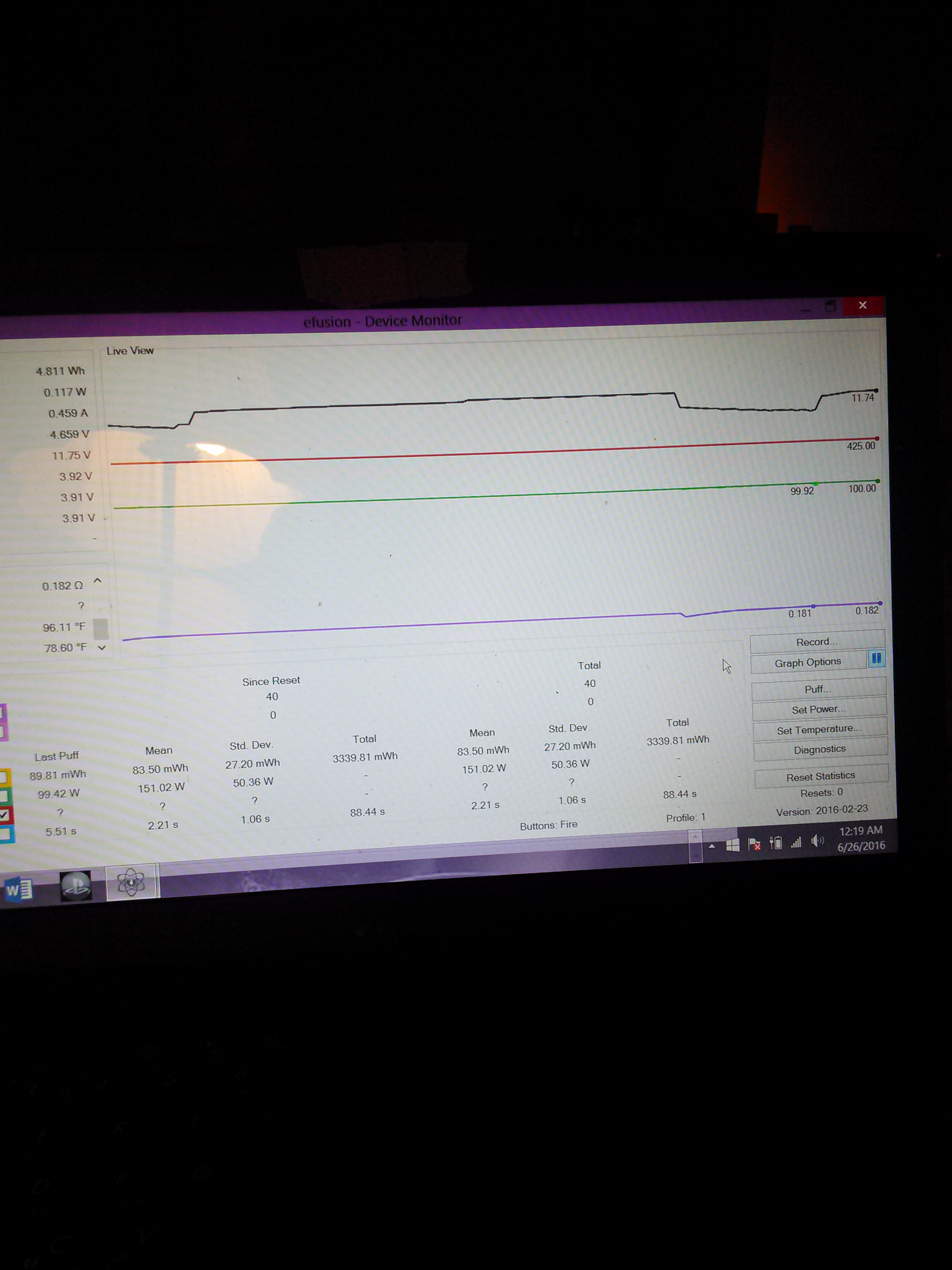

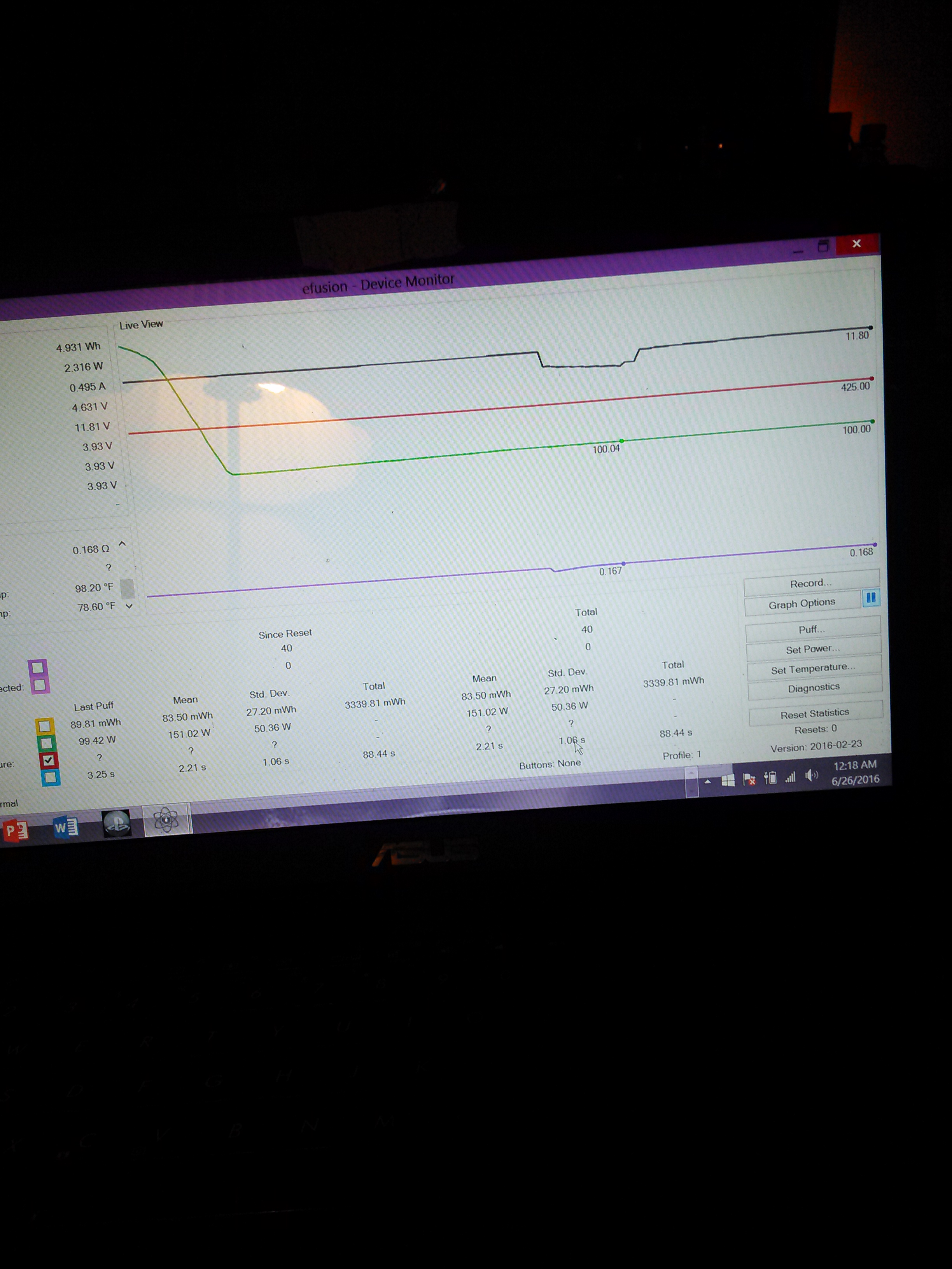

  5. Btw uploaded my vt200 mod settings at .003 mod resistance and same case cooling 287.72 Heating 301.48 USB charge 9.26 10.52 Min ambient -20 Max ambient 110 It's spot on even better then efusion ecig profile Atty ohm reading is perfect everything perfect Battery analyzer ran came out to 14.316 better battery then in my vt200 but still get about 4-5 hours bout half hour longer then my vt200
  6. It's fixed you guys were right opened up box messed up carbon panels a little but it was some gunk in the 510 took apart cleaned put back together is working like a charm... as you see side panels chipped corners alittle but who cares my mod is working again woot woot thanks guys
