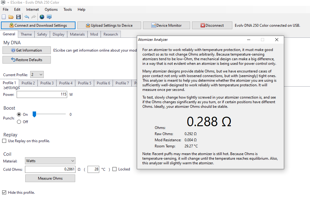

  1. @BillW50 @dwcraig1 Hi mates Issue resolved. I dismantled the board from enclosure and took out the 510. The spring of 510 was not what I expected in quality, so I replaced it with my extra Source V3 M10 510 Connector spring. Now mod is working without any issue. Thanks a lot for your kind suggestions
  2. @Wayneo I was exactly waiting for your comment. Because after taking screen shot, I looked to profile and then I changed it to profile number 2 and there again I run atomizer analyzer. The same issue observed. So I don’t think this would be a profile change and analyzer issue. Issue still persist and as you can see from device monitor, cold ohms are unusual.
  3. @WayneoHere you are mate
  4. Hi @Wayneo Yes I did try different atty. The same build on SC V2 plus and SC Ragnar installed (Dual 6 wraps of 26*3/36 in 3.5 mm Ni80 Fused clapton) and those atty's have different 510 leg length. No changes has seen. But DNA200/250 show exactly the same cold ohms. I even tried to check the 510 connector center pin and wires to DNA250C board, checked for cold soldering, but everything seems ok.
  5. Hi @BillW50 Atomizer analyzer saying 0.21 until 0.24 which is fluctuating and never stopped accurate. But as I told before, the device monitor shows live ohms accurately and cold ohm much higher. I was using mod stock theme, i even changed it yesterday to Gauges theme but no changes. I will update to Frank65 theme (hope to find it in download section) and will update you.
