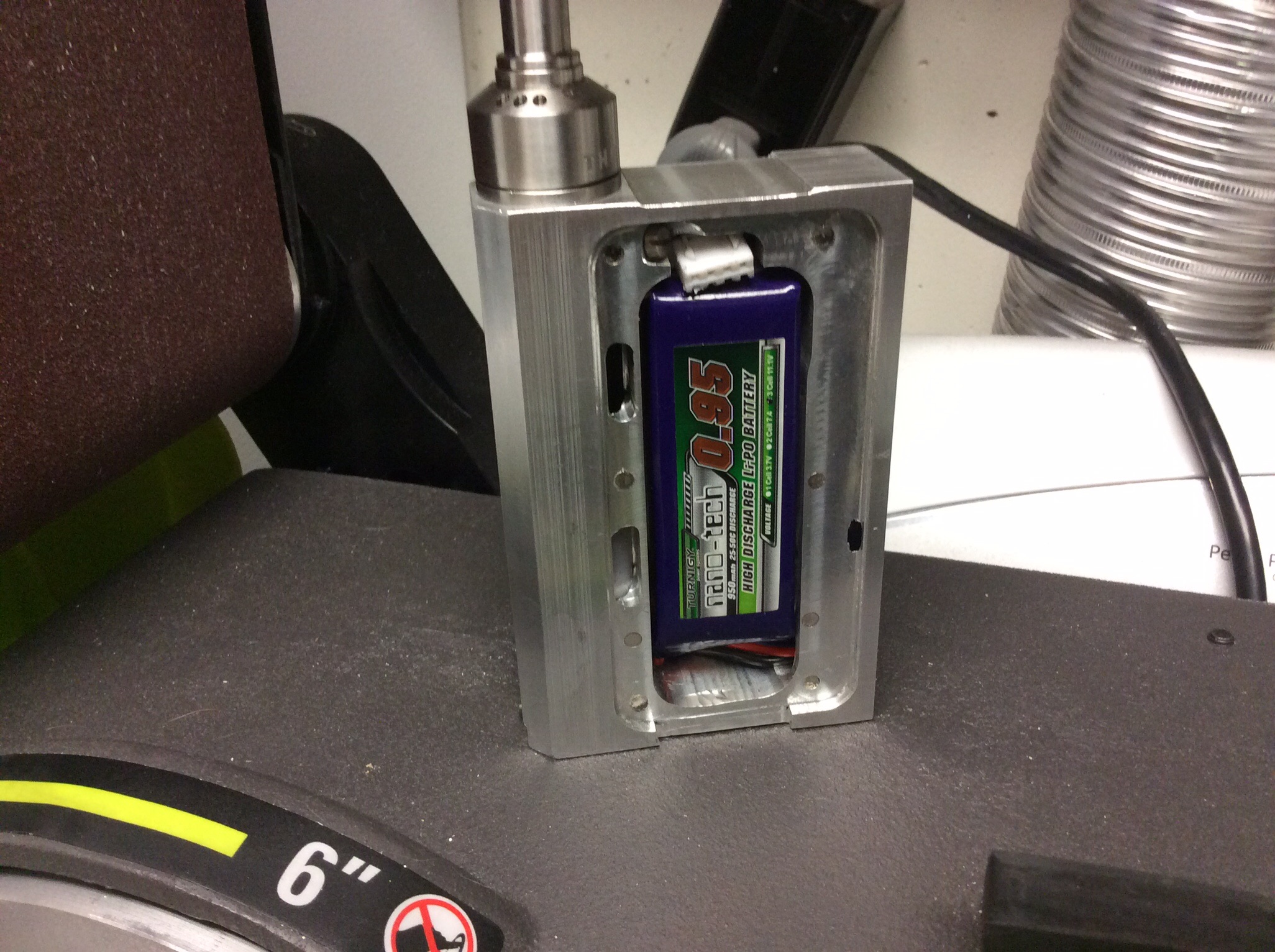

The Catfish Atty Mods DNA200 Squonker. Turnigy .95 Italian 8.5ml bottle Milled 6061 Carbon fiber all over Pics below are of the 3D printed proof. These are currently in production and should be available in anodized aluminum in late April.
