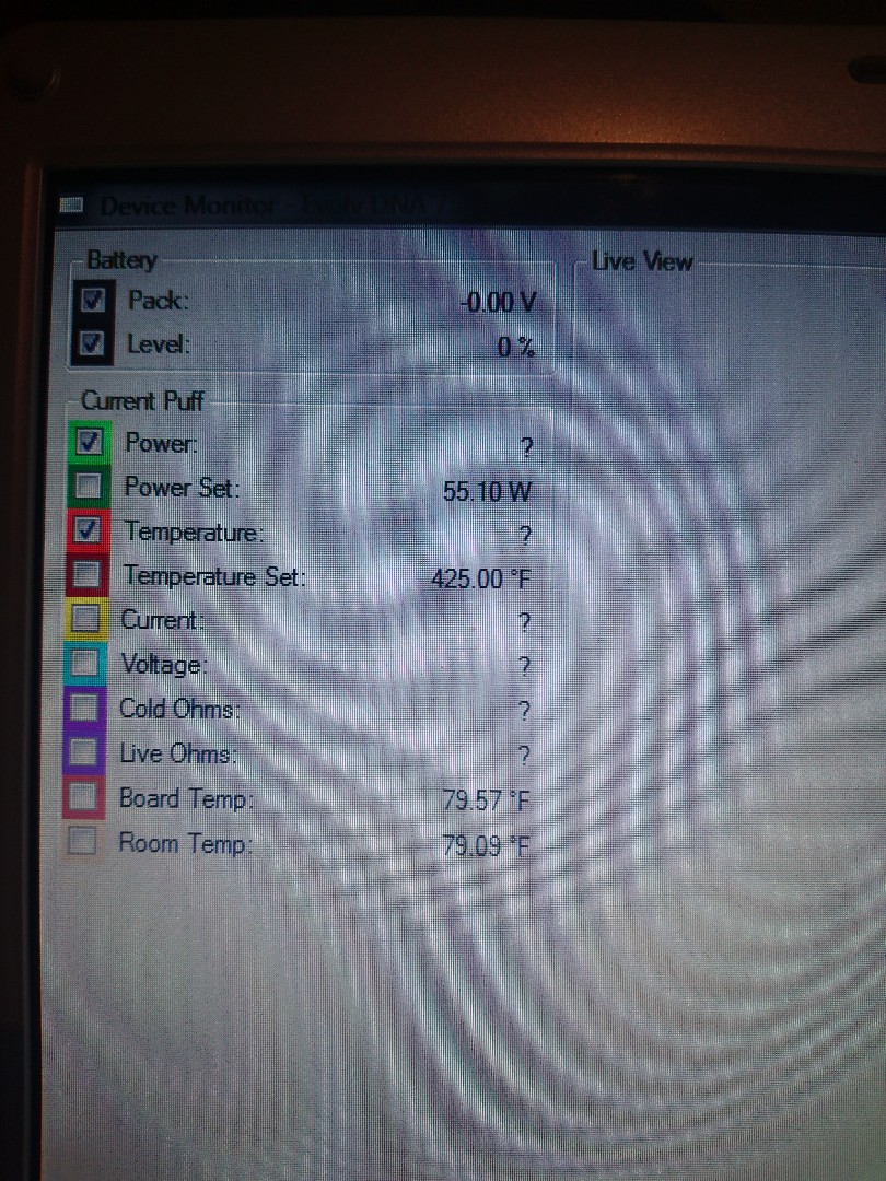

  1. Well, I was going over it again and ripped a part of the green cover on the board. Blehg.
  2. It reads 4.2 across all three posts of that mosfet
  3. I even tried switching connections around! Maybe something fried somewhere. That's my only thought
  4. I made sure it wasn't in lipo mode, check thresholds and for draw, can't find anything out of the ordinary
  5. That is correct.
  6. The device monitor shows nothing all, it cannot read the battery. And like I mentioned, the board is getting proper voltage.
  7. I'm new to modding and I am messing with the DNA75. I have it wired up in parallel with fresh batteries (VTC4) and it keeps showing check battery. I have checked continuity throughout the board and the board is getting the true 4.2v. Atty side it shows maybe .1 Volts. I have read that there is a fuse in the DNA200 that would blow, causing a similar problem, But I have also read that the DNA 75 does not have this fuse. That being said, I bought the board in working condition in a moonshot box and I de-soldered the connections and re-soldered based on the Evolv website. Not sure where to go from here. Did I fry something?
