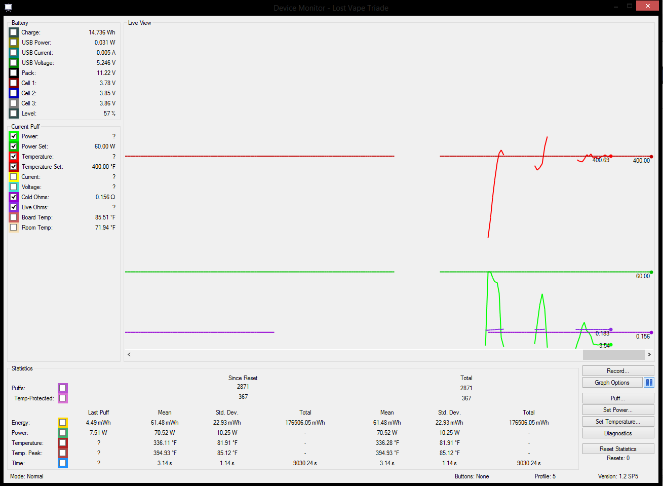

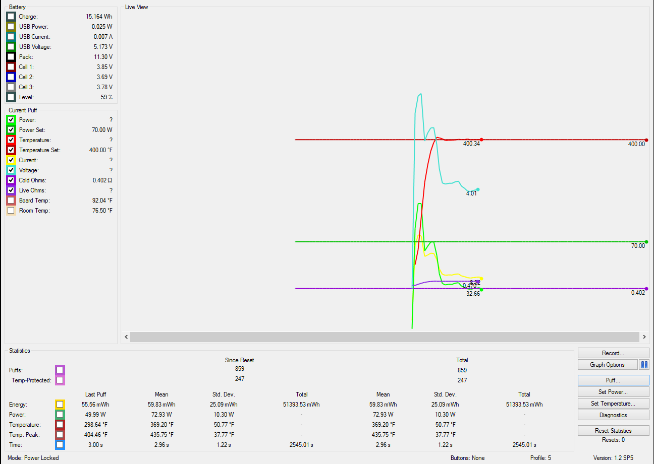

  2. One more screenshot:

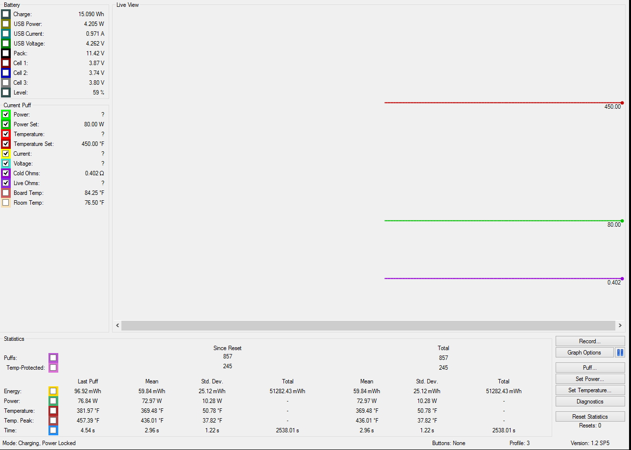

  5. I'm trying to use temp control on dual SS clapton coils and for some reason I never hit the temp ceiling I have it set at. Maybe I'm just reading this wrong. If you need any further info just ask!

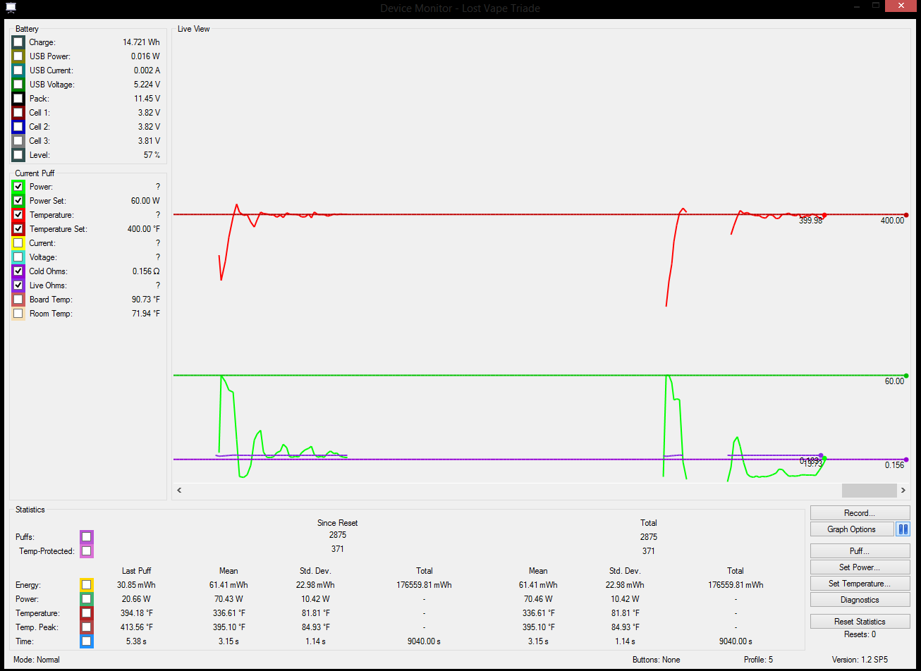

  7. Here we go: Oddly it appears to be working now... I'm at a loss

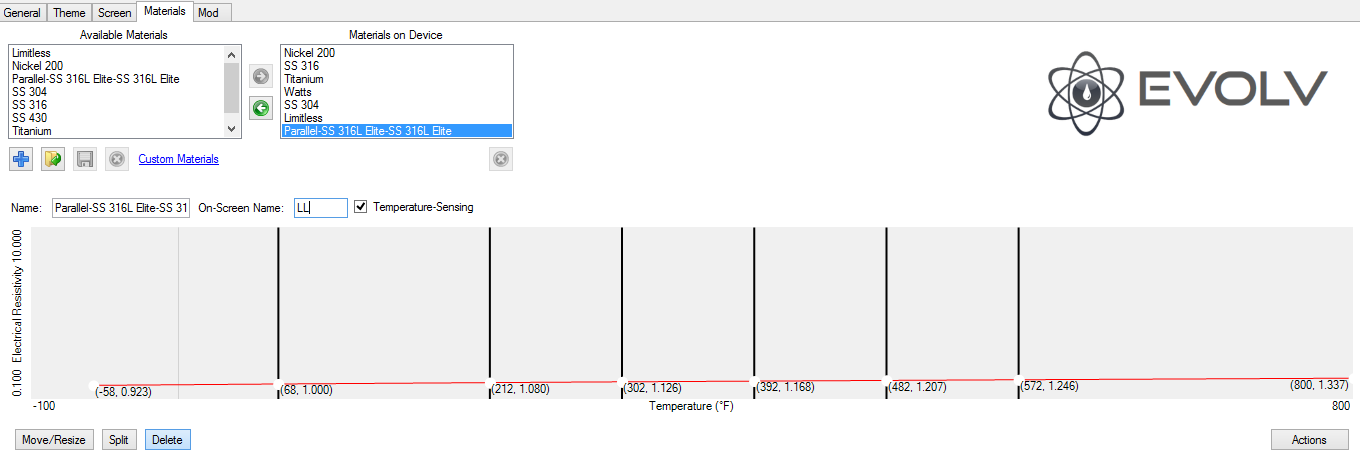

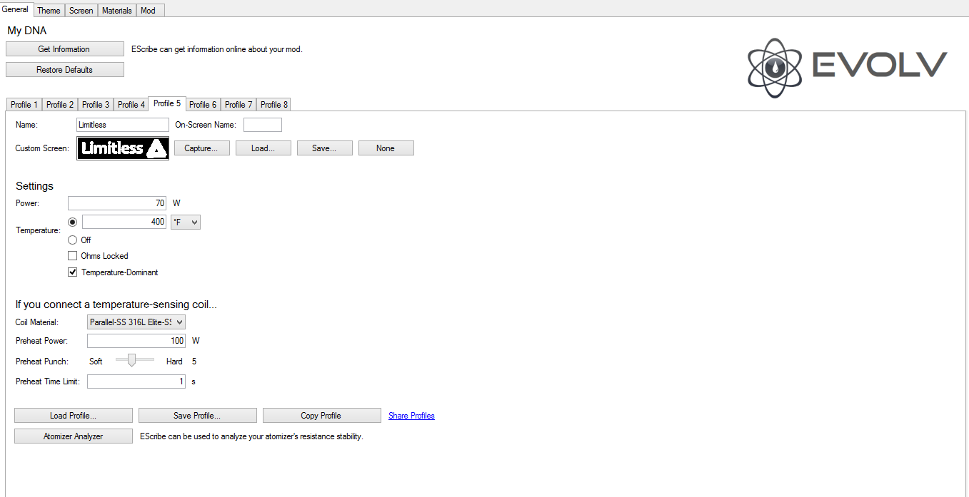

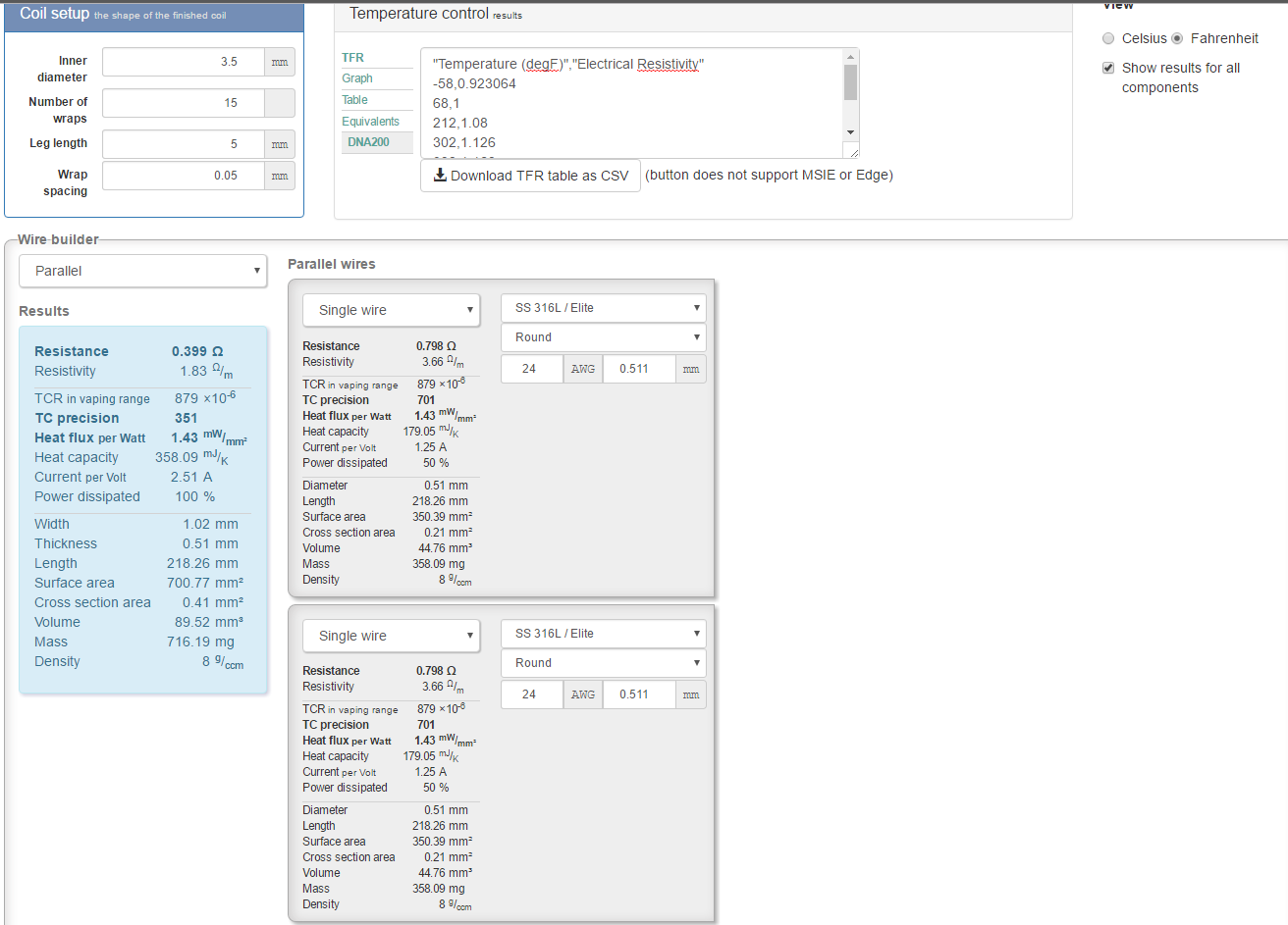

  8. But with the same pre-heat settings for the default 316 profile it works just fine
  9. It doesn't seem to be detecting a temp. at all
  10. I guess I'll just use the pre-programmed 316 profile. I still don't understand why it's not sensing the temperature though.
  11. Something that's odd is when using the profile, it shows volts, but the main stat it's showing (in the big letters) is the temperature.
