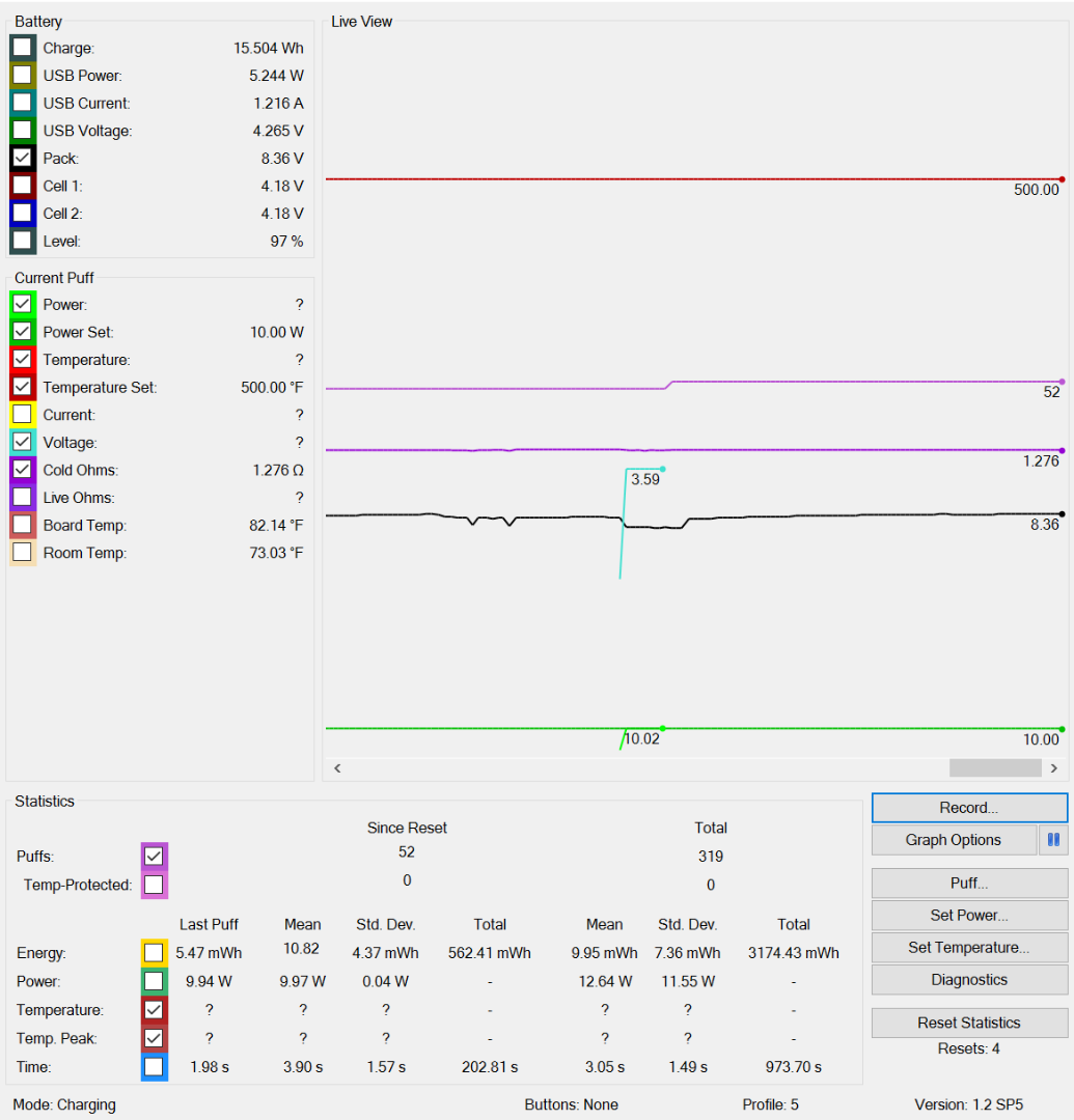

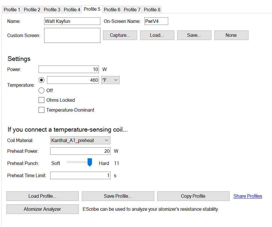

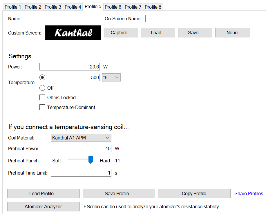

  1. Yeah that is an easy problem. But I am building my own coils which means I need to repeat this procedure everytime I change the coil
  2. Not yet it only increases to usual value just as before
  3. I have started to try that no luck so far but I have realized that after the first fire ressistance returns to its actual value instead of the value I have overwritten locked and uploaded, So this means even if I have found the right value I only works once. Also this is a very painful process to go over after each coil change.. Is there really no easy way to use preheat on Kanthal????
  4. After manually adjusting resistance and locking it do I need to upload settings to device? And then Do I need to lock resistance on device? If I see that the graph shows real temperature this means that I have finally achieved it right?
  5. Tried that too no luck
  6. You mean instead of 0.1 increments starting from 392F for example try 0.15 increments?
  7. Clearly not for Kanthal users.....
  8. I have read all of it and disabling preheat is not a precaution I can still set a 2 ohm kanthal wire to 167 watt and burn my throat or some crazy stuff like that to harm my self.. But I can not give 15watts for 0.4 secs to a 1.2 ohm wire which I use on 10W. there is no logical explanation behind this silly limitation. On developer manufacturer mode you can make more dangerous adjustments but restricting preheat on kanthal??? I am sorry but that is just a poor excuse.. SS wire has a too low resistance for me. I am a MTL person and I need resistances around 1.25 ohm. Also even limit SS temperature on TC mode I really do not want to have Ni in my coil
  9. I've tried it and it's not working My decice is on SP5 firmware does it affect it? Please help me to activate preheat somehow
