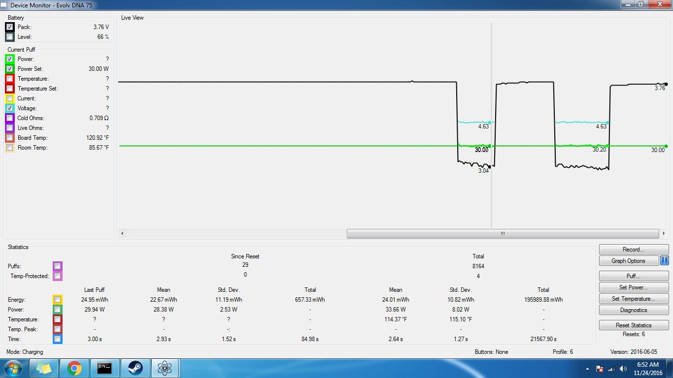

  1. what i understand from the device monitor is it was firing the right wattage output from the start? right? but my lcd shows it is firing first at 27watts for .5 to 1sec i think before going 30 watts
  2. thx for the response here is a screenshot.
  3. im new to DNA device and decided to have a HCGAR VT75nano, the problem is. after some tweaking (for the weak battery warning) ive notice that when i fire my device at a certain watt (Power/wattage mod) it doesnt fire accordingly to my desired setting, Like When i put the watts to 30watts, when i press the fire button, it will fire at 26watts first like .5 to 1 sec then it will fire at 30watts. is it normal? and the warning message (new coi/ resistance Yes or no?) everytime i put a new coil or atomizer is gone. can someone help me understand this. if its normal or something is not right. thank you very much.
