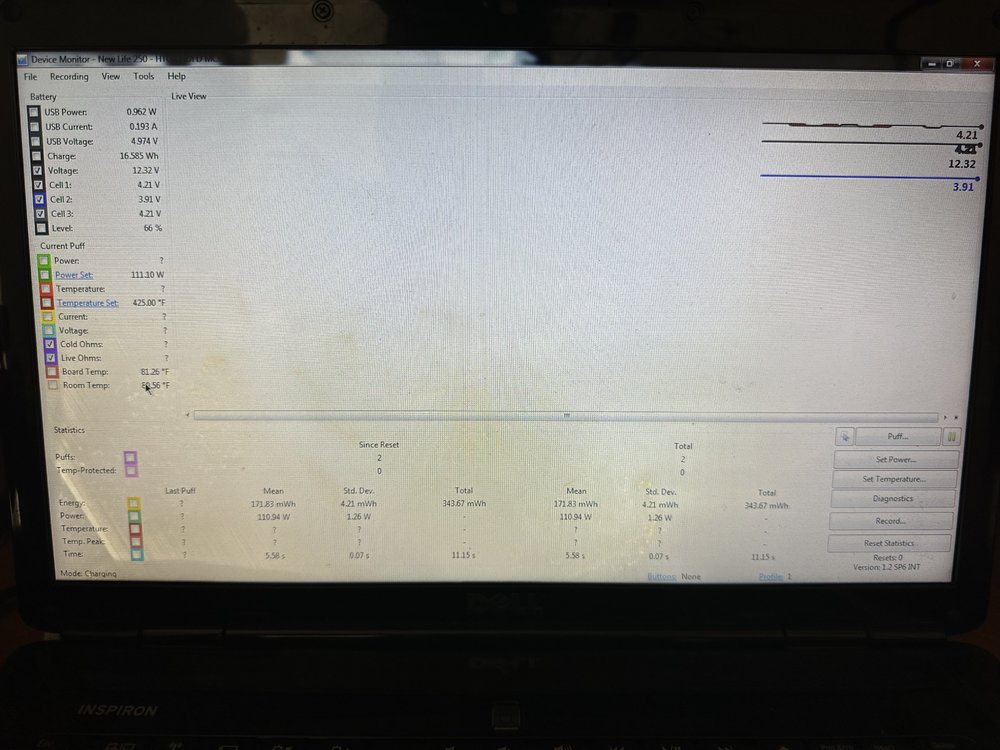

It was on the charger for 8 hours at least. Once it hits 66% the charging icon disappears. And just shows the battery. Like it thinks it's full. Photo is on the charger, with icon not showing charging. It is balance charging, yes, but that cell won't go over 3.9. How long should I expect a 2250mah pack that arrived balanced to fully charge all 3 cells to 4.2v? Thanks for the help! -
Put a new battery in this mod, Maxamps 2250 3s, 25 watt hours. Had it on the charger all night last night, this morning battery says 66%. 2 cells show 4.2, one shows 3.9, and pack charge is 16 Wh. What gives? Did I get a battery with a dead cell? Are my settings messed up? Never had this problem.

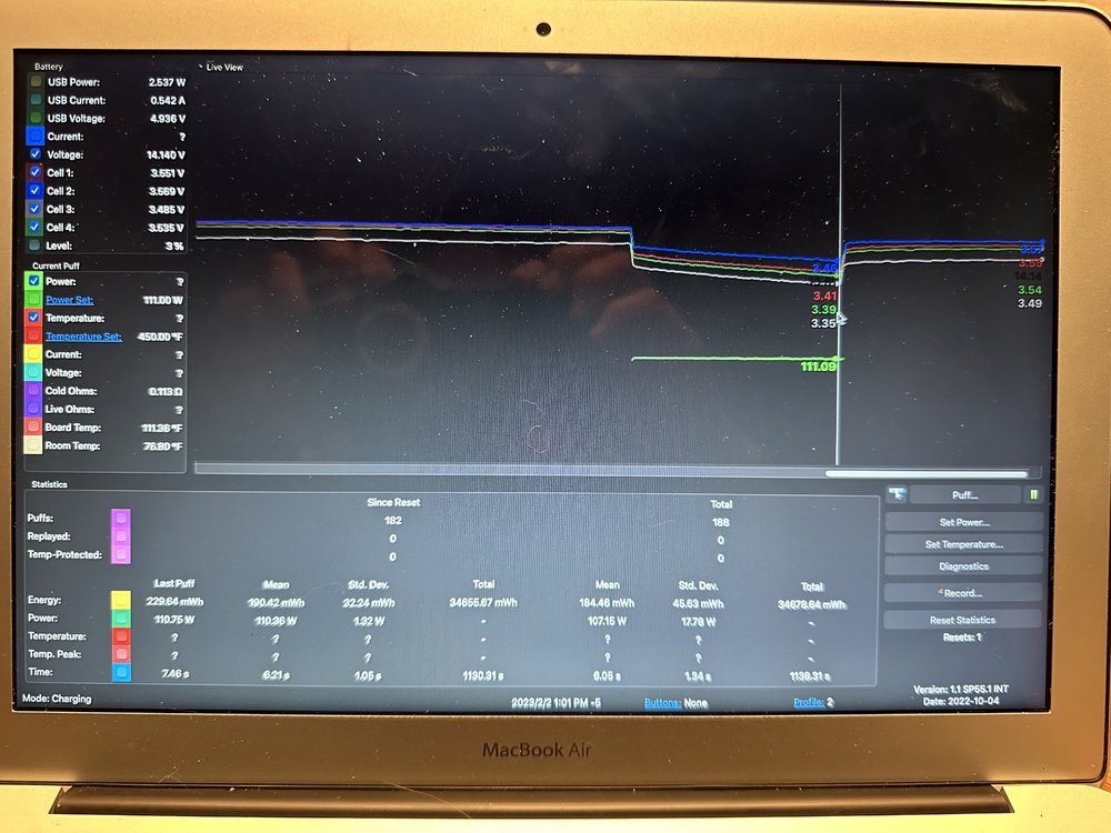

Yep, all I really want is an accurate icon - because it's cutting off at 0% when there is a not insignificant amount of usable charge left. Thanks! -

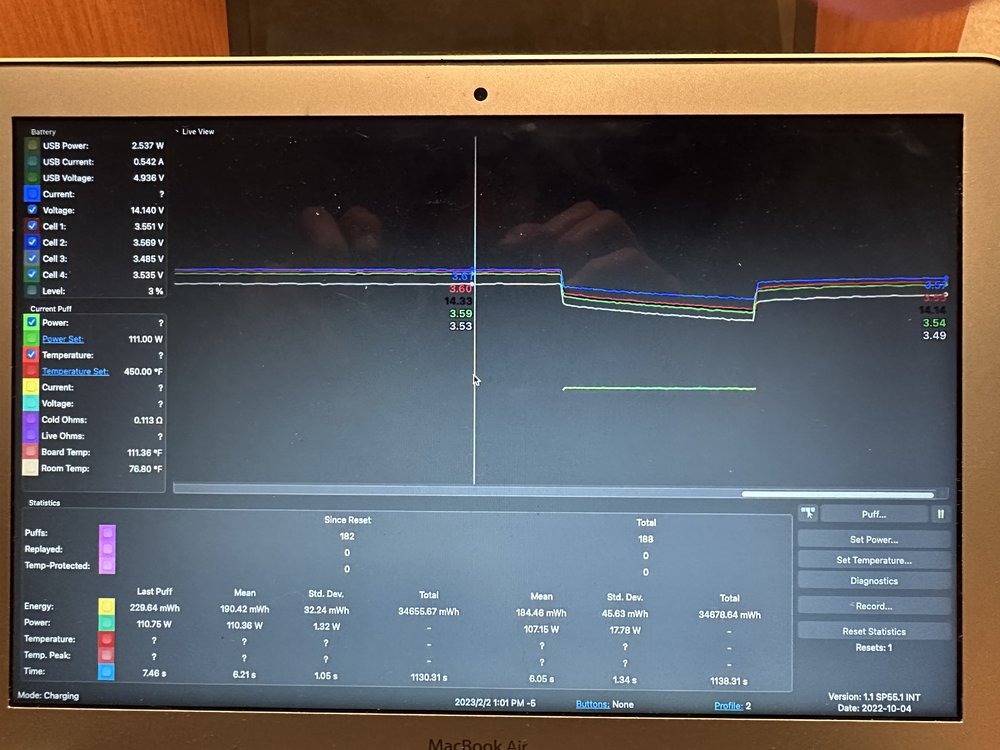

I just built a mod with a Maxamps 2800mAh 4s 100c battery. I'm at 2% battery right now. Hooked it up to device monitor and taking a drag - 111 watts, dual mesh coils at .12, 6-7 second drags - cell voltage is only dropping to ~3.5, well above cutoff. I'm not a battery expert - but I feel like I can be getting more out of this battery. Should I just be happy where it's at, or is there a way for me to modify the curve to give me that extra life? Thanks in advance.

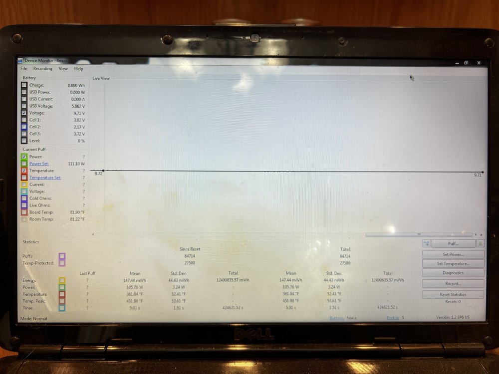

Replaced an old lipo with a new one. Exact same brand and model. Unplugged pressing the fire button the screen only flashes once and goes out. Plugged in and connected to escribe shows cell 2 pretty low. Also not showing any USB power or current. I'm confused, because all I did was replace thr battery. Applied most up to date service packs already.
