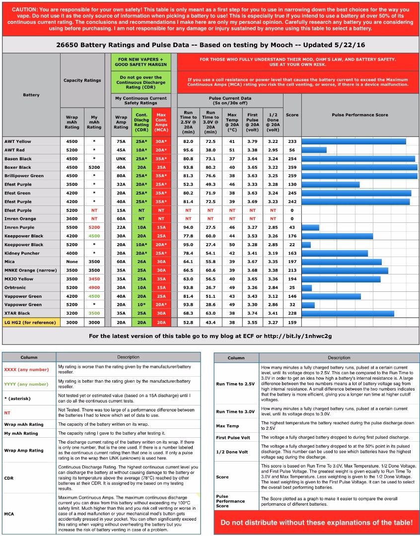

  1. Im using a brillpower n boxer 26650 mooch . Indicates.ther some of the best?n the boxer 75 w v2 is brand new....the connections look fine batteries are new too...
  2. But ther both dna i got the boxer v2s 75 n 250 chip .im new to the dna family n love thm ...im have a a weak battery with my 75 vapeing at 75w it gives me a weak battery msg?
  3. I have both the 250 an 74 watt .my ? Is y dose my 75 screen look brighter thn my 250 my 250 looks more blue?is ther something wrong with my 250 screen?
  4. I wnt off this chrt...
  5. Boxer US26650 40A IMR Li-ion .i havent plugged it in to Escribe yet my laptop is in the shop.geting fixed ?
