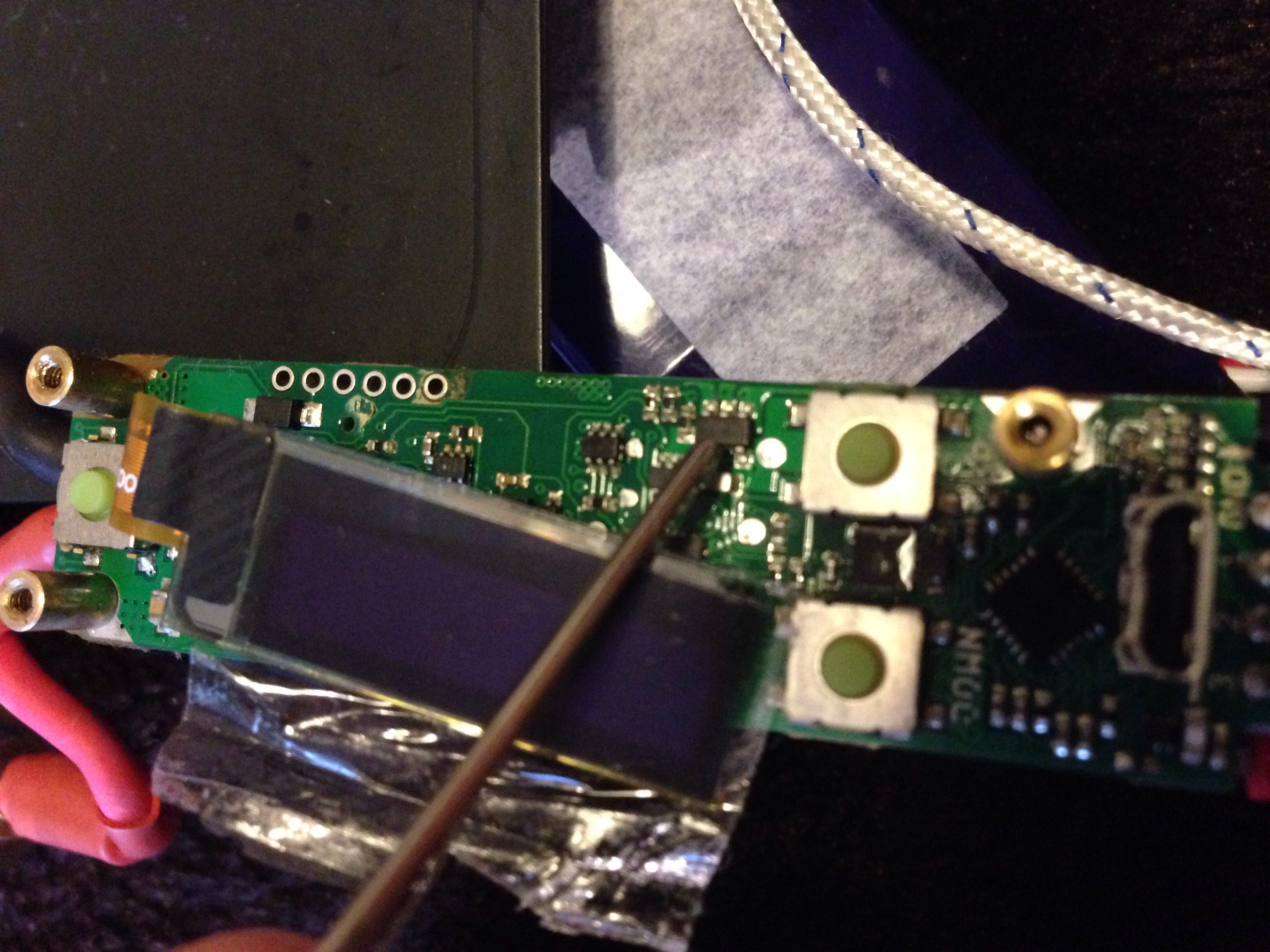

Hi I am an avid fan of the DNA 200 and own 3 home made mods and in the process of building a 4th. My first 2 builds are the 2 I use all the time and get plenty of stick and have run flawlessly. The 3rd has been a bit of a pig 1st fault was constant firing and "warranty service " message after loading a ti csv that had worked great on my other 2 mods. Stealthvape replaced the board without issue ( rob dam fine chap)
The replace ment board has had very little use but with a kanth coil it suddenly died with "warranty service " message
I sent a photo of the board to rob he pointed out that one of the large inductors looked slight raised in the photo
As I have a ir rework station and am used to reflows and bga work I decided to attempt to drop the chip back to where it should be
This was a success although the temps involved were higher than I like due to the thickness of the smc
All seemed well I tested the board out of the case and noticed a component getting hot even at idle (see photo for part that's getting hot)
It carries on getting hotter and hotter and the board goes dead the on/off button won't work but when plugged into USB it starts up and works but the heating issue starts all over again.
I think the initial lifting of the inductor was a symptom of what ever is causing the over heating.
I have checked the board for shorts
Any help or pointers greatly received
