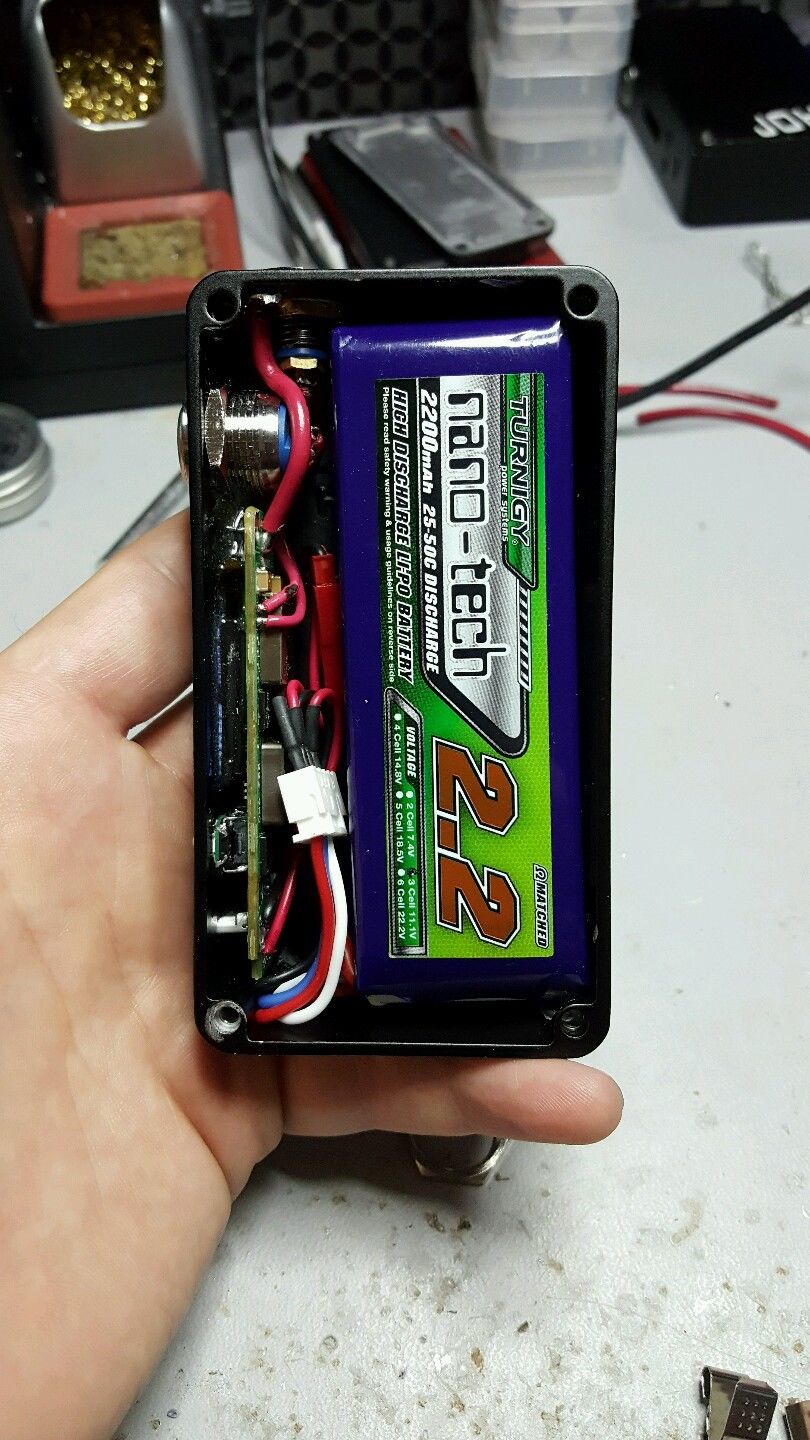

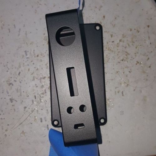

	Felt the urge to create something wild in a small G box. Messed around with these LiPos in my airplane so I had ordered an extra one. I CNC cut the lid of this Alpine Tech and rewired the LiPo for a smaller quick disconnect. Had an extra VaporShark Lying around so I ripped that apart and created a pretty slick monster mod for basic vaping around the house. Also retrofitted a 16MM button instead of the basic 12mm, blue is my fav. It also fits a 950 3S battery if anything were to ever happen to the Graphene Enjoy

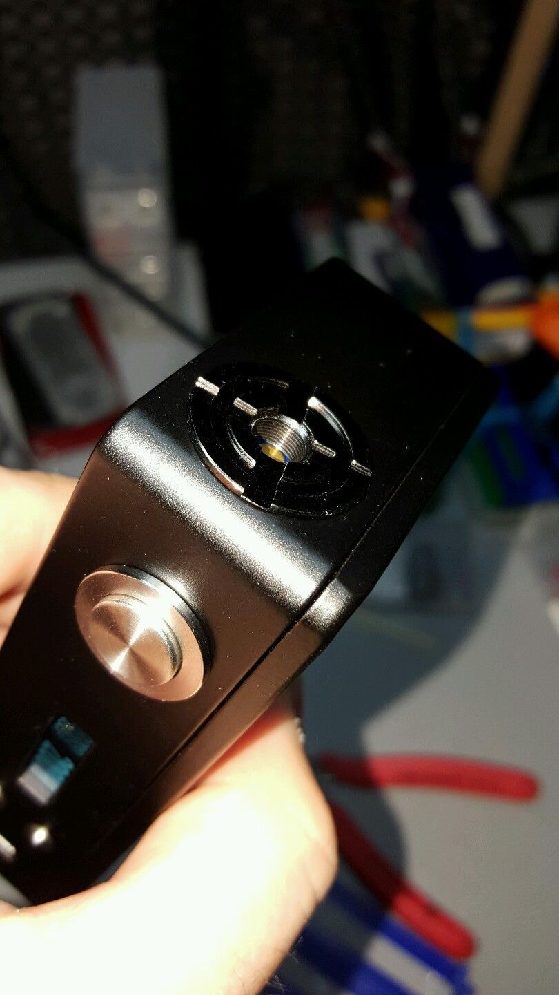

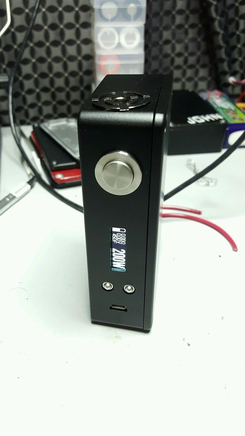

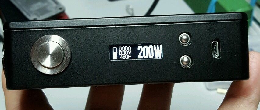

	DNA 200 in a Flat Black 20% Matt with 2200mAh LiPo with XT disconnects and extended Zip charging port. Finished off with a 510 v4 fatdaddy and a 16mm Orange Halo button. -XEVape
