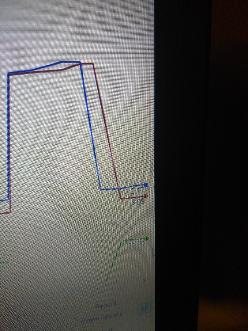

  8. The odd part is it shows firing at 31.70w but I have it set to 50w. Ohms are .144
  9. This is while fire button held. Cell 1 reading 3.10 cell 2 reading 3.17.

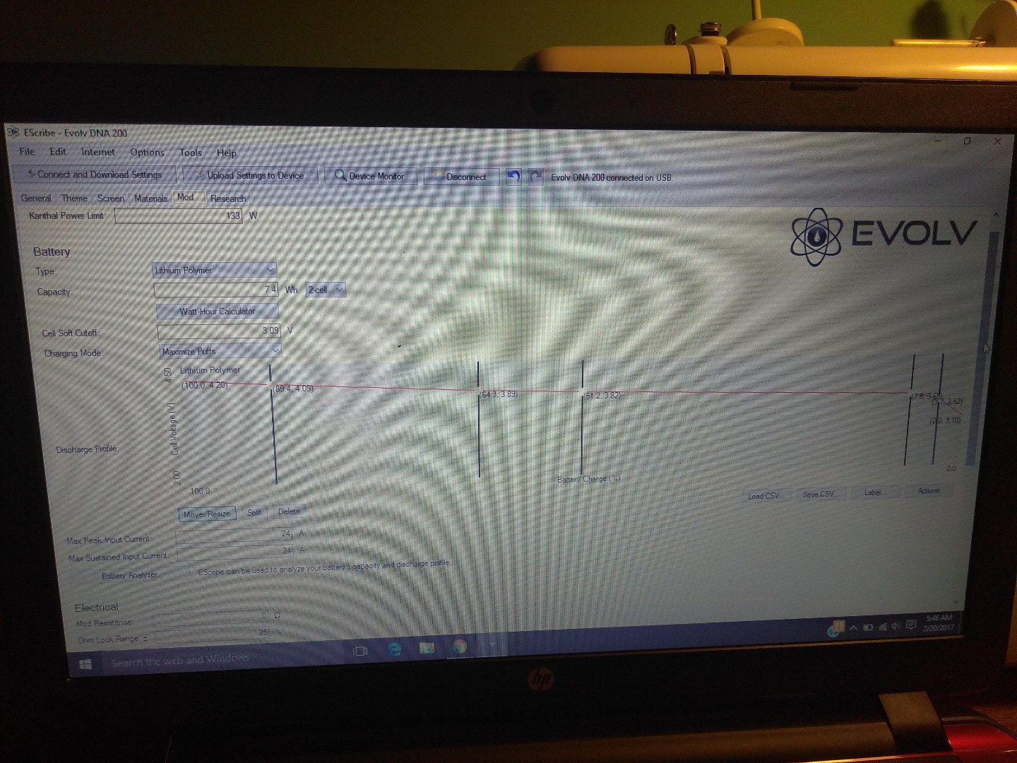

  11. These are my settings. Should the capacity be changed? I've tried everything I know but can't get it to work.

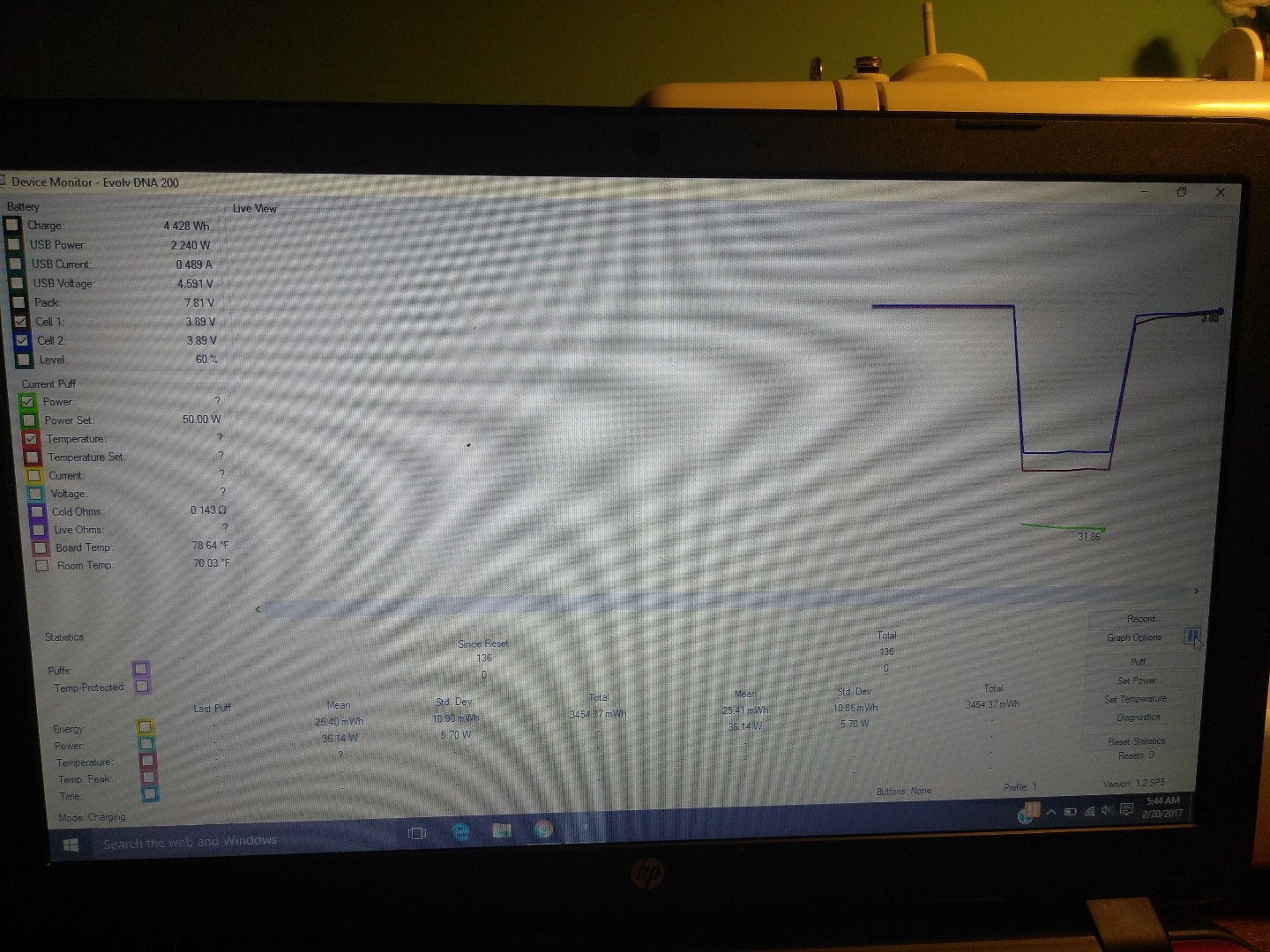

  12. Here is what mine did with a 5 second click of power button. And kanthal limit is set to 133.
  13. OK give me a sec and I'll get a pic of what mine does.
