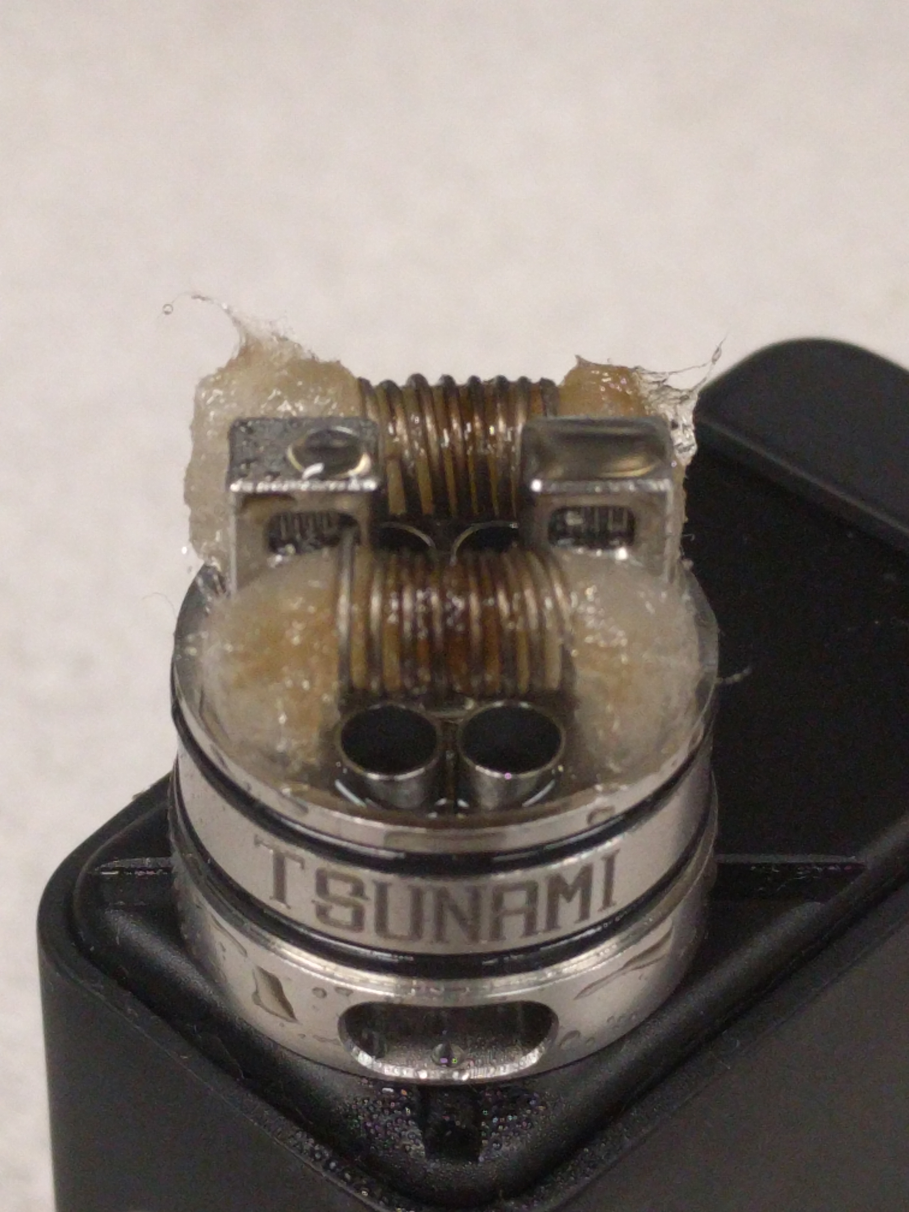

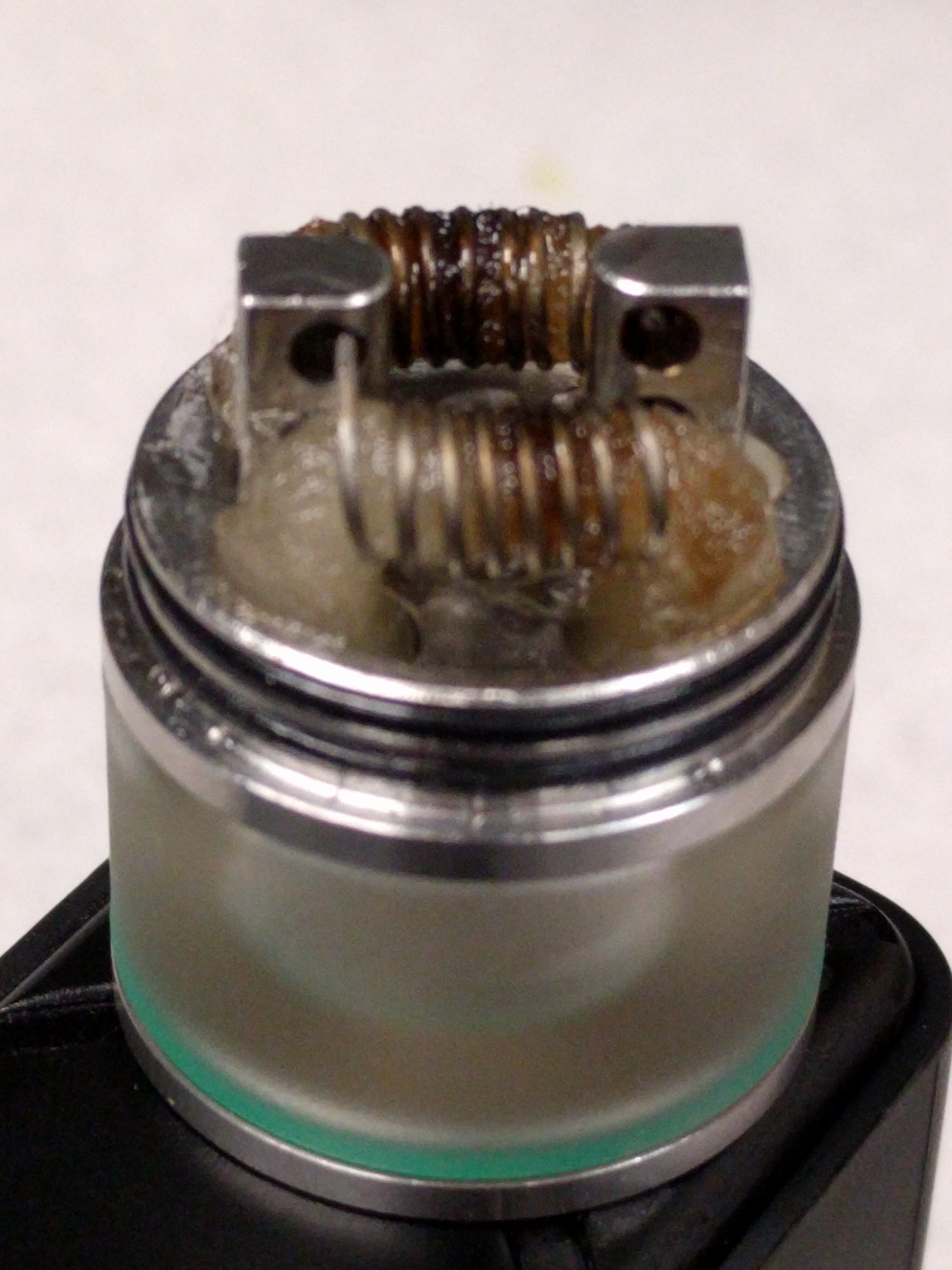

  5. I'm guessing this is similar or the same as the black char stuff that typically forms on the coils after a week or so? It had occurred to me this might be the case. I don't have access to a microscope but once it's built up to where to has in my pictures it has a very similar kind of lung irritation to burnt cotton. It doesn't even seem possible for it to be burning so it's probably not. It might as well be burns with the level of irritation it's causing though. Any ideas on how to minimize this? I'd be happy if my wicks would last a few days at least. Titanium contact coils have had such inconsistent performance I'd like to try everything I can to avoid them.

  8. I'm having trouble with my spaced ti coils. I can get contact coils to work well but I really prefer the flavor and performance of spaced coils. I've tried everything I can think of and haven't been able to find anyone else online with this particular issue. My coils are burning cotton despite everything being as perfect as I can make it. Strangely they don't burn at all when I test them dry, only changing color in excess of 470 or so. I left the temperature there and had a great vape for about 24 hours until it's burnt. This has happened with three different attys, I gave up thinking I wasn't dripping often enough or something. I got a Griffin tank and tried some spaced coils with the same result. I'll stop myself from writing a book about my frustrations with this stuff.. I usually run 50-60 watts at 450f-490f .10 to .16 ohms. ko gen cotton. Also tried rayon with the same results. My builds are solid, usually fluctuating .01 only in very cold temps this winter. I've tried the CSV included with escribe as well as from steam engine. Using 24g lightning vapes titanium 1. My coil ohms are accurate according to steam engine. I'm in the correct profile. Anyway I appreciate any suggestions I can try out. Here are some pictures of what it looks like after a day. My juice has no coloring added and is 90%vg.
