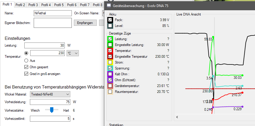

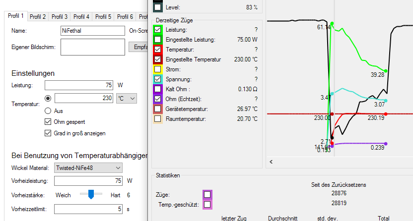

  1. thats an other prob i have with my dna. if i dont lock ohm and im vaping outside (its cold) the chip goes far too low with detected ohm value and i have to raise the temp up to 300°C (max) and it still not hot enough. normally i let it cool down at room temp check resistens and lock it.
  2. thx for explanation. with the right settings it works "nerarly" as expected but i still think that power drops to early. could get a bit closer to configured temp! in the srceens i use a dual nife48 coil 0.32mm 6 wraps 3mm 0.13Ohm but the preheat is more importent with claptons....
  3. Maybe thats the problem. 10F and 10C are not the same. If perheat stops at 10Celsius before temp its to low. I tryed with punch 11 but it still stops perheat to early.
  4. yes on 2. screen it looks like preheat is working. but why does it stop after a second if it doesnt reach the configured temp? the wattage falls down at 200°C instead of 230°C ?!?!
  5. it is celsius 230°C more than enough
  6. ok. here are 3 screens with 10w 30w and 75w... at 30w it looks like a "little" preheat. but its far away from configured 5sec. ! and it doenst reach the configured 230°C before it falls down...
  7. no.no....i set this only for testing. atm i use 50w 230° ignoring that the preheat is not working ... it's ok. but i like to know why preheat not work. ps: i will post a devicemonitor screen when i'm @ home
