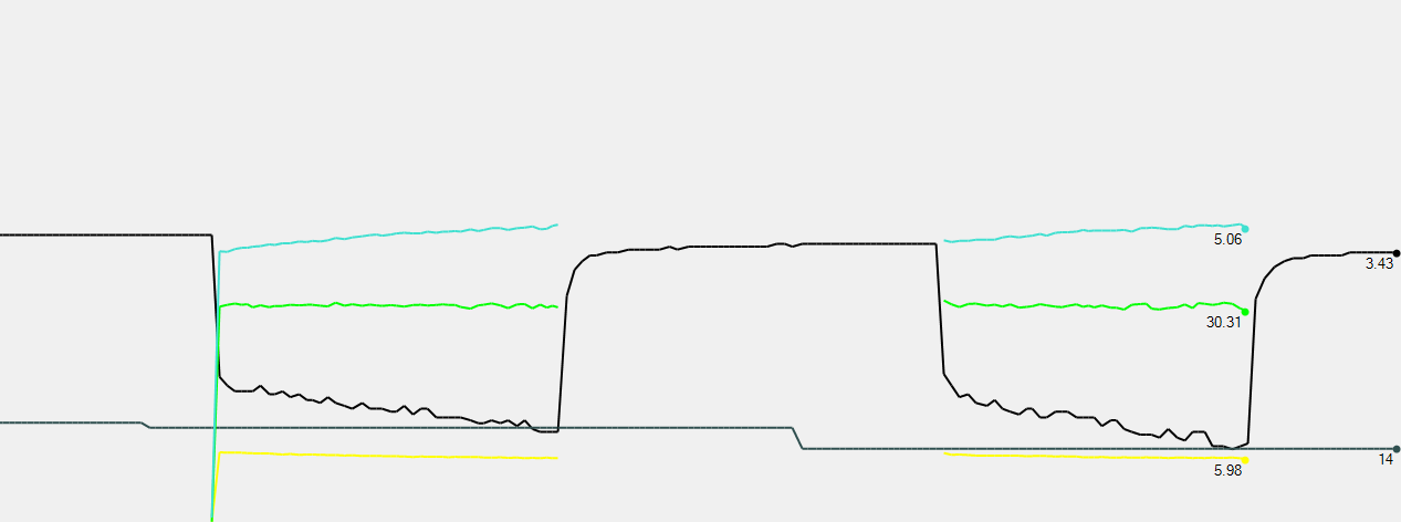

  9. Ok, could be almost no delay, for what I noticed it,s very short maybe 1 sec or just bit a shorter, as my mech fires instantly, the VT75 has a bit of a delay. I made the screenshots, after use of the battery-analyser, cause I just received 2 IJOY 26650 batts, I was using ss316L/24 gauge reading 0.7ohm by 40 watts for the, battery-analyser. So I test fired, like you asked, as far as I know this was in power-mode, no preheat set and did not use temp-mode or locked the res.
  10. Thanks for your reply ! I made some, screenshots while firing, I hope that they are for use.
