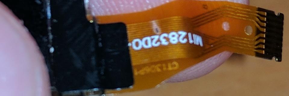

  1. So I wrapped some tape round the exposed metal on the ribbon cable in case it was just shorting and not actually broken (and to add some strength to the cable if its bending too much). Appears to have fixed the screen disconnects: My post originally was meant to be about the erroneous count number (jumping from around 50 to 120) though, not the fact I was getting disconnects.

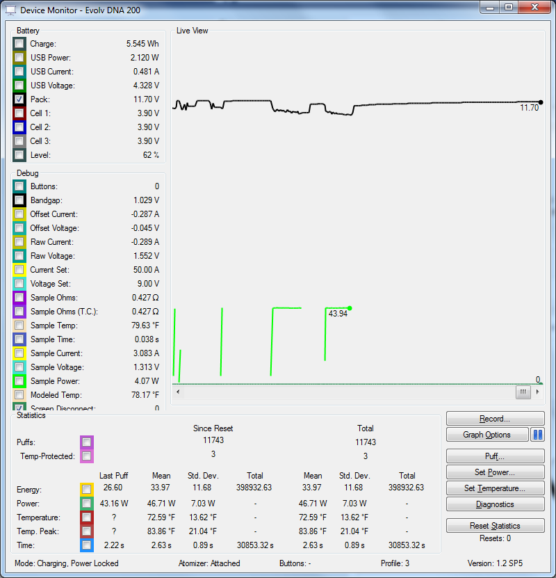

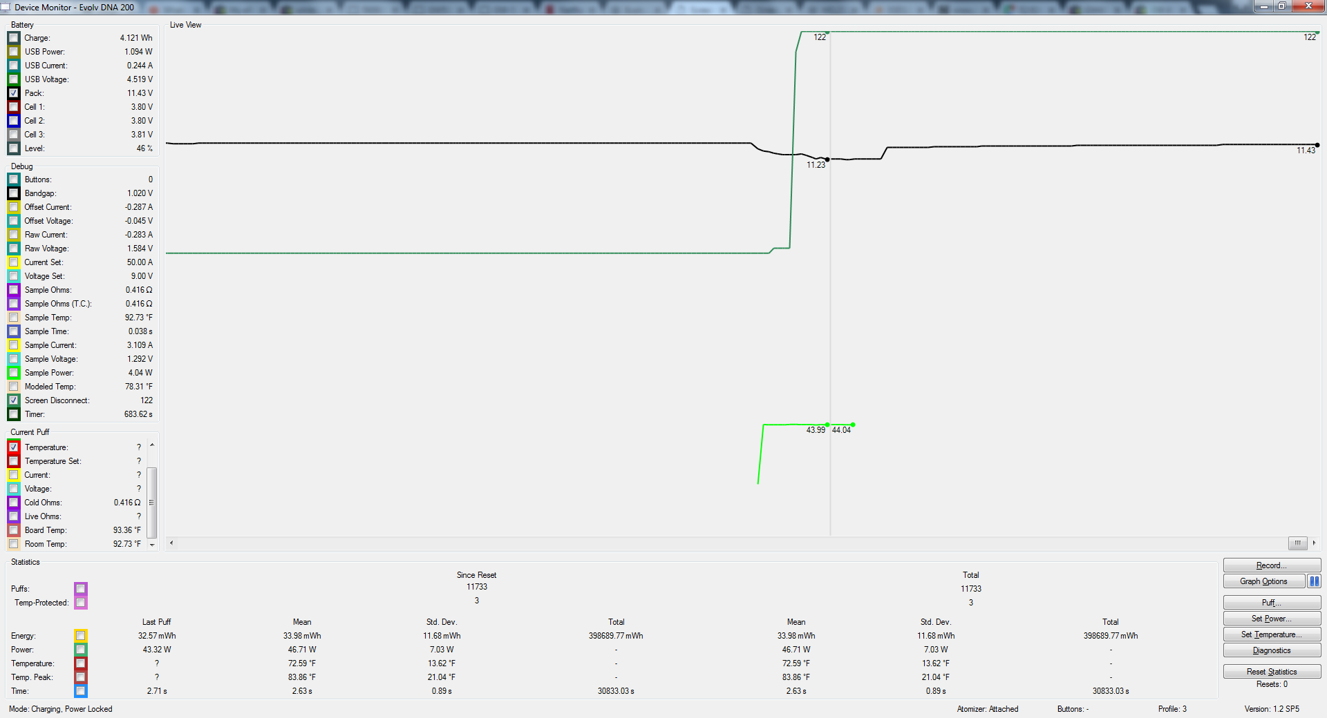

  4. Hi, I think my screen cable is on the way out (noticed that the screen wasn't updating properly) so found the extra debug menu, and thought I would check the disconnects. While taking a puff it jumped from 54 to 122 just thought I would point it out. Also is there anything I can do when installing the new screen to protect it from getting killed by the firebutton again? Cheers
