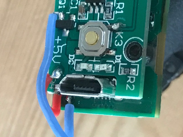

Hey guys, So ChunckyButt200 had it right at post #29, the wire was soldered to the wrong pin, since I'm no expert, it took me a few tries but I finally got it right ! Thank you big time for the support ! See you around.

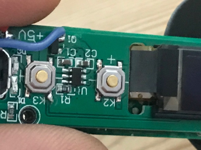

Hey, So I managed, asking around in my favorite vape shop, to take a peek inside a working C1D2 (if it ever existed ) and I took a picture ChunkyButt200, tell what you think before I start heating up the soldering iron... so here's mine and here's my the (working) one I got my hands on, they're a slight difference at the C1-C2 area... If this changes what you thought I should do, let me know ! Thanks a lot.
Hey, i'll try that ! what you're saying makes sense ! it was connected to the up +, and needs to be connected to the down +, I'm recieving a soldering iron in tomorow or the next day... I'll keep you posted !
I guess you're right ! it really isn't my area of expertise... If I could see how a "functionning" C1D2 Vapedroid is wired inside I might solve this issue ! Thanks for the update thought, I'll try and contact VapeDroid for more info.
Hey, so I took off the black wire (even if I shouldn't have!!!) and the change is that the left button is inactive now ! the button on the right hand side still works properly.. here are more detailed pictures; Any thoughts ?

I think the Dna board is underneath the one you see, cause there a 2 boards on my set up I can see the "up" written on one side and "down" on the other side just like it shows on the dna picture. Also, when i connect to evolv website via escribe, I have no issue, I don't think it's a clone issue...just a wiring one. cutting the black wire ? are you sure ???? thanks !!!!!!
hey, so i took the board off... and it looks like this it appears the #6 has nowhere to connect to... Can someone tell me why there's only one wire on this side ? the black wire is connected on #5 (up +) ? Is it normal there's no wire on #4 (down +) ? Somebody help !!!! what's wrong with this setup ? Thanks !
