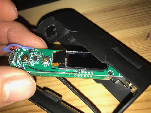

Hey, So I managed, asking around in my favorite vape shop, to take a peek inside a working C1D2 (if it ever existed ) and I took a picture ChunkyButt200, tell what you think before I start heating up the soldering iron... so here's mine and here's my the (working) one I got my hands on, they're a slight difference at the C1-C2 area... If this changes what you thought I should do, let me know ! Thanks a lot.

I guess you're right ! it really isn't my area of expertise... If I could see how a "functionning" C1D2 Vapedroid is wired inside I might solve this issue ! Thanks for the update thought, I'll try and contact VapeDroid for more info.

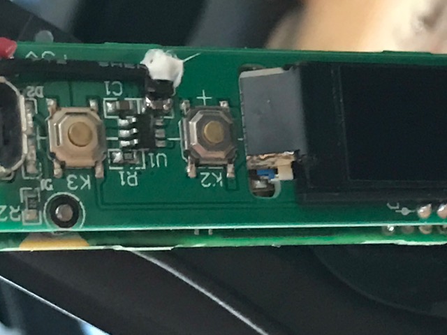

Hey, so I took off the black wire (even if I shouldn't have!!!) and the change is that the left button is inactive now ! the button on the right hand side still works properly.. here are more detailed pictures; Any thoughts ?
i'm a little sceptical on cutting the wire...no offense ! i'll wait and see if someone opens up its VapeDroid to see what the wiring should be !!! thanks !
I think the Dna board is underneath the one you see, cause there a 2 boards on my set up I can see the "up" written on one side and "down" on the other side just like it shows on the dna picture. Also, when i connect to evolv website via escribe, I have no issue, I don't think it's a clone issue...just a wiring one. cutting the black wire ? are you sure ???? thanks !!!!!!

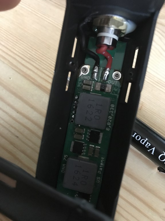

hey, so i took the board off... and it looks like this it appears the #6 has nowhere to connect to... Can someone tell me why there's only one wire on this side ? the black wire is connected on #5 (up +) ? Is it normal there's no wire on #4 (down +) ? Somebody help !!!! what's wrong with this setup ? Thanks !

Now my biggest concern is how to get the board out since the wires are on the other sides !
I' no expert ! Like i said ealier i think i have to unscrew (if i find the right tool) the 3 torx screws at gnd and then check the wiring !
