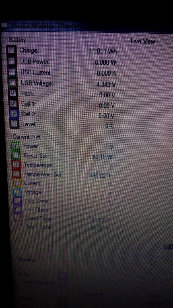

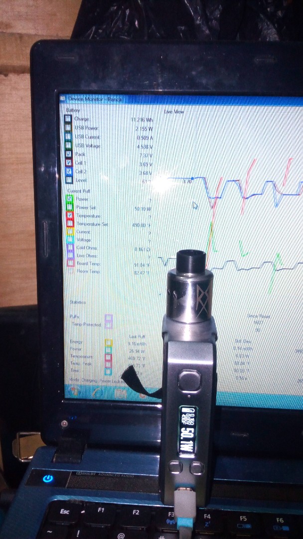

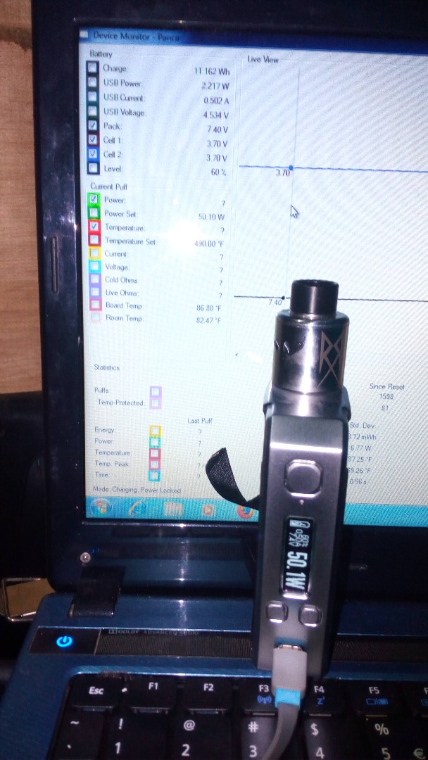

  2. Im use lg hg2 and vtc 5, and have same problem, tonight im open my theri, and i test a wire with multitester , all is good, no burning part component, im contact lostavape repair centre about 2 day ago and dont get answer btw , they evolv will accept my board to repair or replace ? Cos if i want vape i must pull out the cell and put it on again All is normal if i pull out cell and put in again, but abnormal if standby mord than 1 hour, batree cell all monitoring on escribe , display show charging, ampere and volt, all is normal i can vape Does evolv can help to rma/ replace my therion board ? Cos when i look device information the board program on october 15, 2016

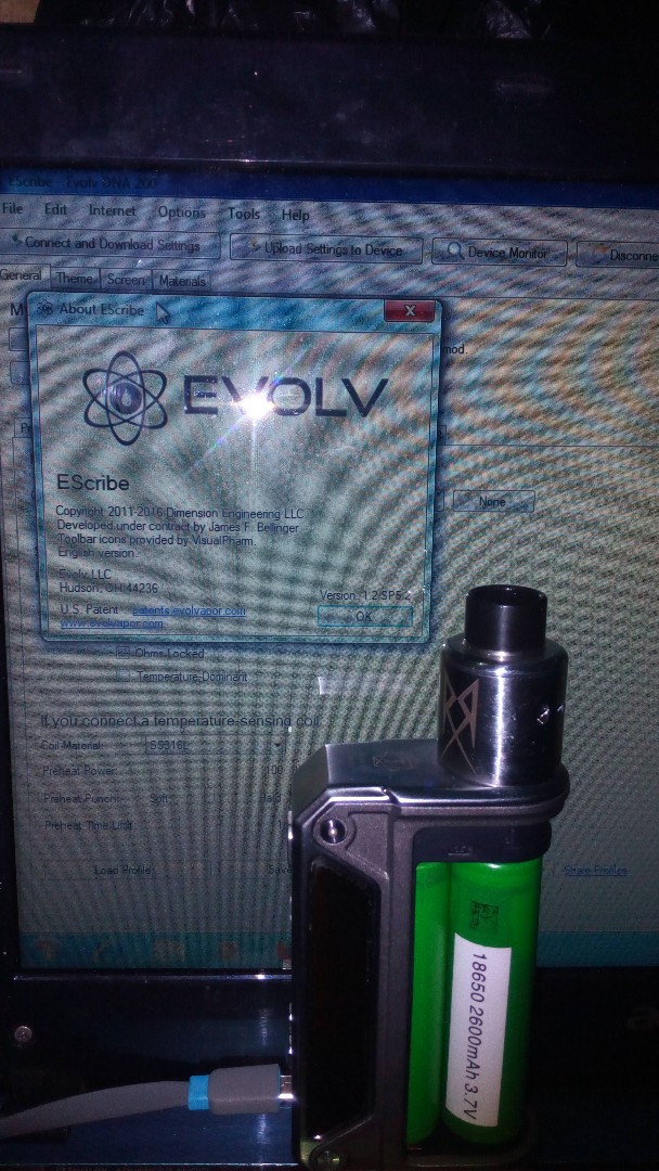

  3. Im use sony vtc5 on it, and if standbye mode more than 1 hour is 0 all in the display, even at escribe I have 2 firmwire, 1 is copy from other therion 133 ( normal ) 2 is im using now But still same if i use other therion 133 firmwire

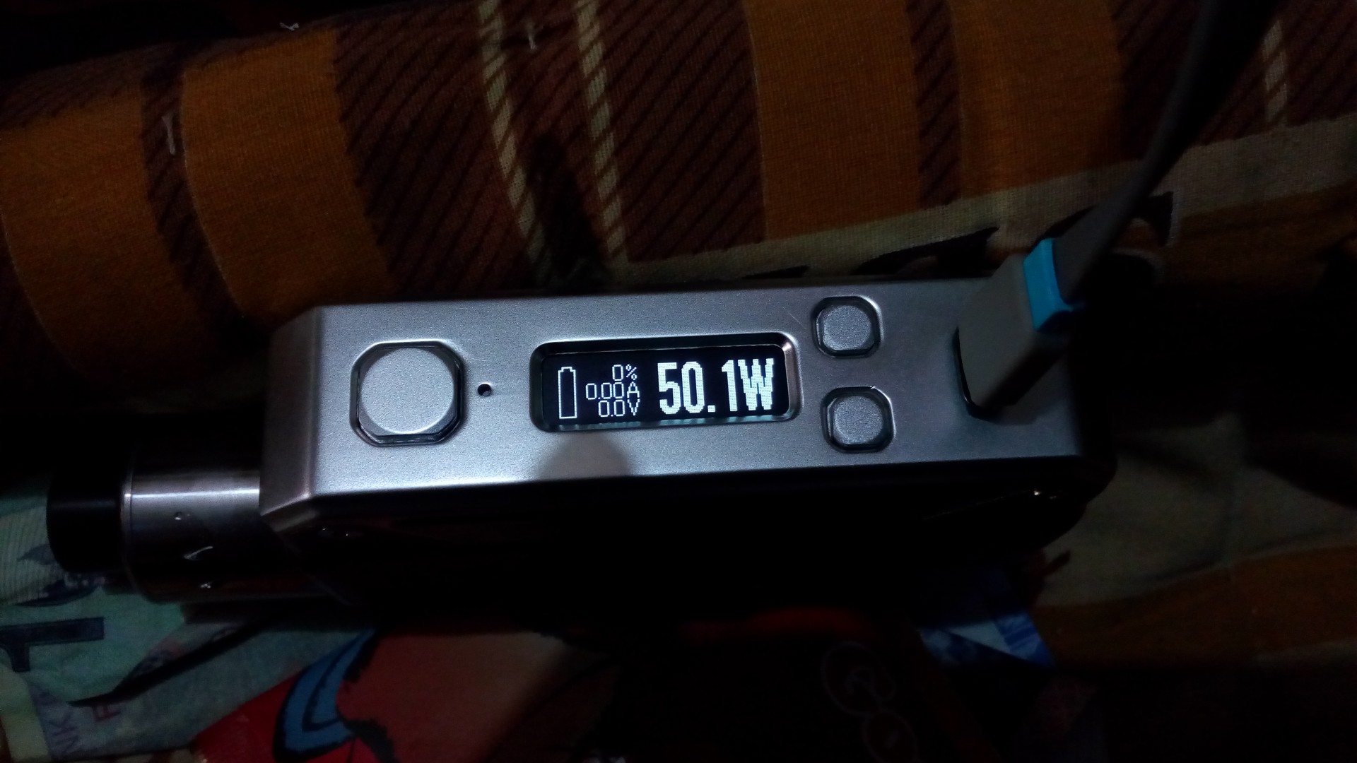

  5. I have therion 133, and when standby about 1 hour, display show " shorted" when im push firing button, when im plug charging , its not show charging, i must pull out the lg hg2, but when i put again that batree all is normal charging, and i can vape normally, but abnormal again if standby more than 1 hour, how can i do ? Im from Indonesia
