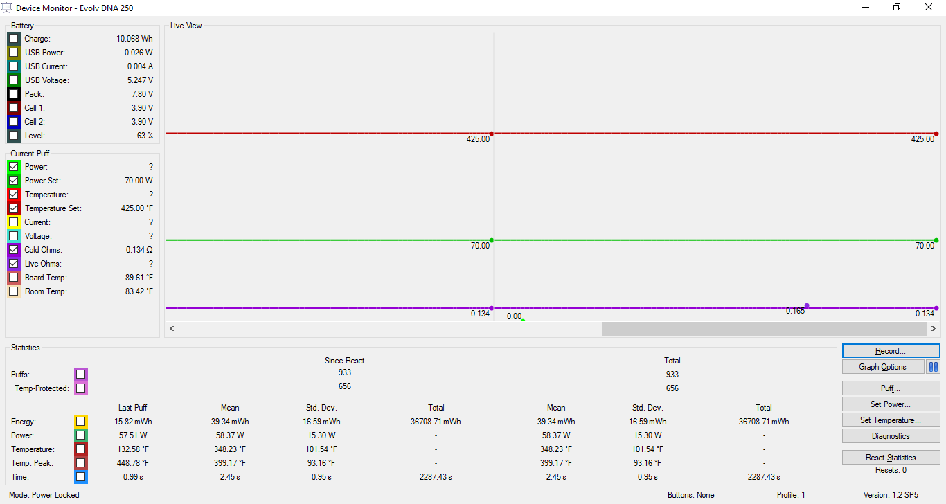

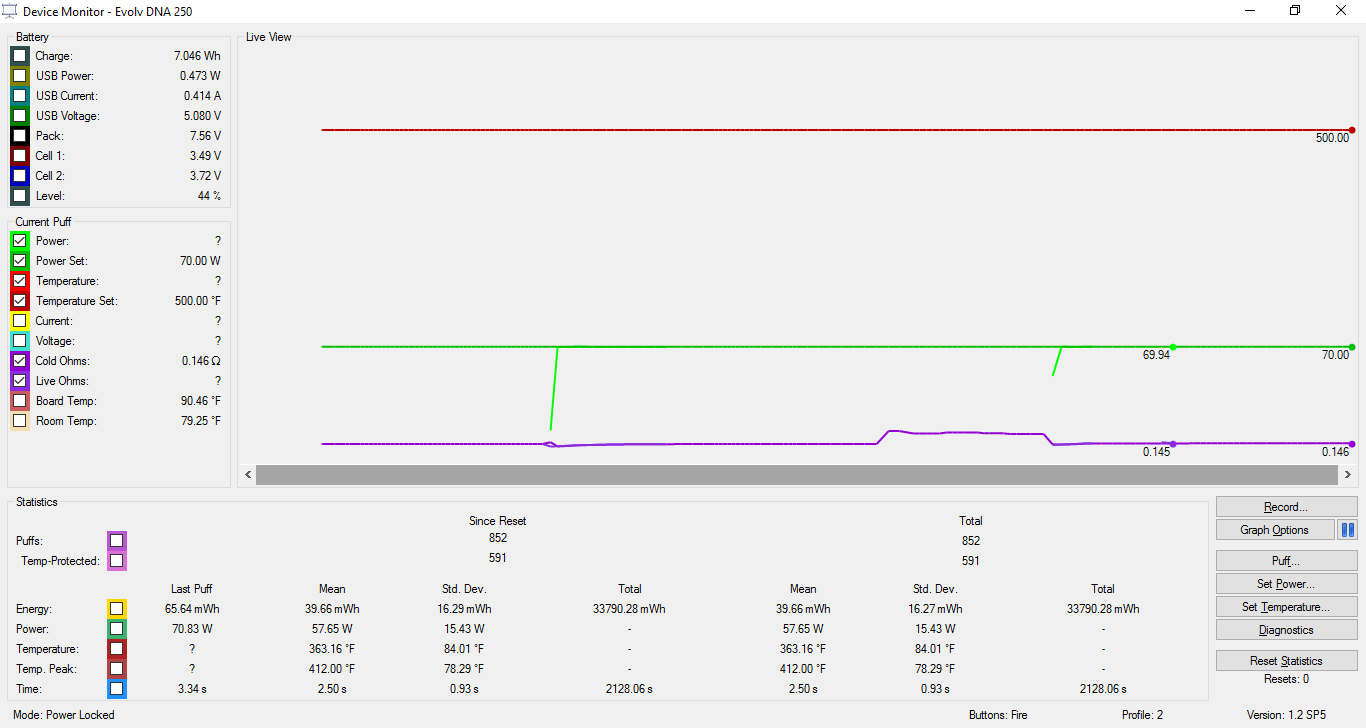

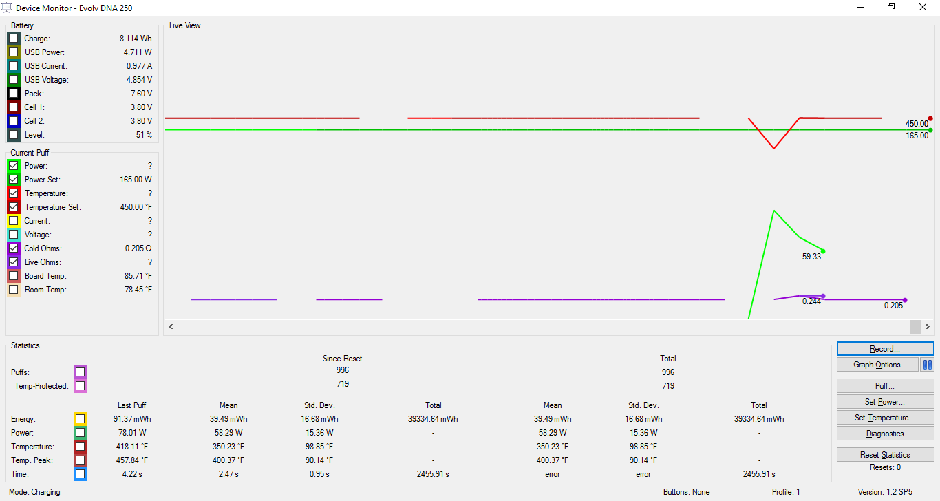

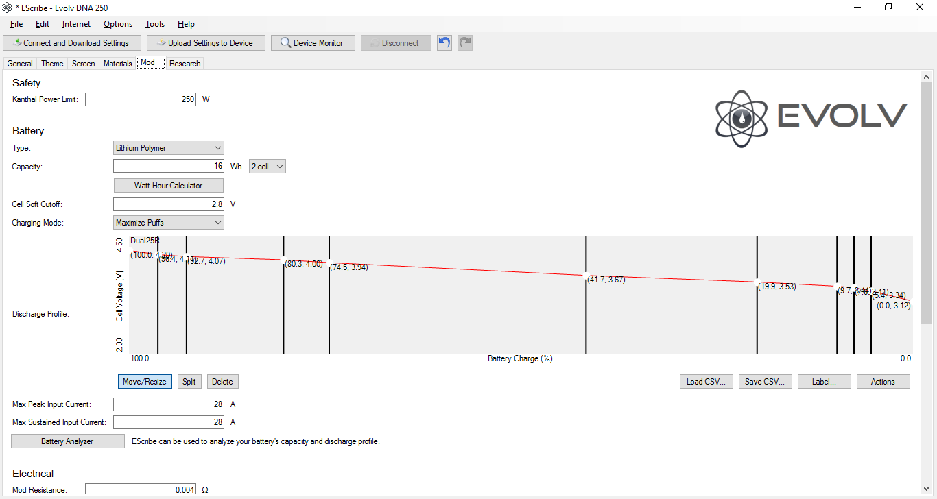

  5. well I spoke too soon just hit it a few more times and its doing it again. here is a screen shot of the device monitor. Im starting to think its my avocado 24 thats causing this problem. I threw on my fuji gta, hopefully its just that rdta.

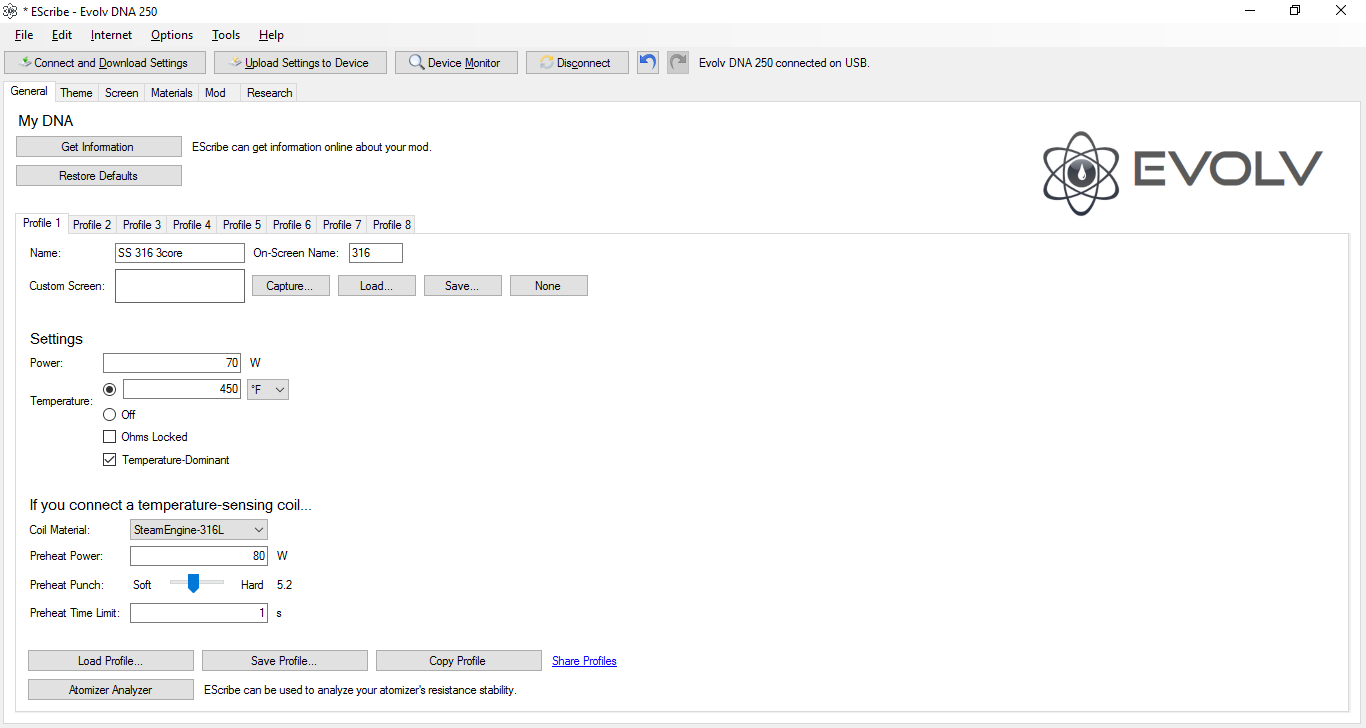

  11. Yes I did upload it to the device. It normally does show my current temp when at max temp, it is only when the device gets "stuck" at max wattage and i press the fire button does it show temp protection.

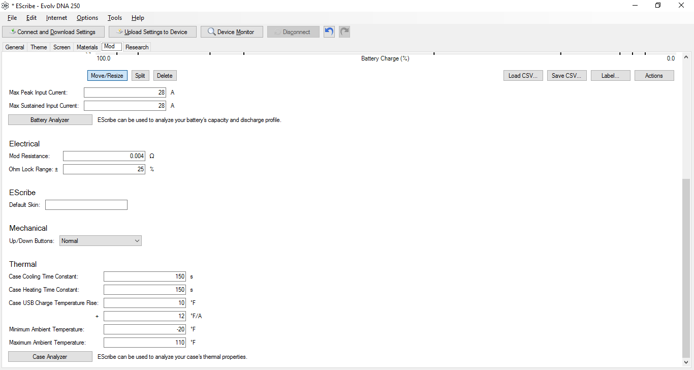

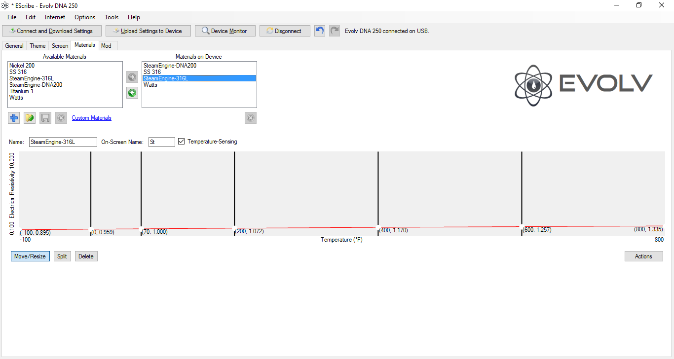

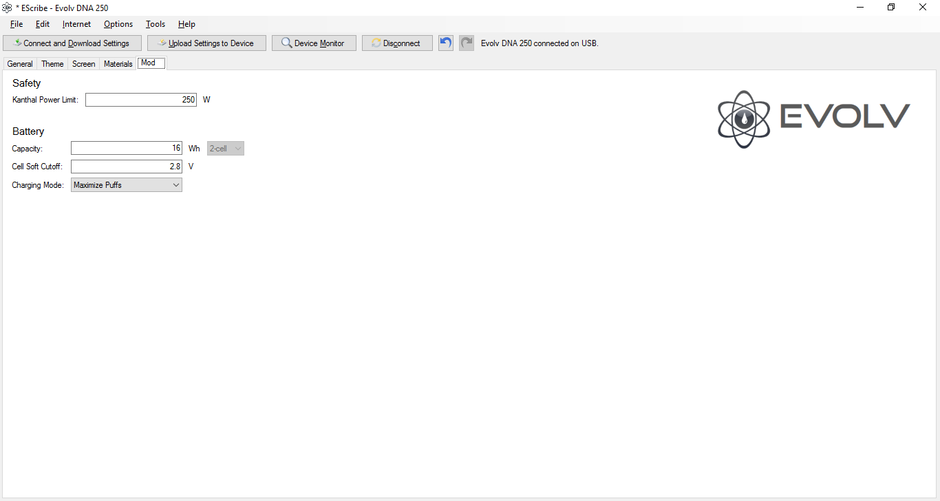

  13. thanks for the reply. yes i did change temp protection to show temp in the setting thats why im not sure why its still showing that message. here are the screen shots you requested. I havent gotten around to setting anything for the battery. do you happen to know what i should set it as? i am using nothing but hg2 sets in this device.
