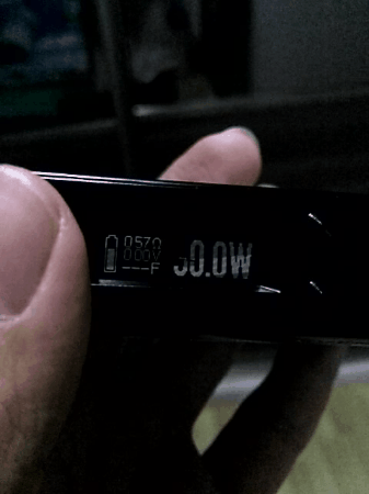

  5. i tried it . it still showing 3cell @ 1.10v and fire inconsistent voltage
  6. oh sorry! thought you meant the monitor of the mod.
  7. im using an OBS crius plus. here a gif file of the monitor when im firing it. when i switch to another atty , its does the same thing. and also i rewrapped both of my LG hg2 once
