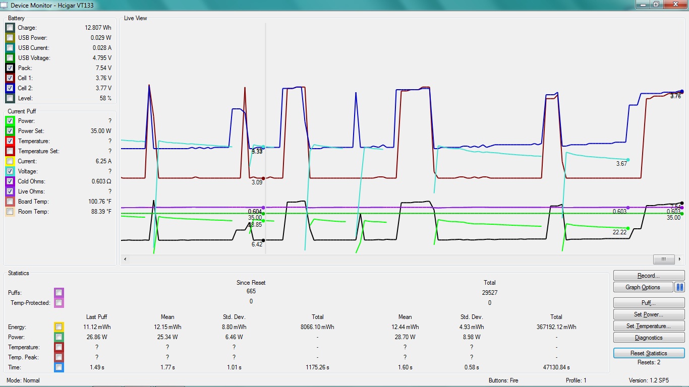

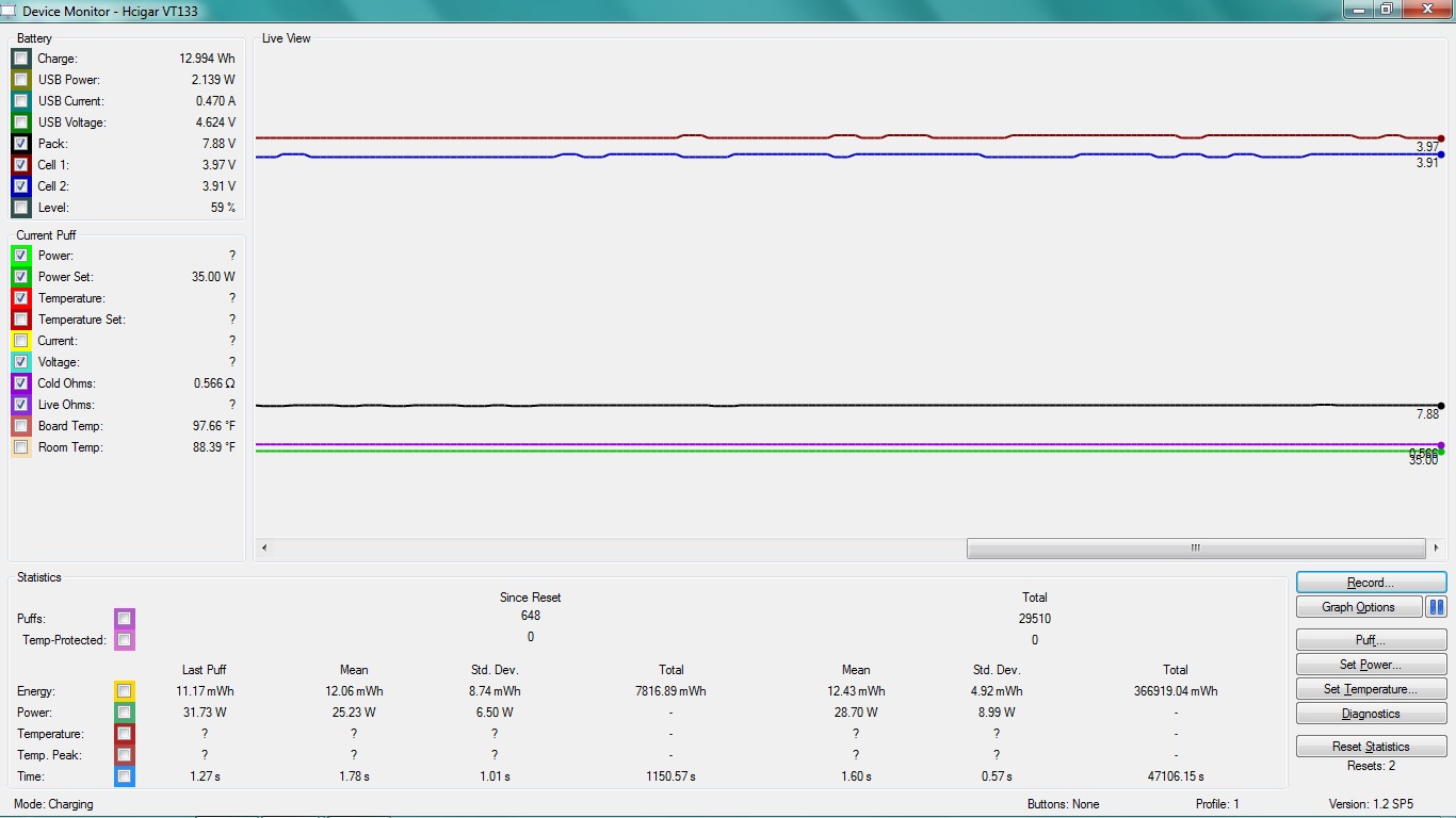

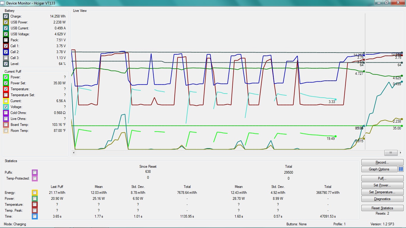

  1. i asked my friend if i could test out his batteries out on my mod and its working correctly. i will indeed buy a fresh set of batteries. thanks alot for solving my issue! appreciate it alot
  2. thanks very much for patience and your help ! i might have damage the battery due to over heating the battery with the wrap. I'll purchase a new set of battery for it.
  3. ok got it
  4. ok got it. i updated escribe to 1.2 SP5
  5. i tried it . it still showing 3cell @ 1.10v and fire inconsistent voltage
  6. oh sorry! thought you meant the monitor of the mod.
  7. im using an OBS crius plus. here a gif file of the monitor when im firing it. when i switch to another atty , its does the same thing. and also i rewrapped both of my LG hg2 once
