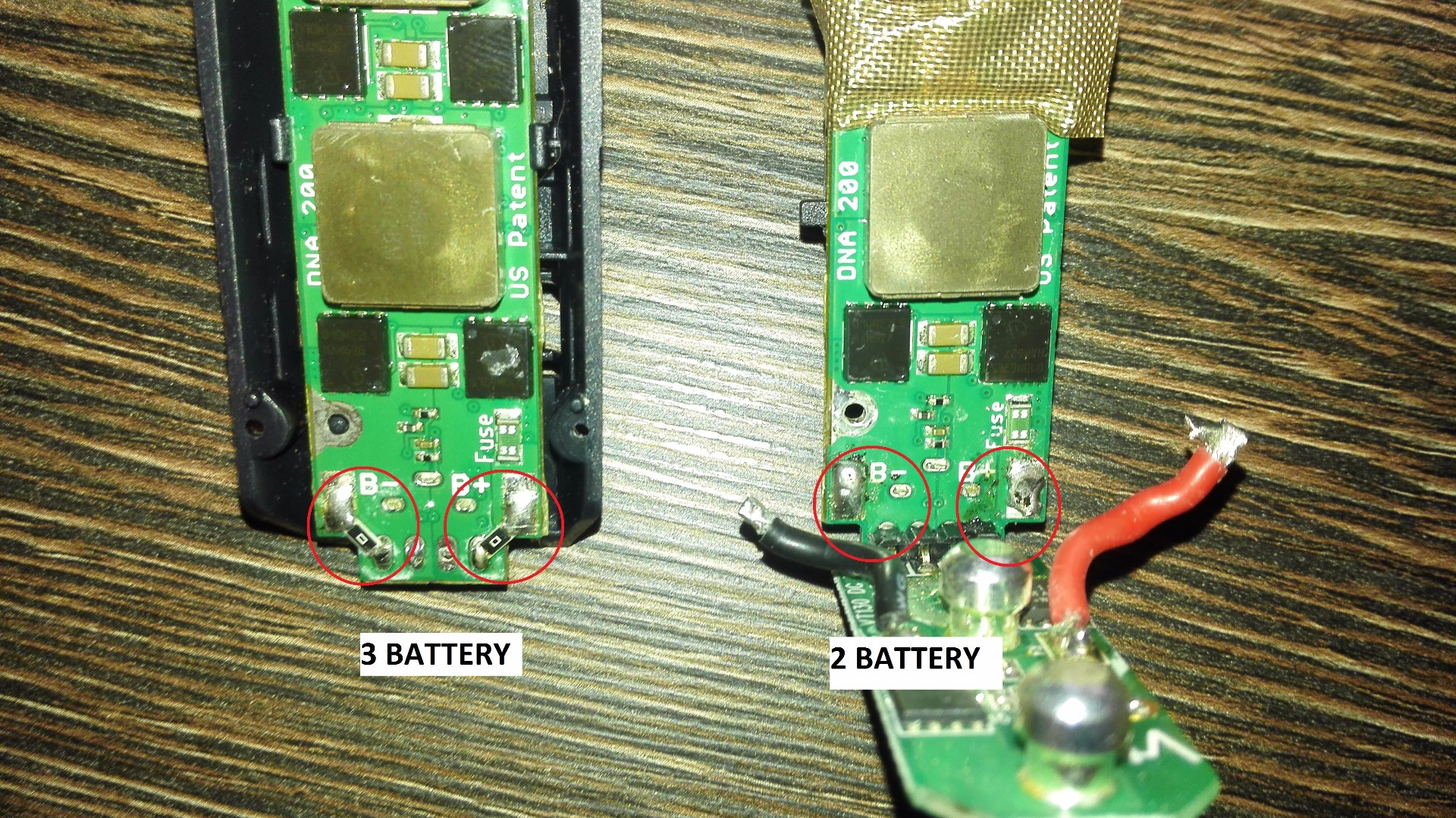

  2. ChunkyButt200, thanks a lot for your reply. So, my 3 cell board was from the Triade DNA200. To disconnect the board I had to desolder 4 wires going from battery box to 3; 2; 1 and GND. When I will be placing back the new board (form a 2 cell mod, HCigar 133) i plan to solder back the same wires from the battery box to the same 3; 2; 1 and GND in the same position. And also I will add 2 0ohm resistors to B- and B+. Will this work? Not quite understood about bridging Cell 2 and Cell 3. Should this be done in a battery box on on the board itself? Or it should not be done if I'm just swapping the boards taken away from mods? What does the S2 Capable Board means? And one more... cells 2 and 3 were not bridged on my BOARD of Triade DNA 200. Not quite sure what I'm doing
  3. Good day, everybody. Would like to ask for your help a bit. I have 2 DNA200 mods, one is 2x 18650 and the second is 3x 18650. I want to switch the board from 2x battery mod to 3x battery mod. I understand how to connect the 4 wires going from the battery wiring but the question is about should i also add 2 jumpers going to B- and B+ (from 3 battery mod to 2 battery mod if I want 2 battery mod to become a 3 battery). Shown on the picture in red circles. Thank you.

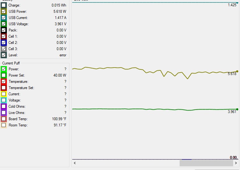

  7. Having the exact, exact, exact same issue with my brand new Triade. Only 2 puffs were made. Changed all the wirings to copper. Checked the fuse with multimeter - working. Any suggestions? I'm just wondering if it is a Chip or outside chip wirings/connections.
